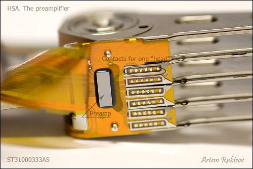

The preamp is located on a flexcable going from pcb connector to the HSA (head stack).
A new pcb with swap of the U12 should do it...if not, preamp is gone and a new head stack is needed.

The thing is i couldnt see any sign of a chip when zooming on the HSA, might just be the HDD enclosure that is causing to much interference tho...

Here is a picture from a Seagate taken by Artem.

oooh, if its that small i wont be able to see it in the xray with the enclosure...

Nope, unless you know where it's located :D
