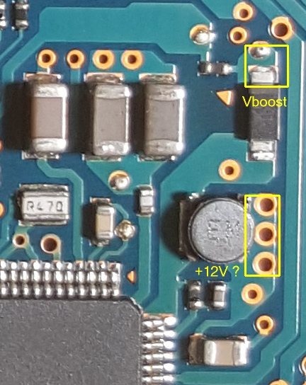

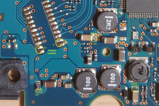

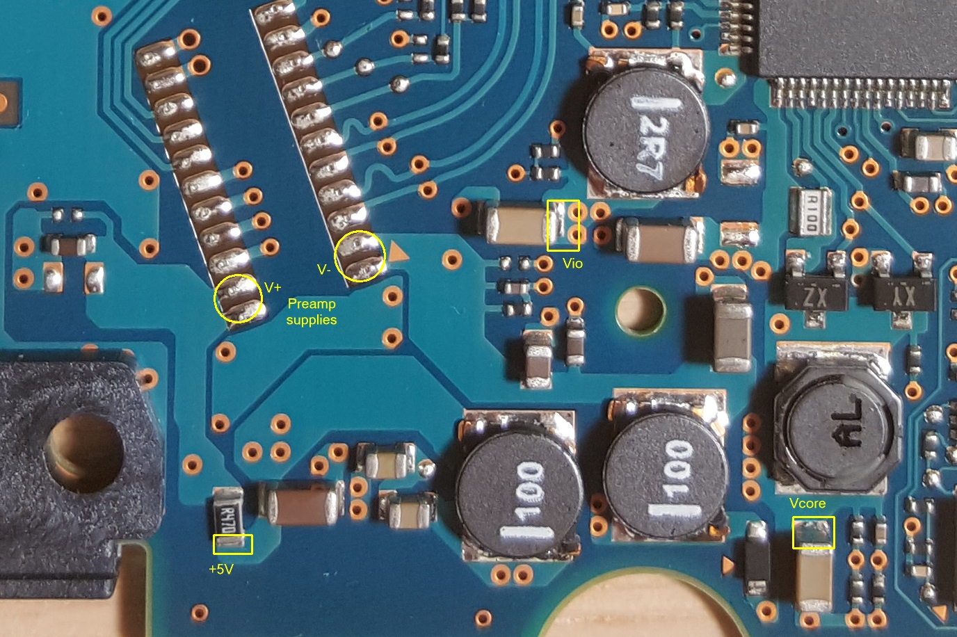

Measure these voltage test points.

So that would be a total of 7 voltage measurements; +5V, V_core, V_io, V+, V-, V_boost, +12V. Can I use the same ground reference point for all 7 measurements, e.g. one of the screw holes?
And all 7 measurements should be made with the PCB loose from the HDD, while providing power to the PCB e.g. through a confirmed good SATA-USB bridge?

* Bad PCB:
+5V : keeps rapidly circulating between voltages in approx. the 0.1V .. 1.0V range.
V+ : keeps rapidly circulating between voltages in approx. the 0.1V .. 1.0V range.
V- : -0.00V
V_io : -0.00V
V_core : -0.00V
+12V : keeps rapidly circulating between voltages in approx. the 0.2V .. 1.2V range.
V_boost : keeps rapidly circulating between voltages in approx. the 0.5V .. 2.5V range.
* Good PCB:
+5V : 5.07V
V+ : 5.07V
V- : -2.992V
V_io : 1.803V
V_core : 0.938V
+12V : 12.25V
V_boost : 12.18V
 Post subject: Re: Dead Hitachi HUA723020ALA641 2TB 3.5" 7200rpm (Jun-2012)
PostPosted: September 13th, 2023, 16:59
Posts: 17230
It looks like the 5V fuse may be open. :-?
What voltage do you measure at the 5V TVS diode?
BTW, the boost voltage is low because it is switched off when the HDD is not running.

If you are concerned about preamp damage, locate the V+ and V- test points on the other side of the PCB and measure the resistance to ground with the PCB mounted on the drive.
Testing for a damaged preamp:
http://www.hddoracle.com/viewtopic.php?p=23821#p23821
