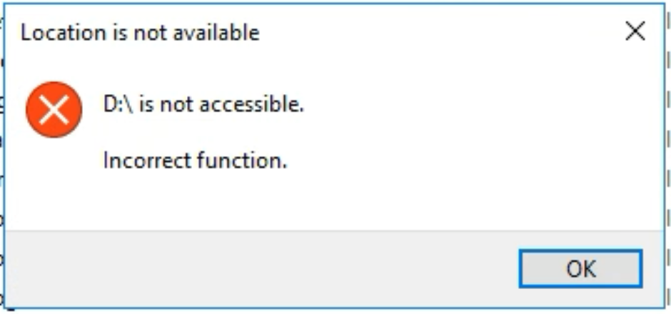

Have a huge 8TB Volume that's been working flawlessly for 6 years, all of a sudden not accessible with "incorrect function" on Windows Server 2016 PERC H700 controller RAID 5 for that volume. The problem is I have critical data on that volume that for some reason IS NOT backed up (95% of the volume is but the data I need was "missed") so I need to be able to "fix" this "incorrect function" error and get my volume back. The system says the volume is healthy (DISKPART), but thins the volume is RAW but it's actually NTFS of course. My option to reformat the volume and restore data is not an option. I've rescanned the disks. I've done a chkdsk in readonly. I've restarted.
Of course, this is urgent! Any good advice to help get this volume back will be greatly appreciated!

Also my event log says: An error was detected on device \Device\Harddisk1\DR1 during a paging operation.
I wonder if one of the physical disks in the RAID 5 is busted. I have to try to go onsite and look at the physcial server to see (yes I know who uses physical servers anymore!).

Since we know nothing about the component disks' health, it is hard to advise in this situation.
As a first step you can power down the drives and look at raid controller logs
If you want to prepare for a worst case scenario, find a pro in your area with proper tools and expertise.
If you want to take the risk of loosing it you may try cloning the individual drives to known good ones, rebuild the raid in sw from the clones and try recovering the folder structure.
