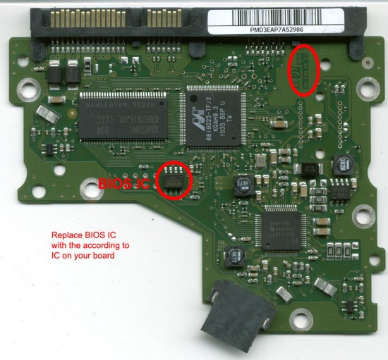

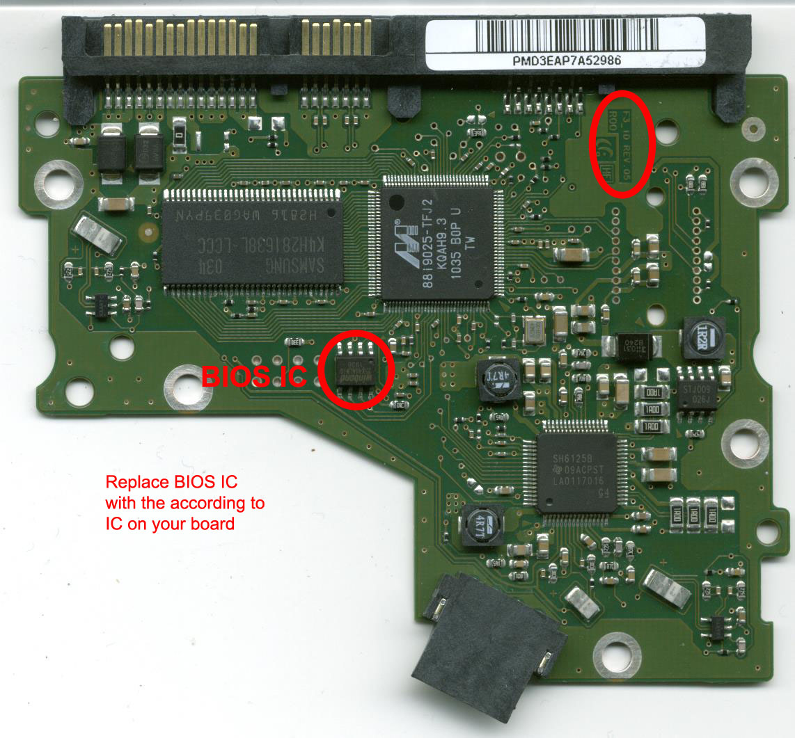

Hi guys! I´m into the task of getting my mom´s files back from a death HDD. This drive is a Samsung HD502HJ with a PCB version BF41-00352A (on the back, on the front it says F3_1D rev. 05). I have a donor HDD, same model, same PCB numbers in the back and front BUT, they have different electronic components soldered on them. The situatuion is like in this pictures. The damaged one has those in the bottom right and also on the left of the memory chip. I have seen this in other PCB revisions of this model (Rev 01 for example). The question is.... The donor PCB (which works fine) will work in the damaged disk (I´m sure the issue is in the PCB) having these differences despite being exact same PCB model? I plan to do the BIOS IC swap. I know that doing this with a good PCB should work, provided is the same PCB model, but I couldn´t find info about these same PCB models that are not really the same. Also, what does these components do? Seems something optional, at least, I hope so. Thanks!

Those extra components are shock sensors and operational amplifiers. I haven't yet heard of any case where a difference in this area has resulted in an incompatibility issue.
It's a Seagate drive, and it's a different sensor, but here is a case where the firmware update for the AS (no G-sensor) and ASG (G-sensor) versions of a particular model are byte-for-byte identical.
https://web.archive.org/web/20230731131249/http://www.users.on.net/~fzabkar/Dell_AS_ASG_FW.jpg
Therefore, I expect that the firmware would be able to autodetect the presence of these sensors and make appropriate adjustments.
I could be wrong, though.

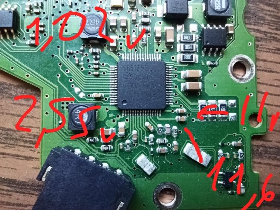

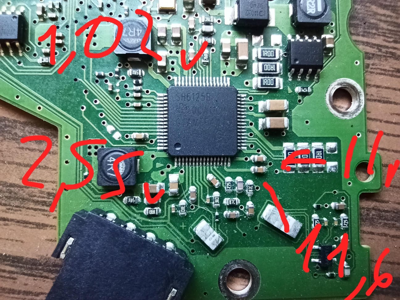

I took notes on the picture while I was measuring, so, to be clear:
north 4R7 coil measurement points: 1,02 V
south 4R7: 2,55 V
Bottom right capacitors of the MCU ( meassured to the right of both): top 11 V (should be 18 V right?)
bottom 11,6 V (should be 12 V no?)
The anode of the diode adjacent to the 2R2 coil: 0,2V (should be -5 V?)

I think 18V may not be present until the motor is spinning. The -5V supply probably needs to be switched on by the MCU.
I believe this is one of those models that may be affected by FIPS errors in the ROM. This will result in a no-spin symptom.
You can use a USB-TTL serial adaptor to capture the diagnostic messages from the UART port.
How to connect a terminal adaptor on a Samsung drive ?
https://www.hddoracle.com/viewtopic.php?f=116&t=189
