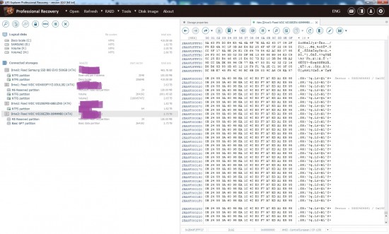

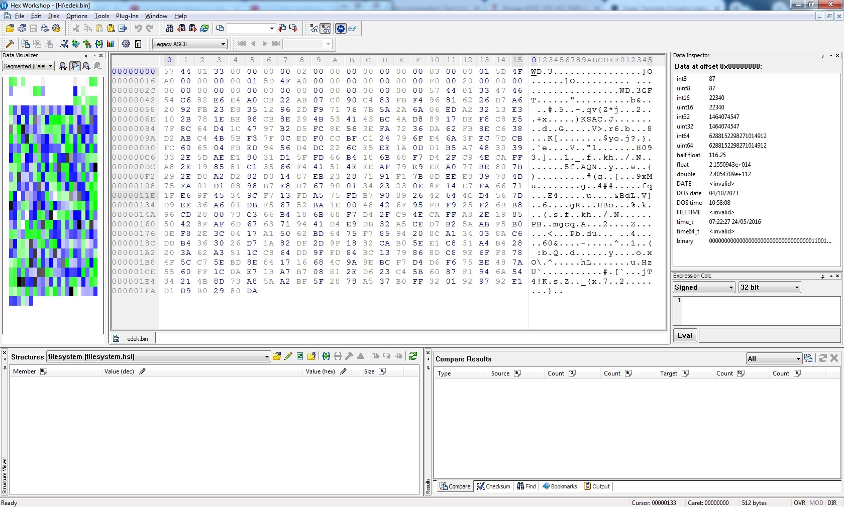

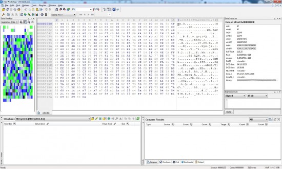

I received this WD30EZRX-00MMMB0 drive without the enclosure.
MRT can't decrypt it !!
I found the edek at 5860528136 LBA, the same edek is also present on mod 25... but it's strange.
It does not start with WD (57 44 01 14) but starts with WD 3 (57 44 01 33) bytes.
Is it possible to decrypt it without the controller?
Have you ever seen such type of edek, can you confirm that is Initio INIC-1607E encryption?

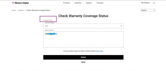

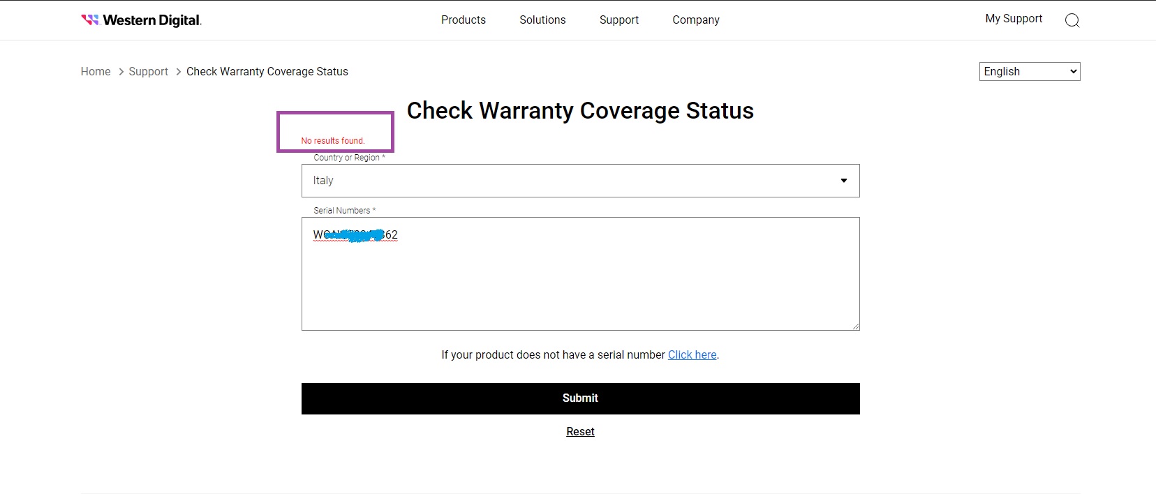

If you don't know the product, you can enter the drive's serial number into WD's warranty checker.
https://support-en.wd.com/app/warrantystatusweb
 Post subject: Re: MRT can't decrypt WD. EDEK starts with 57 44 01 33
PostPosted: December 10th, 2023, 13:44
Posts: 1754
Location: Verona, Italy
No result !

It looks like the OP partitioned and formatted the drive outside the enclosure. It might just be a red herring, though.
PostPosted: December 10th, 2023, 20:03
Posts: 1754
Thank you,
those sector i've already seen, but i still don't understand why mrt seem to not like this edek.
Mrt hangs while trying to calculate decryption, usually it decrypts right away.
Something must be wrong in that edek, never seen one which begins with 57 44 01 33 but i've seen few which started with 57 44 01 14 and mrt was able to decrypt them.
Maybe some particular encryption?

Do you have an example of a "WD" 0x01 0x14 key sector?
PostPosted: December 11th, 2023, 2:53
Posts: 17230
This document describes the key sectors and the decryption process:
https://www.datarecoveryperth.net.au/blog/wdencrypt.pdf
This is an Initio key sector:
00000000 57 44 01 14 00 00 00 00 00 00 00 00 00 00 00 00 |WD..............|
00000010 00 00 00 00 1d 07 68 00 00 00 00 00 1d 07 68 00 |......h.......h.|
00000020 00 00 00 00 00 14 e0 00 20 00 00 00 00 00 00 00 |......à. .......|
00000030 00 00 00 00 00 00 00 00 00 00 00 00 57 44 01 14 |............WD..|
00000040 32 92 ed 81 13 26 9e 98 df 1b a4 87 ef c6 37 3c |2.í..&..ß.¤.ïÆ7<|
The structure is similar to yours. The LBA parameters are in the same place and are big-endian. In this case the drive is a 250GB model -- 0x1d076800 sectors.

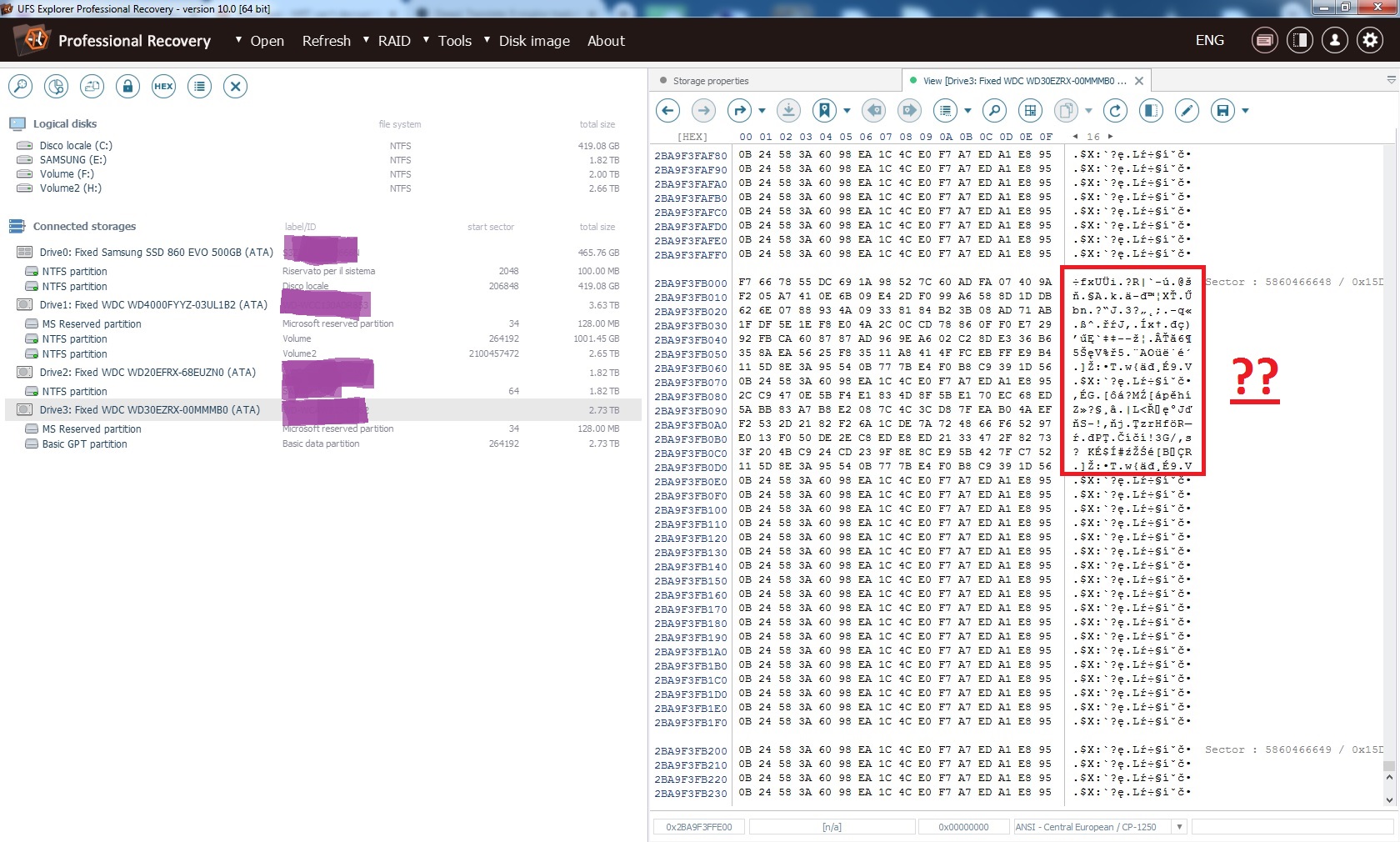

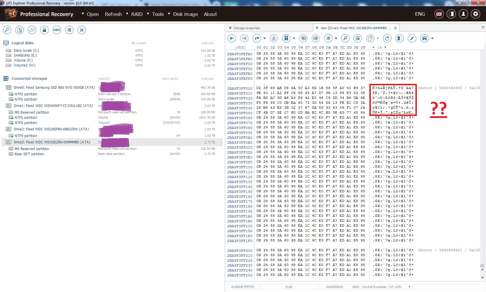

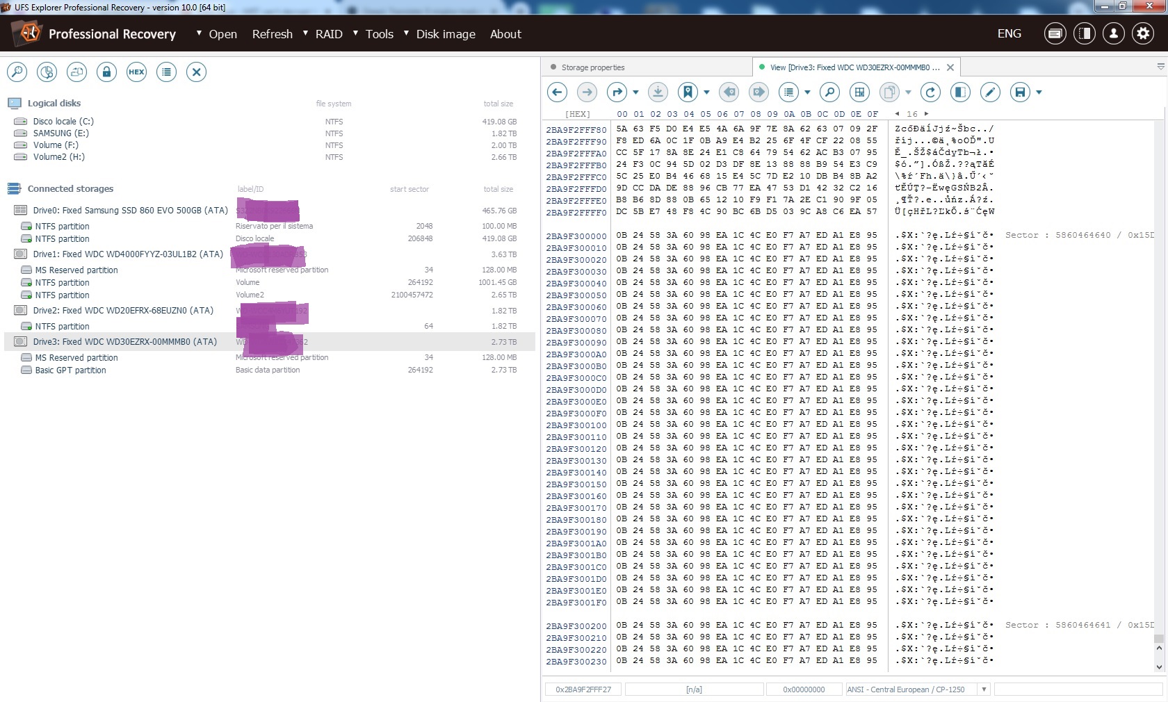

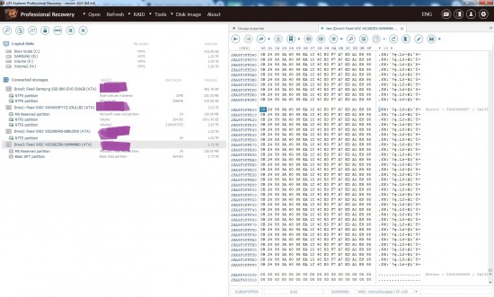

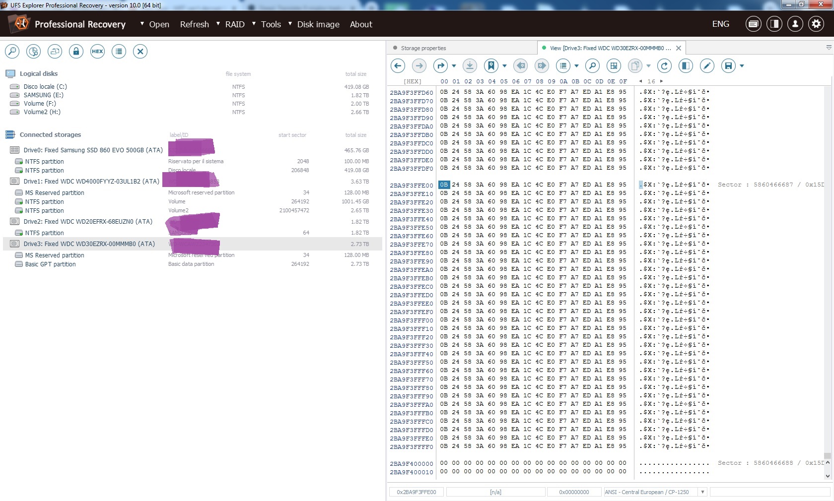

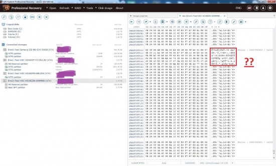

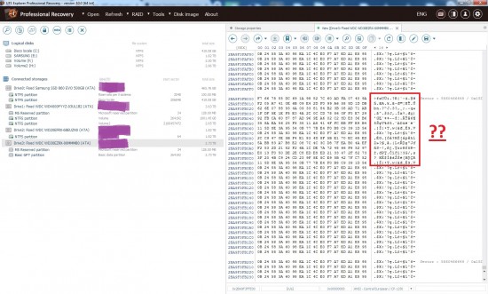

Sectors behind LBA 5860466687 should be all zero (between 5860464640 - 5860466687).
They're all encrypted with same bytes exept 2 sectors (LBA 5860466648 & LBA 5860466680) where only some bytes are different .
PostPosted: December 13th, 2023, 15:08
Posts: 17230
LBA 5860466680 is the encrypted "EFI PART" sector. This would be a copy of LBA 1.
LBA 5860466648 is the first encrypted GPT partition table sector. This would be a copy of LBA 2.
Perhaps you could create a dummy bin file consisting of a single encrypted physical sector and ask a friend with PC3K to decrypt it for you?
    encrypted_zeros_sector + LBA 5860466680 + LBA 5860466648 + 5 x encrypted_zeros_sectors
Alternatively, you might like to post the key and dummy sector to the reallymine web site (if it is still active).
https://github.com/andlabs/reallymine/issues
