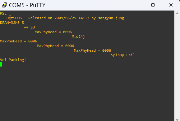

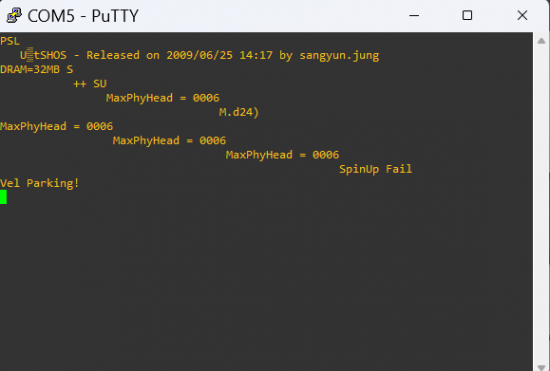

@Spildit
this is my own drive, im trying to learning somthing
terminal show me this
does this mean motor problems ?

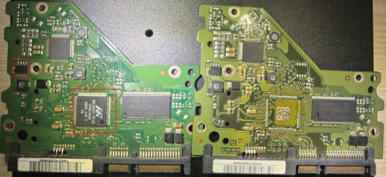

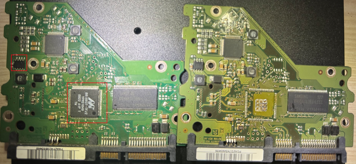

Okay, after a brief break, I'm back on topic.
Unfortunately, the drive has stopped responding in the meantime.
The Maxtor chip has been moved to a new PCB, but to no avail. Both the Maxtor and the PMIC are still shorted. Is there anything else I can do about this?
 Post subject: Re: SAMSUNG HD103UJ 1TB
PostPosted: September 30th, 2025, 5:21
Joined: September 13th, 2023, 5:53
Posts: 90
Okay, I've read a bit more about it and learned about the hot swap method.
However, I'm having trouble finding a donor. The only SAMSUNG HD103UJ drives I can find have the 88i8826E-BAN2 controller (mine is the 88i8827-TFJ2).
I also found an HD103SJ drive, which has the 88i9025-TFJ2 controller. I understand that won't work and I should look for something perfectly matched ??
