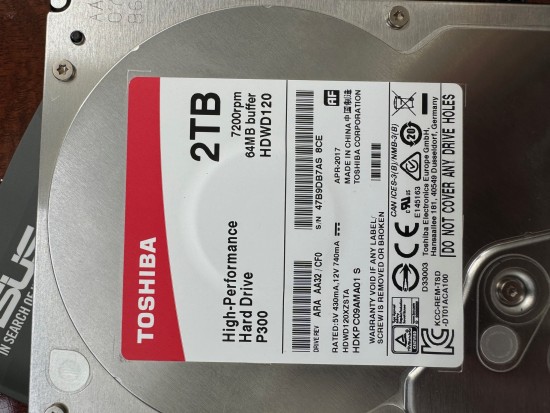

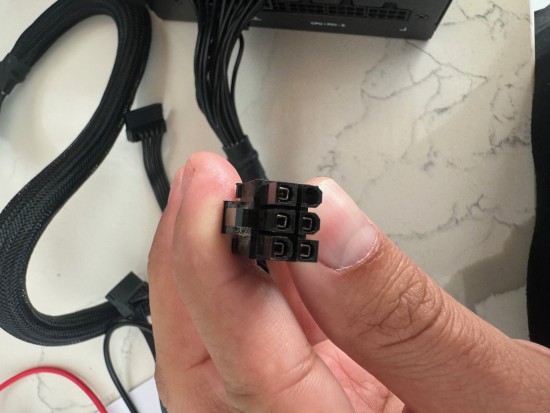

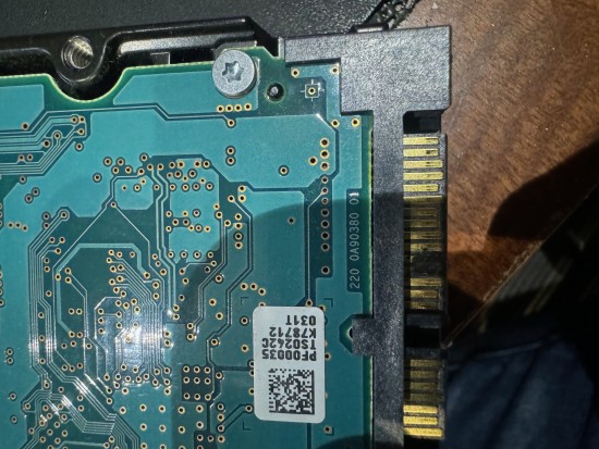

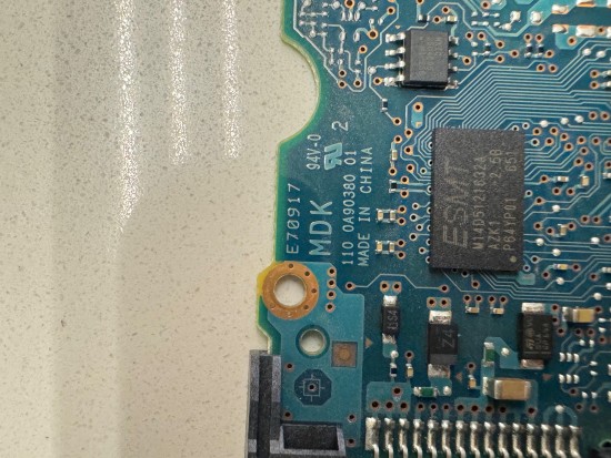

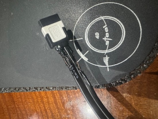

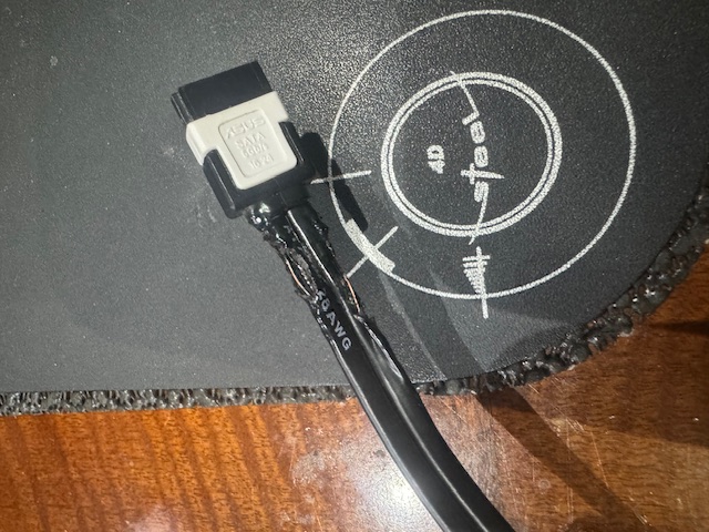

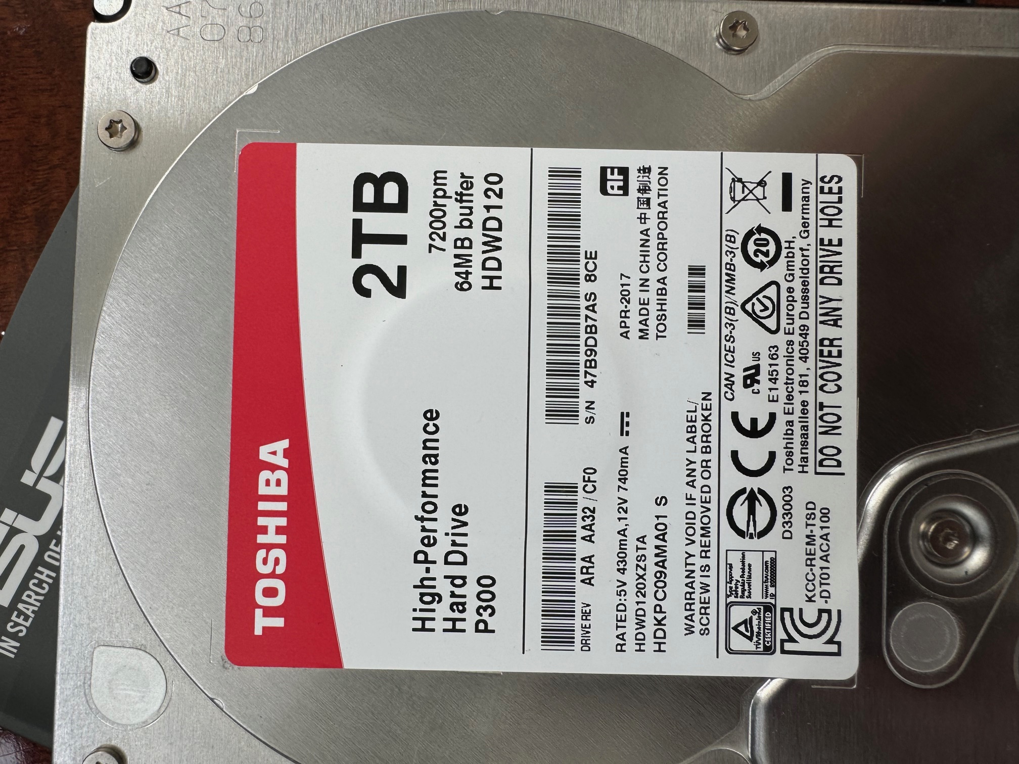

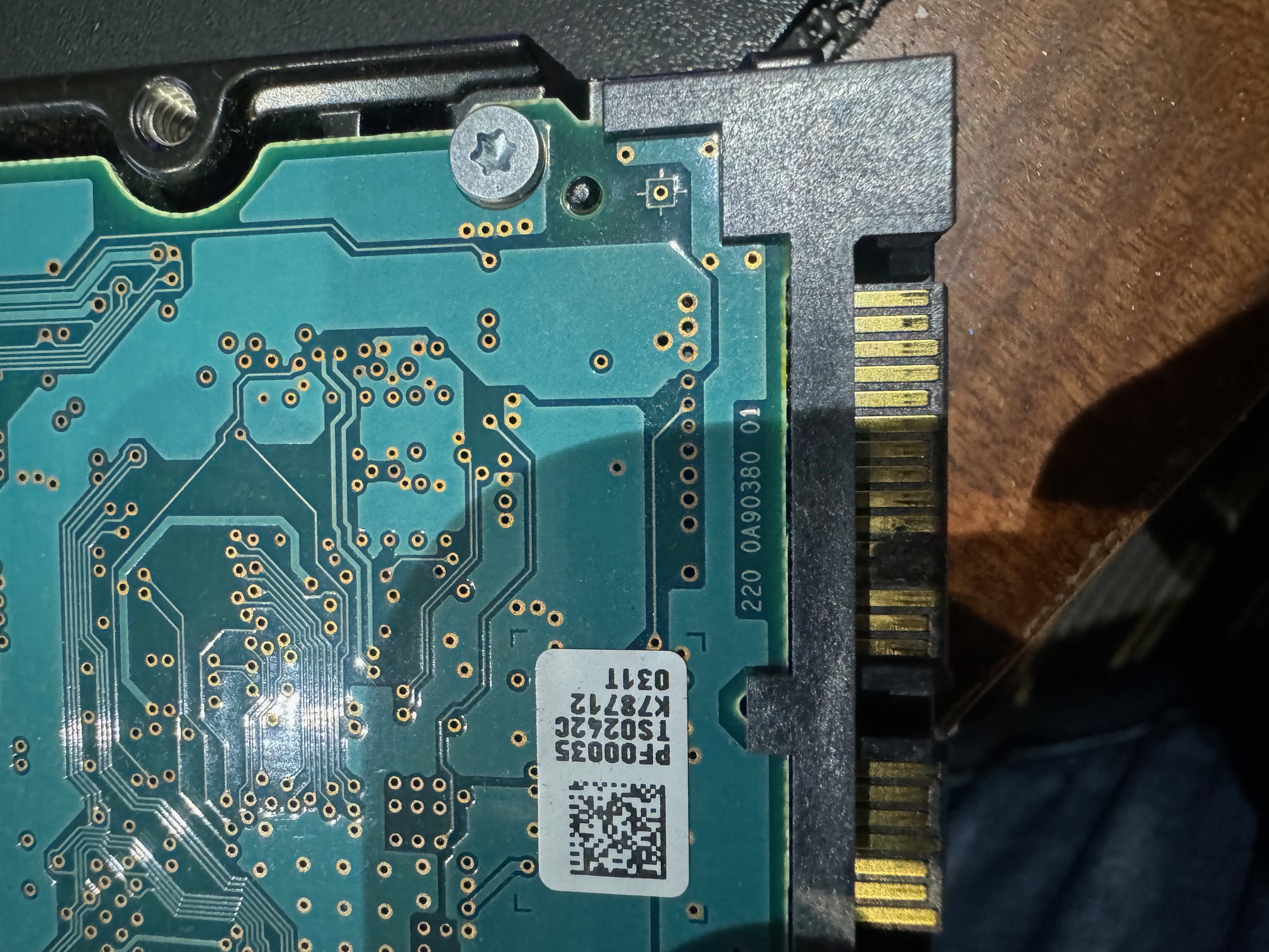

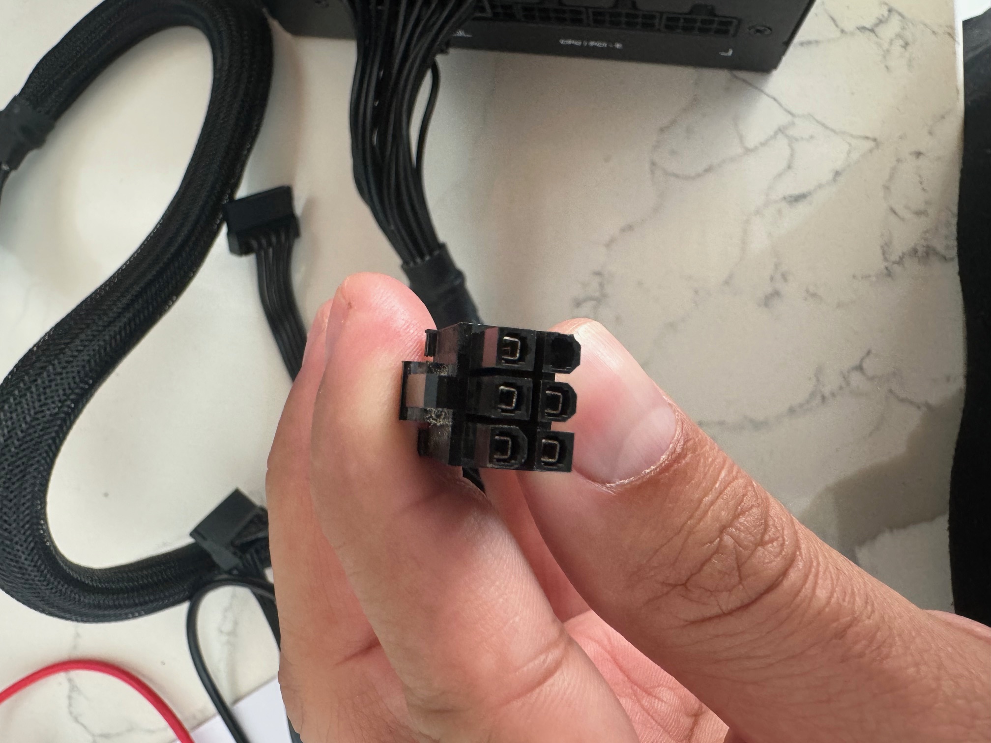

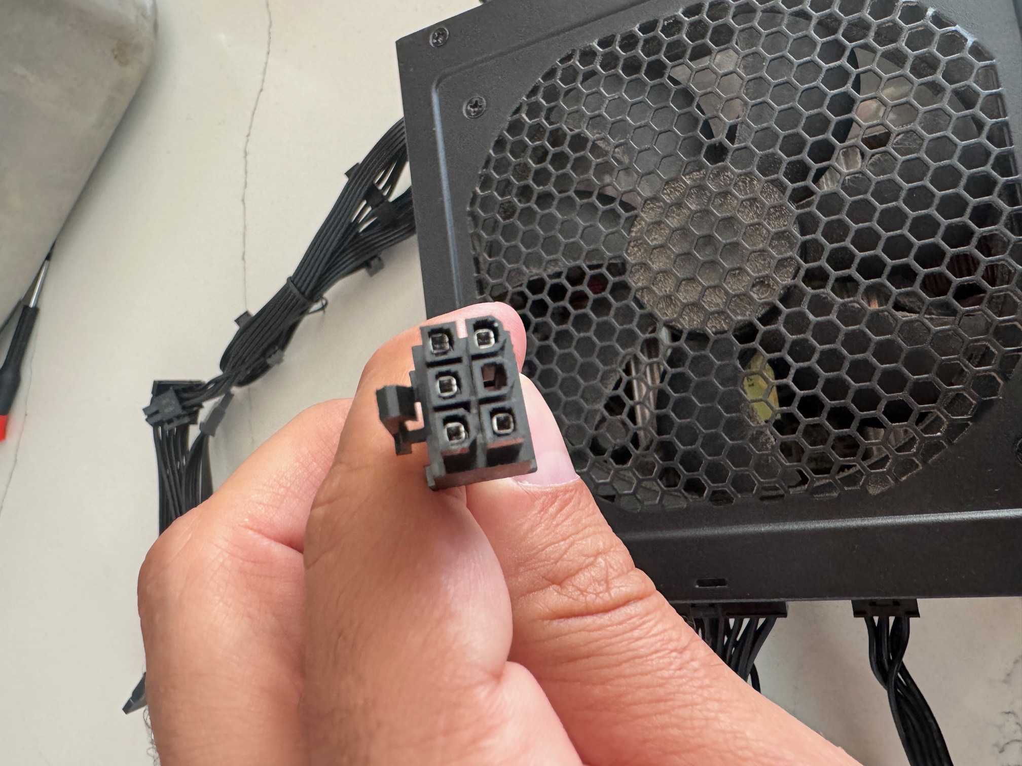

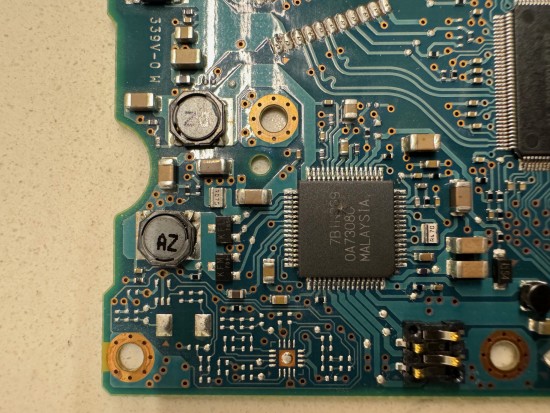

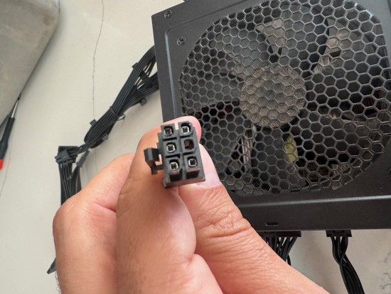

Hello Everyone! Yesterday, I pretty much built another pc and I had a Toshiba 2TB hard drive that I used as a backup & storage for pictures and family documents. Long story short, with the new pc, the PSU wont start unless I removed the PCIE to SATA cable feeding HDD, it was working right on my other pc so I took it back to it and it didnt read it as well... I tried other PCIE to SATA cables on the modular PSU (Corsair HX1000) I one of these caused the HDD to burn the SATA connector and even the SATA cable to the motherboard melted... I didnt feel the HDD move the internals at all.
Any advice would be appreciated, from what I have read, I could find a donor board with identical chips and swap the eprom, but since this was a case that burned the connector, I am concerned about internals such as the motor causing issues again.

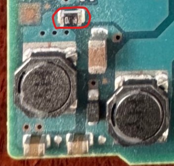

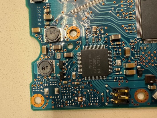

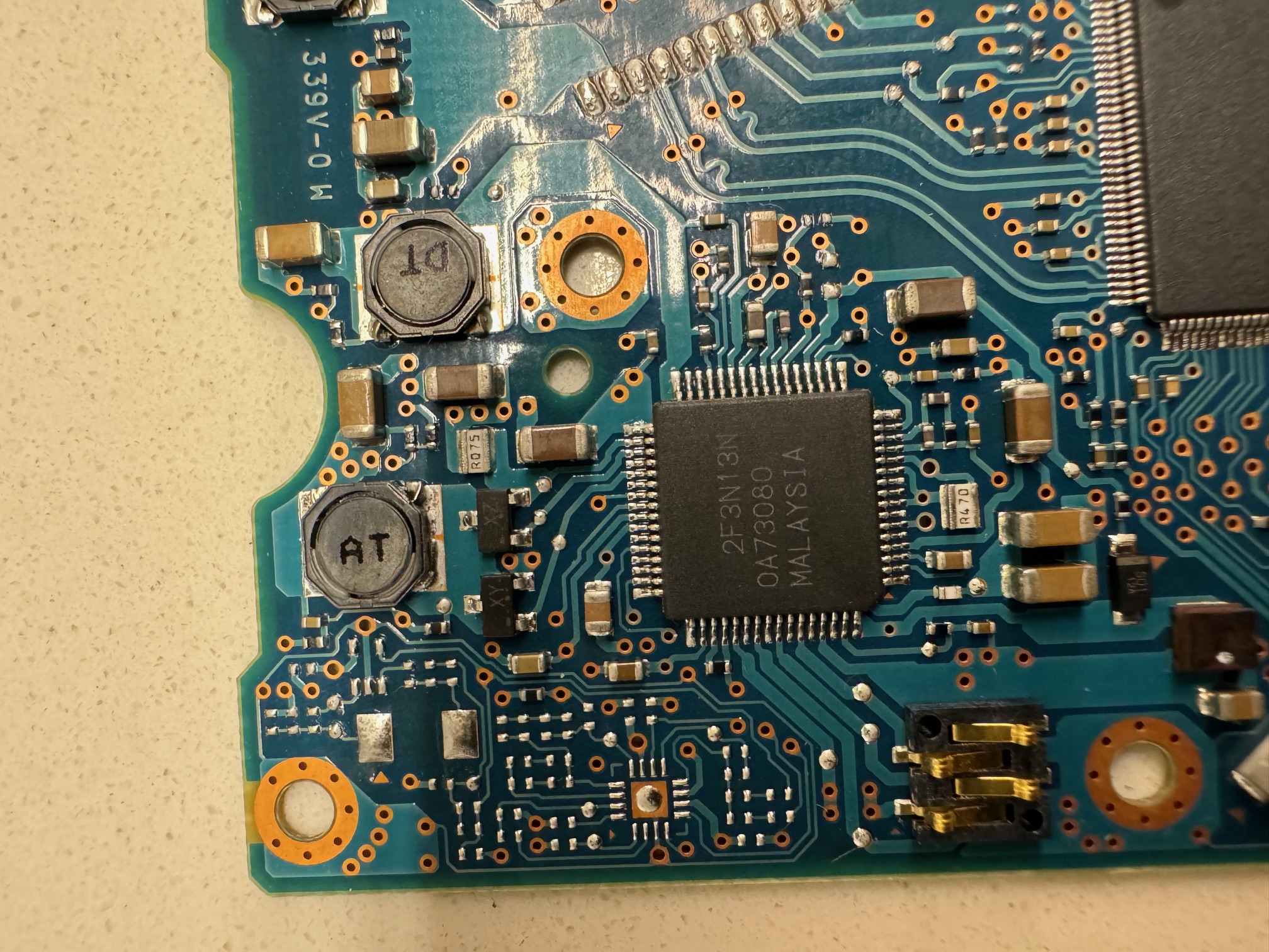

The motor controller IC (0A73080) has a burn mark.
The 0.47 ohm resistor (R470) near the HDA connector also appears to be burnt. Can you measure its resistance? This resistor is in series with the supply to the preamp.
It is measuring 0.5 ohms after measuring it multiple times. I agree, the motor controller had something so I guess its one of the first things to go out?

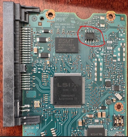

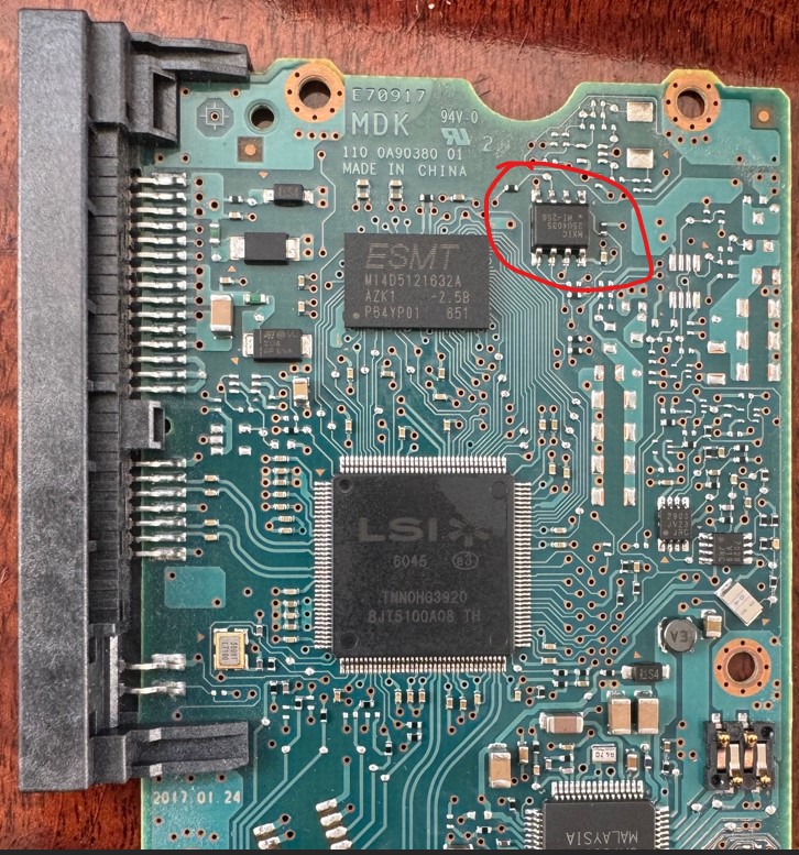

So I found a board with the same board number, VCM Controller and MCU but different memory brand, is that ok? From what I have read I have to swap the EPROM to attempt to make the drive work again.
Is this the eprom? Anyone know what could have cause this?
 Post subject: Re: Hard Drive Burned
PostPosted: January 7th, 2024, 21:43
Posts: 17335
Firstly, stop experimenting with modular PSU cables. Their pinouts are not standardised. What has happened is that you have applied 12V to the drive's 5V input. This has destroyed the motor controller IC and potentially the preamp on the headstack inside the drive.
http://www.hddoracle.com/viewtopic.php?f=56&t=2545
The chip you have identified is a serial flash memory, aka "ROM". It does need to be transferred to a donor PCB.
Measure the resistance between these voltage test points and ground (eg a screw hole):
https://www.hddoracle.com/download/file.php?id=10175&mode=view
This will tell us if the preamp is shorted.

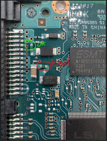

Also check the TVS diodes and fuses:
https://www.hddoracle.com/viewtopic.php?f=100&t=86

The sata cable to the motherboard also got really hoy and melted. I forgot to mention that I plugged in the HDD while the psu was on (stupid move).
PostPosted: January 8th, 2024, 0:53
Posts: 17335
That means that you had power on the ground wires.

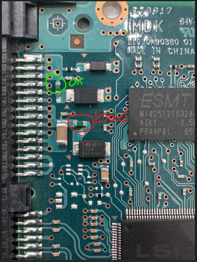

I did test the continuity for the fuses on the board, according to the post here: https://forum.hddguru.com/viewtopic.php?t=36362 and found that one of them is shut.
PostPosted: January 8th, 2024, 13:18
Posts: 17335
-5 to GND off - 0.352kohm
-5 to GND ON - 5.62kohm
These results seem to be reversed.

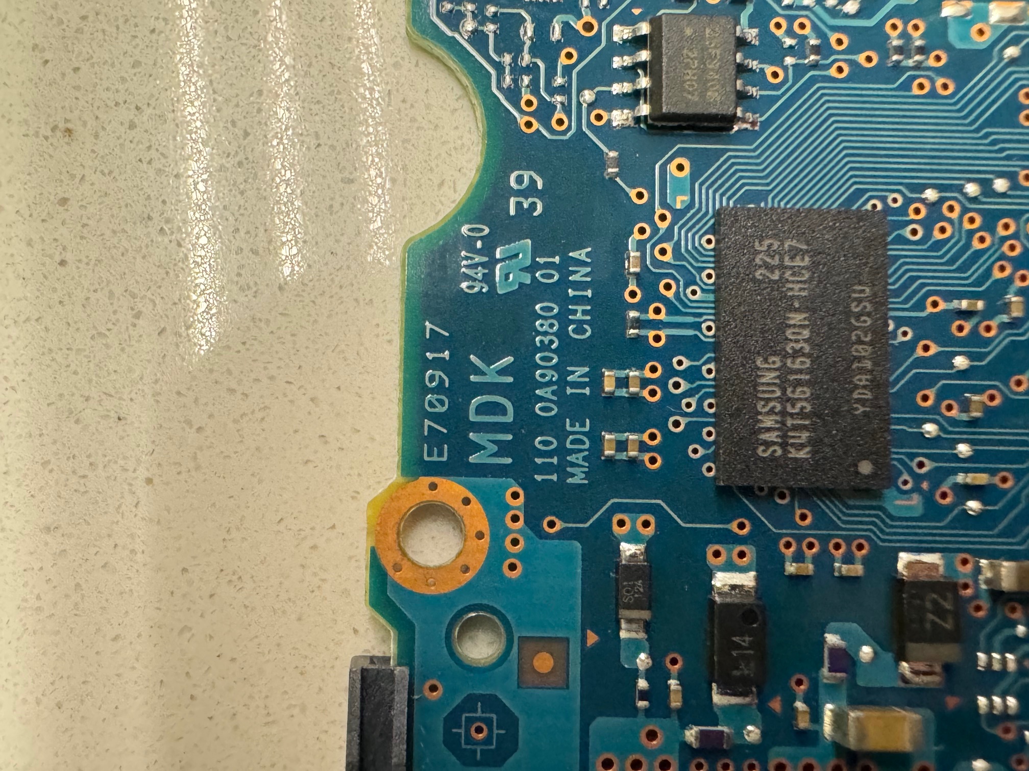

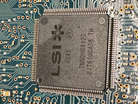

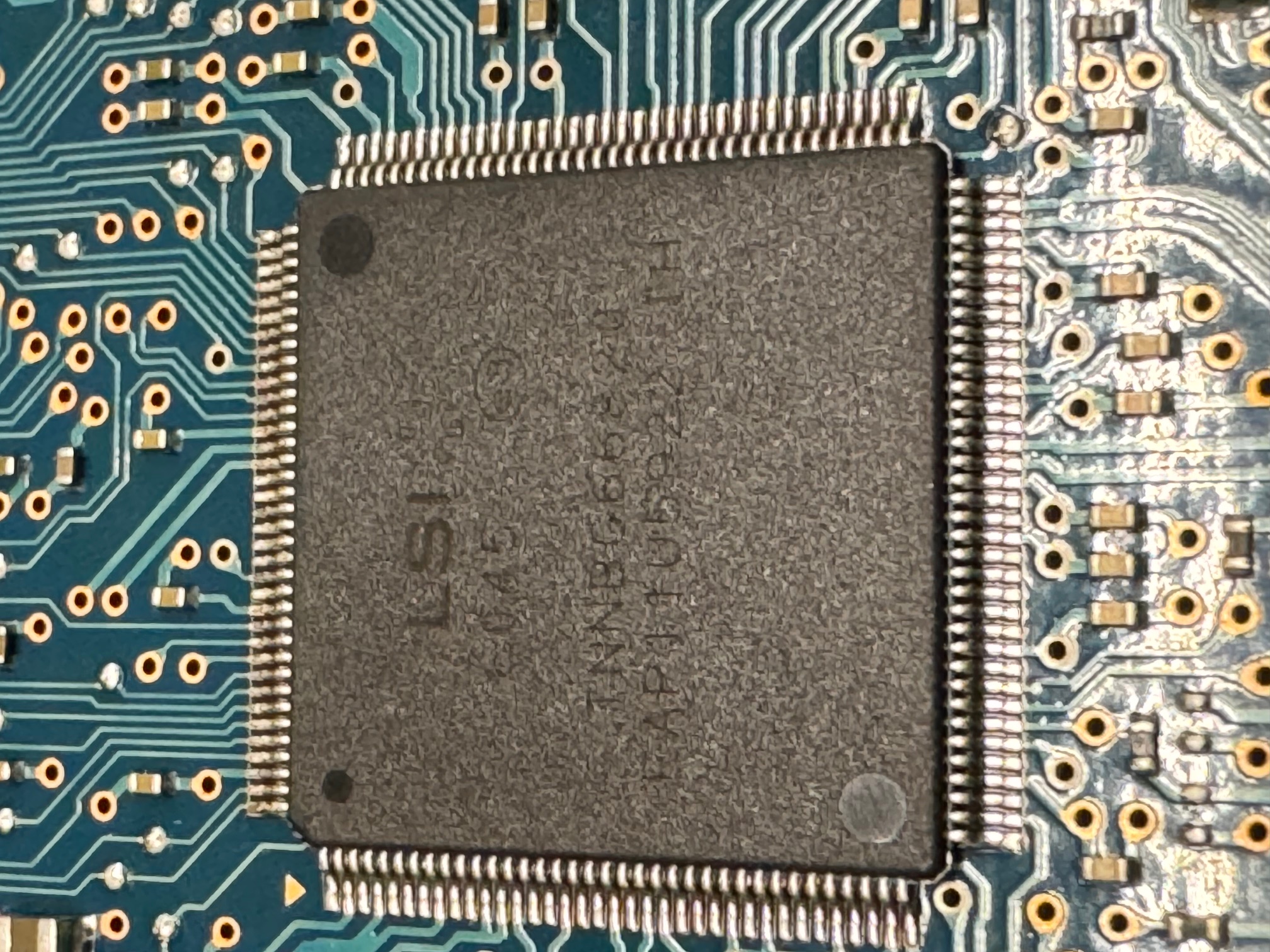

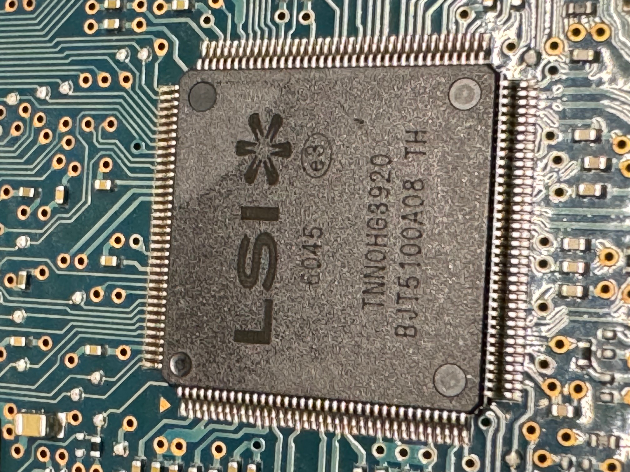

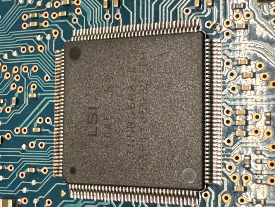

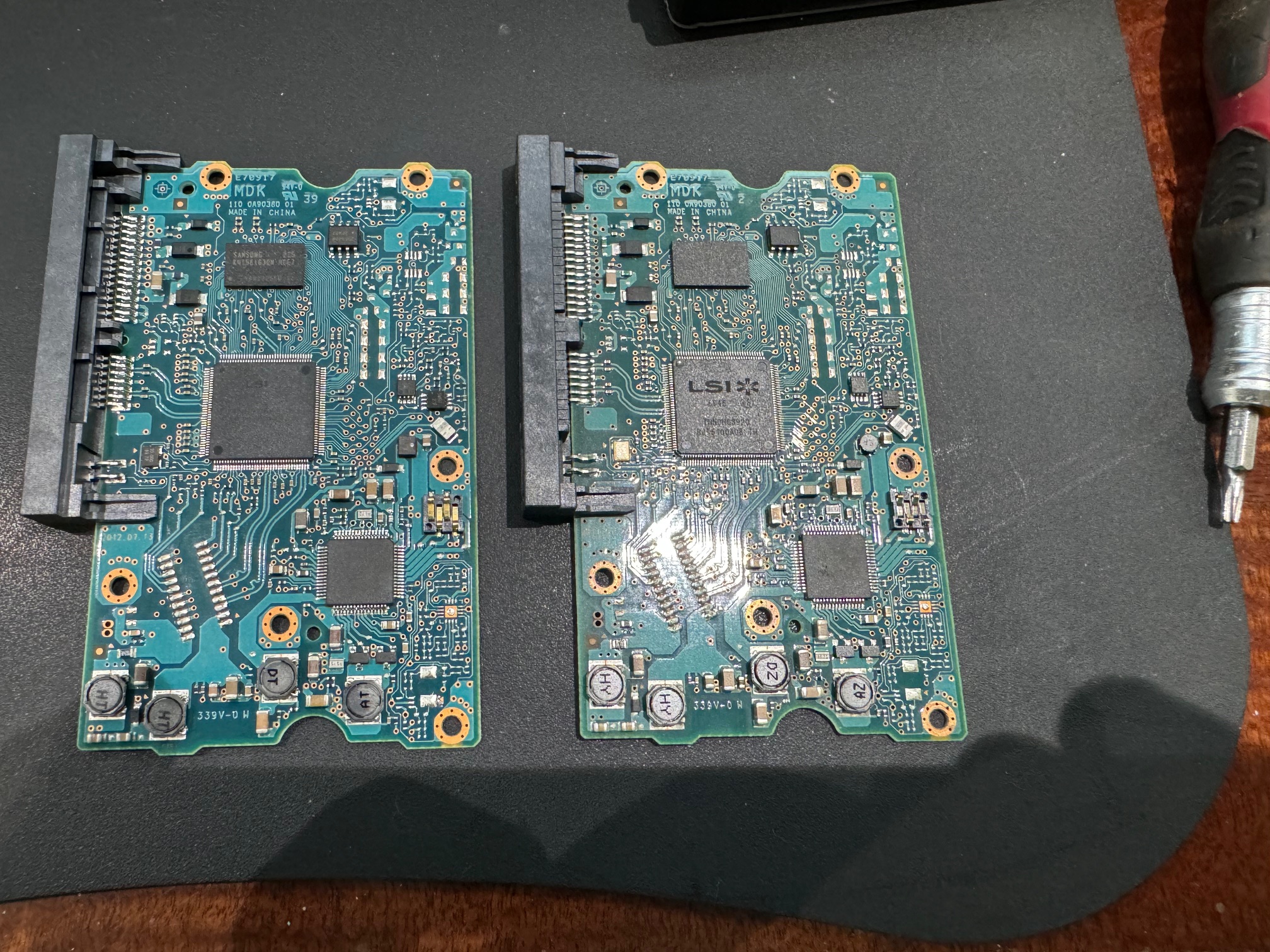

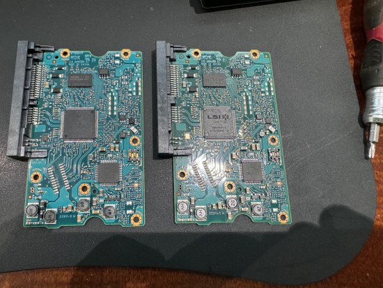

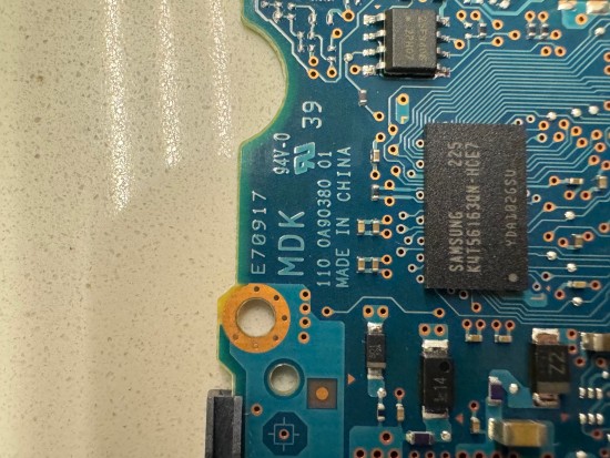

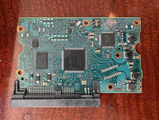

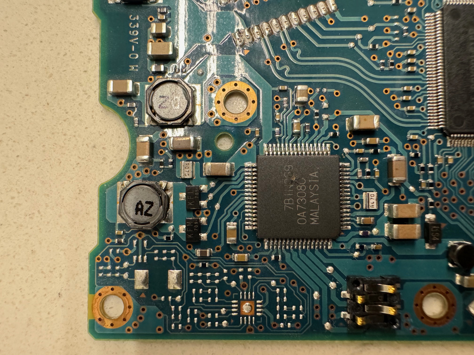

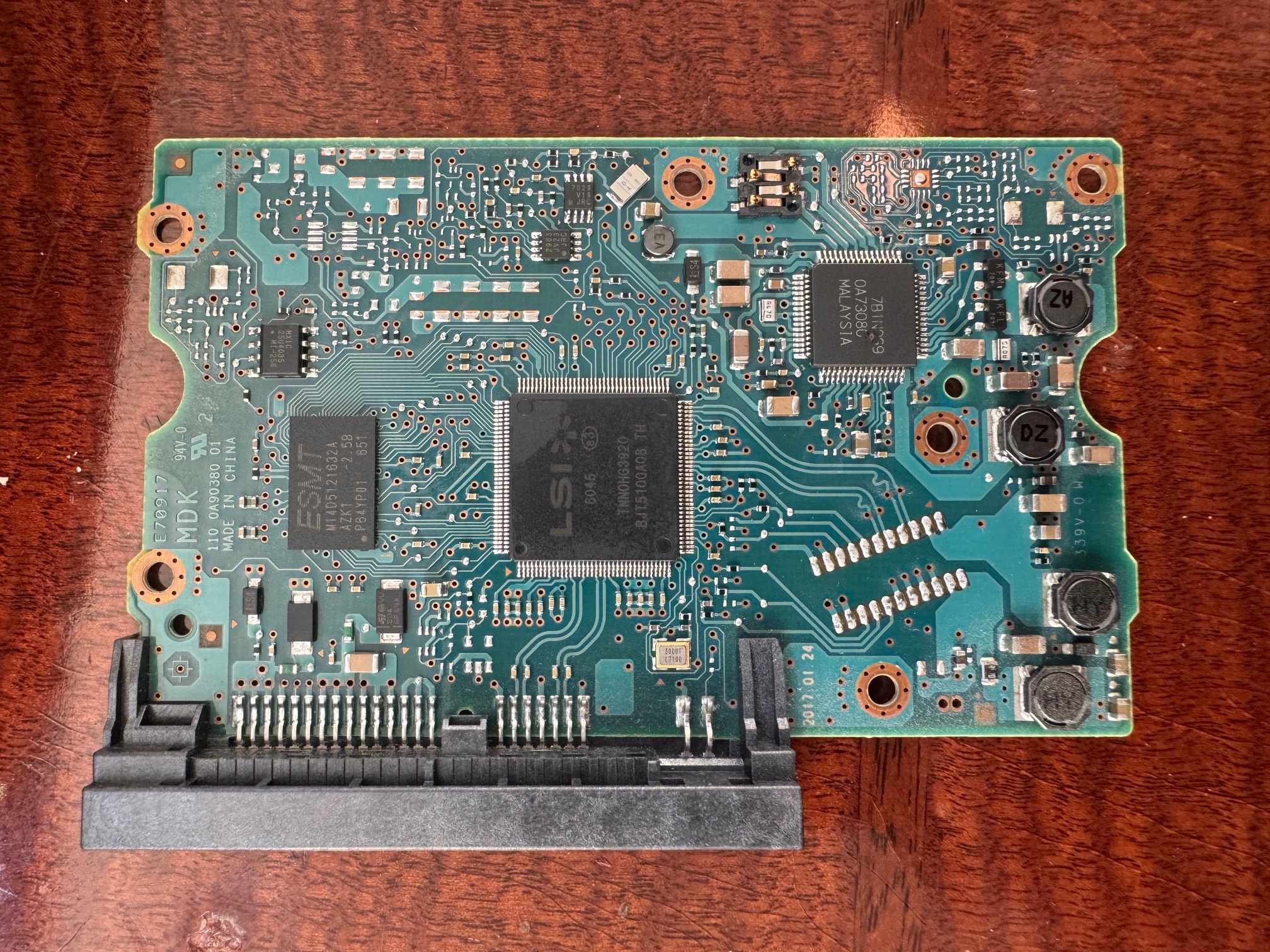

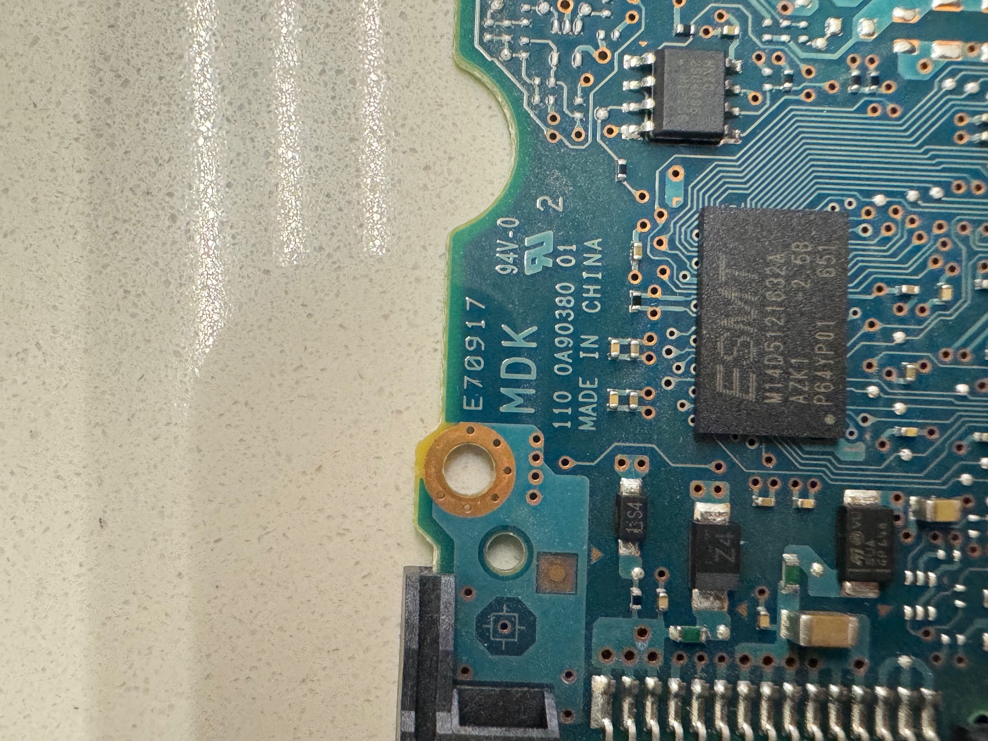

Got the donor board, but the MCU looks different even though both say 6045, is this a concern? I want to make sure before I swap the EPROM. VCM has the same number
OLD MCU:
NEW MCU:
OLD VCM:
NEW VCM:
Board:
PostPosted: January 12th, 2024, 18:36
Posts: 17335
Markings beginning with 0A or 0B are HGST part numbers. Therefore, the VCM part numbers are 0A73080.
The SDRAMs have different capacities.
K4T56163QN = Samsung 256Mbit (16M x 16) N-die DDR2 SDRAM
https://datasheet.ciiva.com/26786/k4t56163qn-hce7-26786865.pdf
M14D5121632A = ESMT 8M x 16 Bit x 4 Banks DDR II SDRAM (512Mbit)
https://www.esmt.com.tw/upload/pdf/ESMT/datasheets/M14D5121632A(2A).pdf
I don't know the matching rules for this drive, but this site refers to a sticker on the back of the PCB:
https://www.hdd-parts.com/14090304.html
PostPosted: January 12th, 2024, 18:57
Joined: January 7th, 2024, 9:12
Posts: 18
Location: Vega Baja, PR
thanks for replying, thats not the best news for me, maybe i should have done better homework.
Would it risk the data of i tried to use this board?
