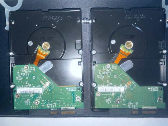

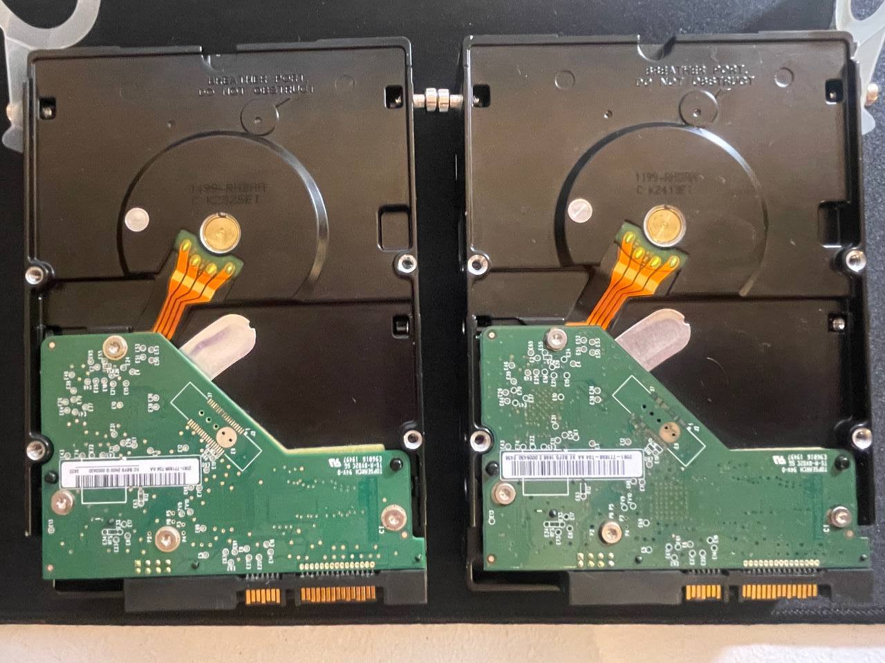

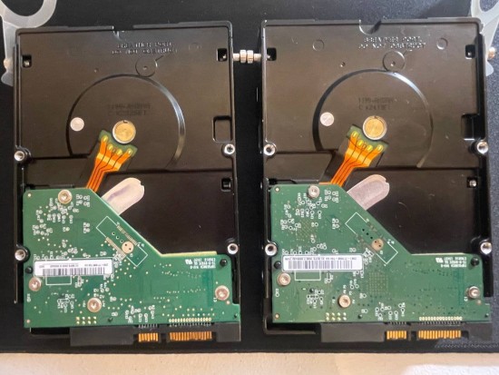

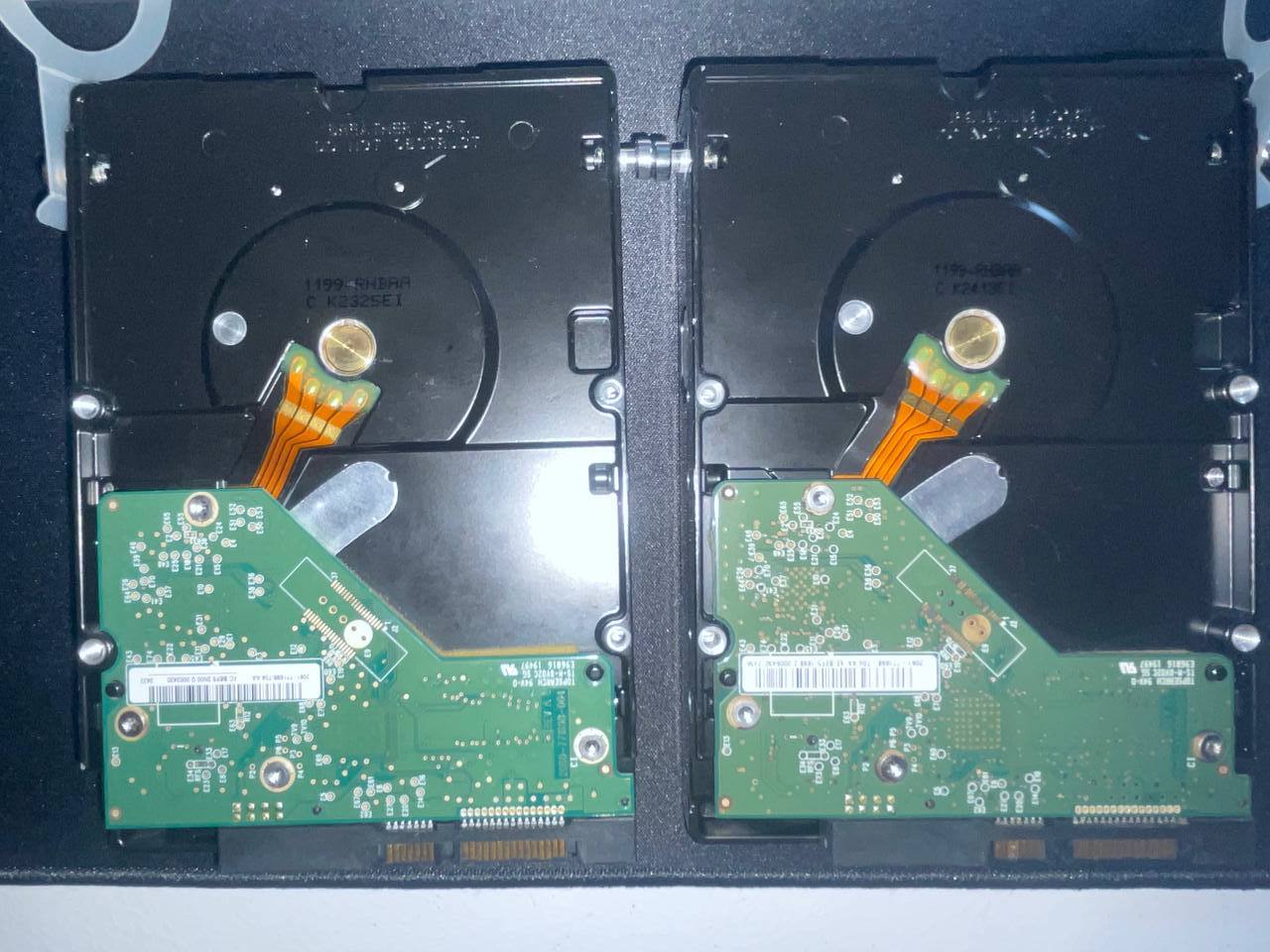

Upon closer inspection I see that one of these PCB's has a darker discoloration on some of the metal mounting points on the PCB. I took side-by-side pics of them here.
So I'm guessing that one of these boards had the water affect it more than the other and maybe has shorted out causing this darker burn-looking discoloration, I don't know, just speculating.
But since this is RAID 0 then I would have to replace this 1 board and reinstall it back into the original chassis and hope it starts up because I won't be able to get the to spin individually because of the RAID 0 configuration.
But I may need to replace the BIOS chip if the firmware is different. I don't know if it is just a clamp or if that chip is soldered because then I would have to bring the old and new PCB to a shop just to do that. Am I correct in any of this perhaps?

 Post subject: Re: Water-Damaged WD MyBook Studio Edition II Quad Interface
PostPosted: January 28th, 2024, 1:13
Posts: 17339
That looks normal.
Oxidisation on WD PCBs:
https://www.hddoracle.com/viewtopic.php?f=86&t=649
Did you understand what @SWM wrote?

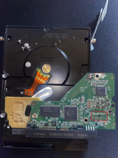

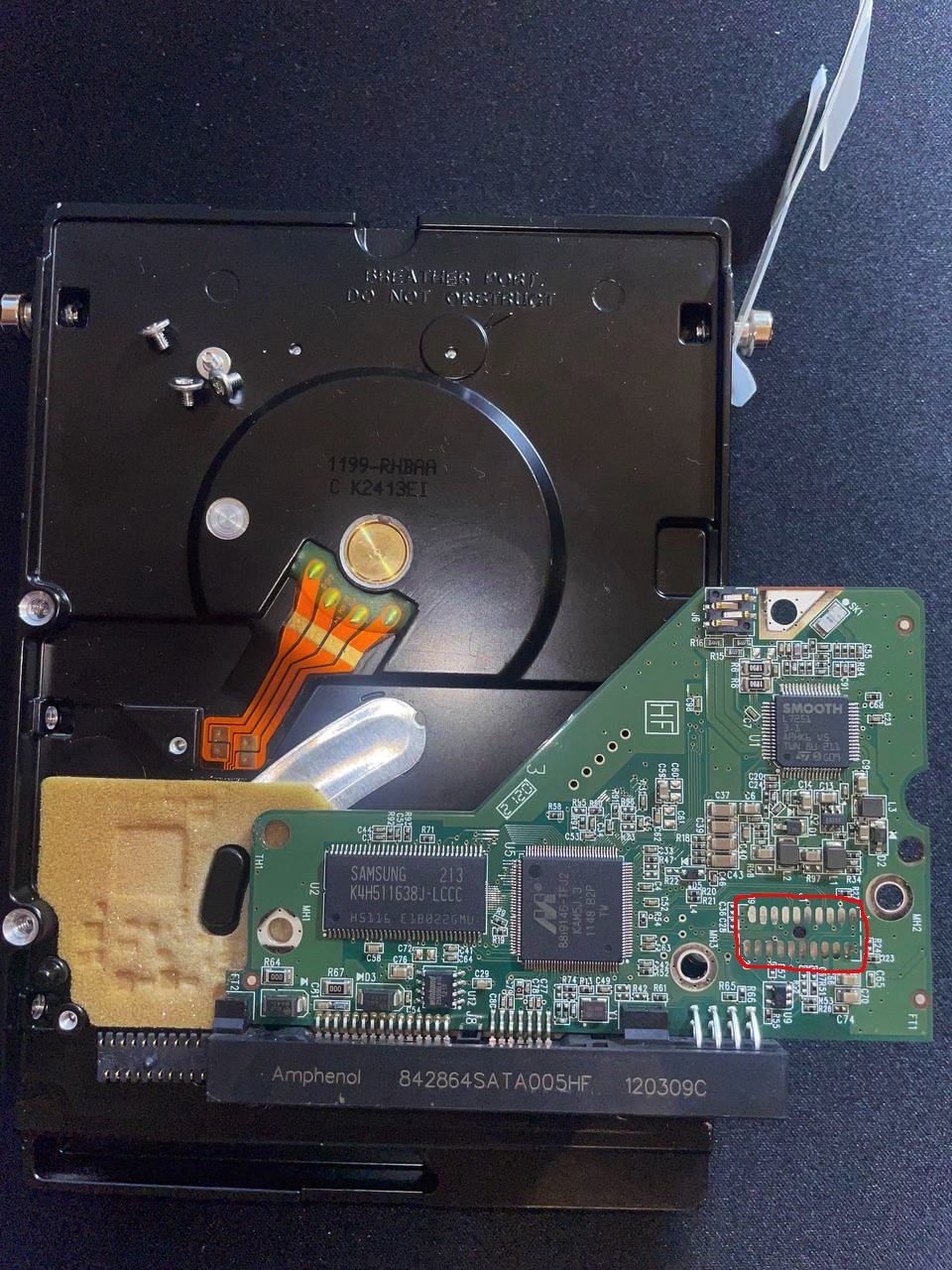

So I have taken the PCB off the drive casing and the other side looks good besides in 1 spot which I have circled. Not sure what those metal contacts are for?, but they are the only area that looks darkened or burnt or corroded besides the screw mounts.
The other dark areas you may see in the pic aren't actually there its only the shadow from a desk lamp to my top right. When I hit it with my flashlight they aren't there. Nothing is wet, but I'm thinking of soft cleaning the darkened metal areas with a new toothbrush and 90% isopropyl alcohol if that may do something. Or maybe the whole board as a 2nd attempt if it doesn't work.
PostPosted: January 29th, 2024, 1:26
Posts: 17339
That's normal. Just scrub it very gently with a soft pencil eraser. Don't scrub too hard, otherwise you'll remove the plating.
