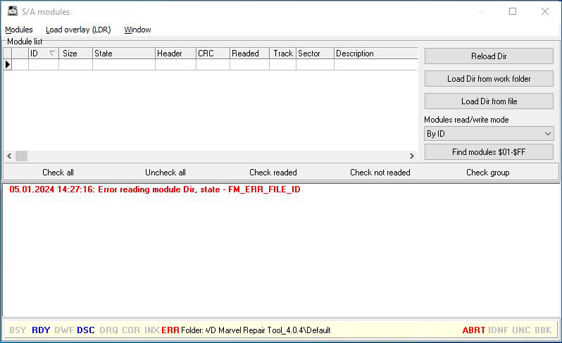

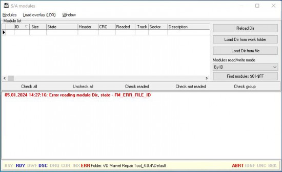

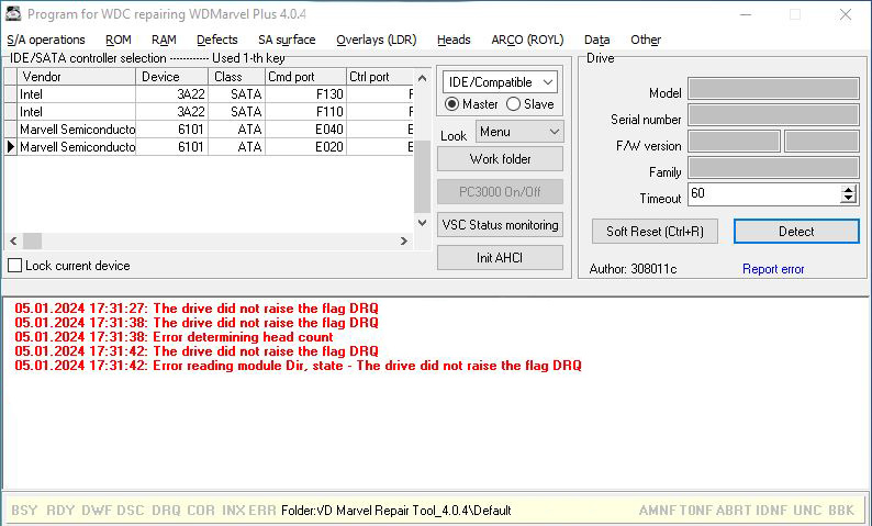

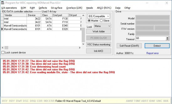

With the patient drive in normal mode:
- WDMarvel cannot see the drive: The drive is not defined
- When trying to read modules: Error determining head count, Error reading module Dir, state - Invalid drive handle
- Windows also doesn't see the drive
With the drive in kernel mode (using the 3 jumpers):
- WDMarvel sees the drive: Drive: WDC WD20EARS-00MVWB0, family: 0133 Unknown, FW: 20.0AB, SN: , LBA 0 - 0Gb
- When trying to read modules: Error reading module Dir, state - FM_ERR_FILE_ID
- Windows sees an uninitialized drive
However I also checked with a fully functioning drive in kernel mode and get the see picture -> Error reading module Dir, state - FM_ERR_FILE_ID
In normal mode I can read the modules without issues for this drive.
As I understood I should be able to access the modules in kernel mode at least for the functioning drive, any idea why this is not working? Isn't there any "easy" way to find out if I am dealing with a messed up SA or if the head(s) are gone?

Spildit wrote:
I alread read the posts you linked above and tried to read the modules accordingly. However WDMarvel cannot access the modules. I also tried shorting TV9-TV10 to enter kernel mode with the same results, no access to modules.
Doesn't that indicate that there must be something wrong with the heads?

I cannot do any of the steps in the tutorial as long as WDMarvel doesn't see the drive or lists any of the modules? In kernel mode that is. In normal mode WDMarvel can of course see the drive, backup all resources etc.
Below is what I see in kernel mode trying to detect the drive and trying to read the modules (this is one of the donor drives, don't want to stress the patient too much).
diybit wrote:
Since I have an identical HDD (same model, same PCB, even same date) I tried swapping the PCB. Same picture tough (donor HDD with patient PCB works fine).
This first statement seems strange, are you sure the drive was right working!? Try use the modules from this donor.
What I meant was:
Patient with donor PCB -> still not working
Donor with patient PCB -> working fine
I have no clue what else to try to get the drive into proper kernel/ IO mode...

i had similar case few months ago... i was not able to fix it remotely with WDmarvel.
Customer brought the drive to me by hand, and i was able to fix it with MRT.
It was SA issue, if i remember well it was just mod 01 corrupted.
