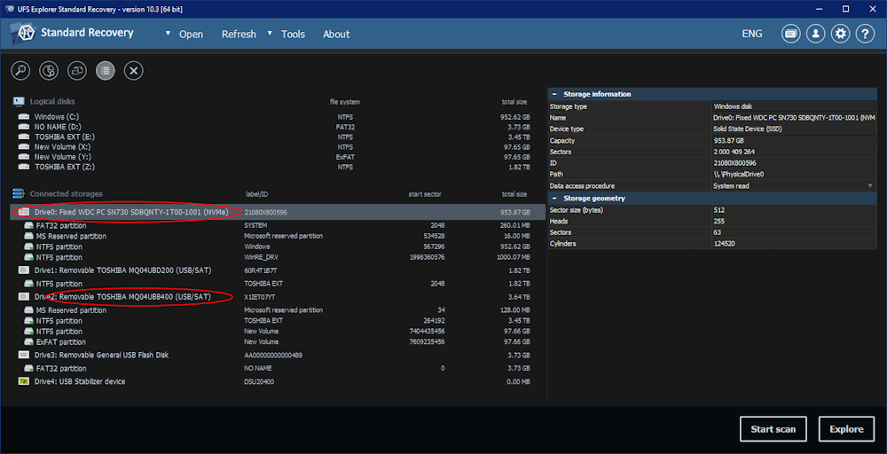

Can we get actual drive model? If uncertain UFS will tell, and so will SMART tools like CrystalDiskInfo. A screenshot would be nice.
