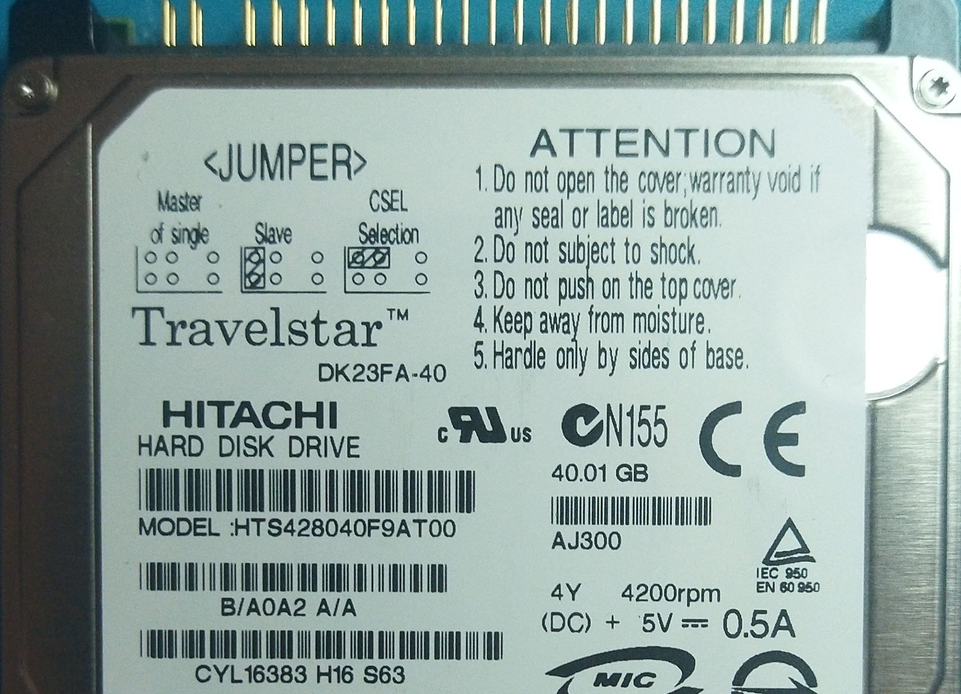

Would anyone have a hitachi DK23FA-40 microcode file to share?
Thanks.
 Post subject: Re: HITACHI DK23FA-40 microcode
PostPosted: March 5th, 2024, 13:01
Posts: 291
Location: españa
This would be the disk model, if someone has it and can extract the firmware resources (mainly microcode), I would reward by paypal.

Thanks Dimitri. I also have the same model (family) in 30GB and 60GB but in native Hitachi for it to be compatible the microcode has to be of the same family and capacity (as far as I know). Or repair it, but I have no idea if this is possible.

I would need to repair/replace the microcode which is damaged, the pcb is fine. The microcode in Hitachi Native is the "Grandfather/Father" of the NV-RAM in Hitchi-IBM. NV-RAM there are methods to repair it but I don't know for this "family member".
I also found something but also without the microcode, the reason is that dumping it takes about 20/30Mtos.
I'll keep looking....... They are very old units and it is difficult for someone to have it in a database. The most feasible is that someone who has that model and bothers to do the dump (would be rewarded).
