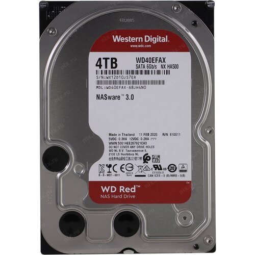

Drives Detail: 2 4TB WD40EFAX
This case we got month ago and is still not recoverable we did everything but unable to get data folder wise as user required data only folder wise. When connect with WD my cloud box utility said no Raid configured and no valid volume found.
When connect to system both drive shows same partition table and 2 TB data written on sectors this is RAID 1 mirror but we notice both drive have some slow sectors in start around 450 mb 1 drive has more slow sectors than other we have image one drive as backup.
Every Data Recovery software we tried give data in raw and not in readable form then we did an experiment, Installed 2 new drives on WD my cloud box created RAID 1 and copy some data, when one single RAID drive connected to system DR software detected a valid partition and data is folder wise ok. But when search data come in raw
Which means WD My cloud needs healthy partition to copy data but needs any database file for search data. Both 4TB drive has slow sectors so we can think that the main data partition is corrupted and for raw recovery needs a database file to search data. The case looks easy as drives scan ok, with only some slow sectors in around 300 MB to 800 mb, but it is going impossible.

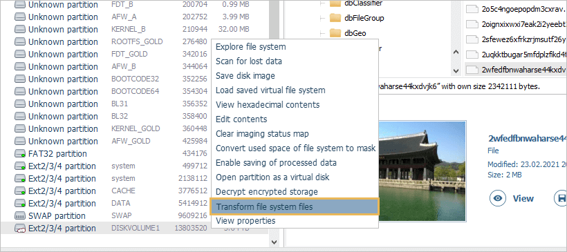

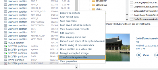

in UFS Explorer,
