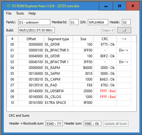

AFAICT, the code and adaptive sections of your ROM look OK.
I can see a digital signature, so I believe the ROM is locked to the MCU.

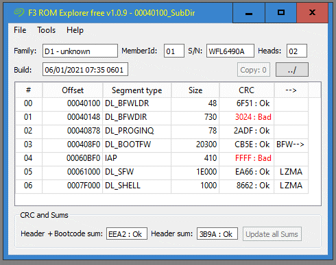

What output do you get in terminal? If you have PC3K, what does its ROM analysis show?
If you transfer the RAP, SAP, CAP adaptives to your donor ROM/PCB, does the drive spin up?
I compared the two BFW containers and their only difference is the digital signature.
Has the drive been to some other DR shop?

If you're referring to me, I'm aware of this. The terminal will complain about a mismatch in the digital signature. I expect that this signature would need to be patched into the donor ROM, with appropriate CRC recalculation.
Digital signature in BFW container #1:
00006F80  01 00 00 00 85 52 27 F3 CE 33 67 F1 53 0F 70 51
00006F90  5C D1 3B EB C9 5D C8 B5 FC AC 75 63 DD 63 F7 B8
00006FA0  DF A6 59 76 EC 4B A8 F7 B5 CD 6B FE 98 BD AD 78
00006FB0  94 C7 E3 72 9F 1A A8 A5 D1 4A 7D 83 37 68 CC D0
00006FC0  8A 08 E4 E2 50 0A FF 75 BE E7 7A 6B DE 83 35 30
00006FD0  71 D4 1C 18 47 F3 AA 05 A5 84 DE 2F D7 BF 45 89
00006FE0  0F 96 D5 46
Dummy digital signature in BFW container #0:
00006F80  33 22 11 00 00 00 00 00 00 00 00 00 00 00 00 00  3"..............
00006F90  00 00 00 00 00 00 00 00 00 00 00 00 00 00 00 00  ................
00006FA0  00 00 00 00 32 32 32 32 32 32 32 32 32 32 32 32  ....222222222222
00006FB0  32 32 32 32 32 32 32 32 32 32 32 32 32 32 32 32  2222222222222222
00006FC0  32 32 32 32 31 31 31 31 31 31 31 31 31 31 31 31  2222111111111111
00006FD0  31 31 31 31 31 31 31 31 31 31 31 31 31 31 31 31  1111111111111111
00006FE0  31 31 31 31                                      1111
