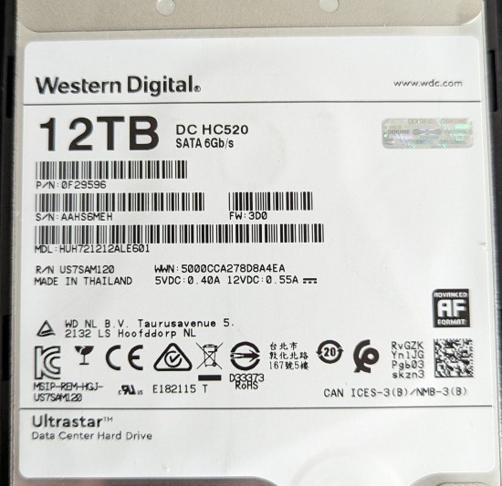

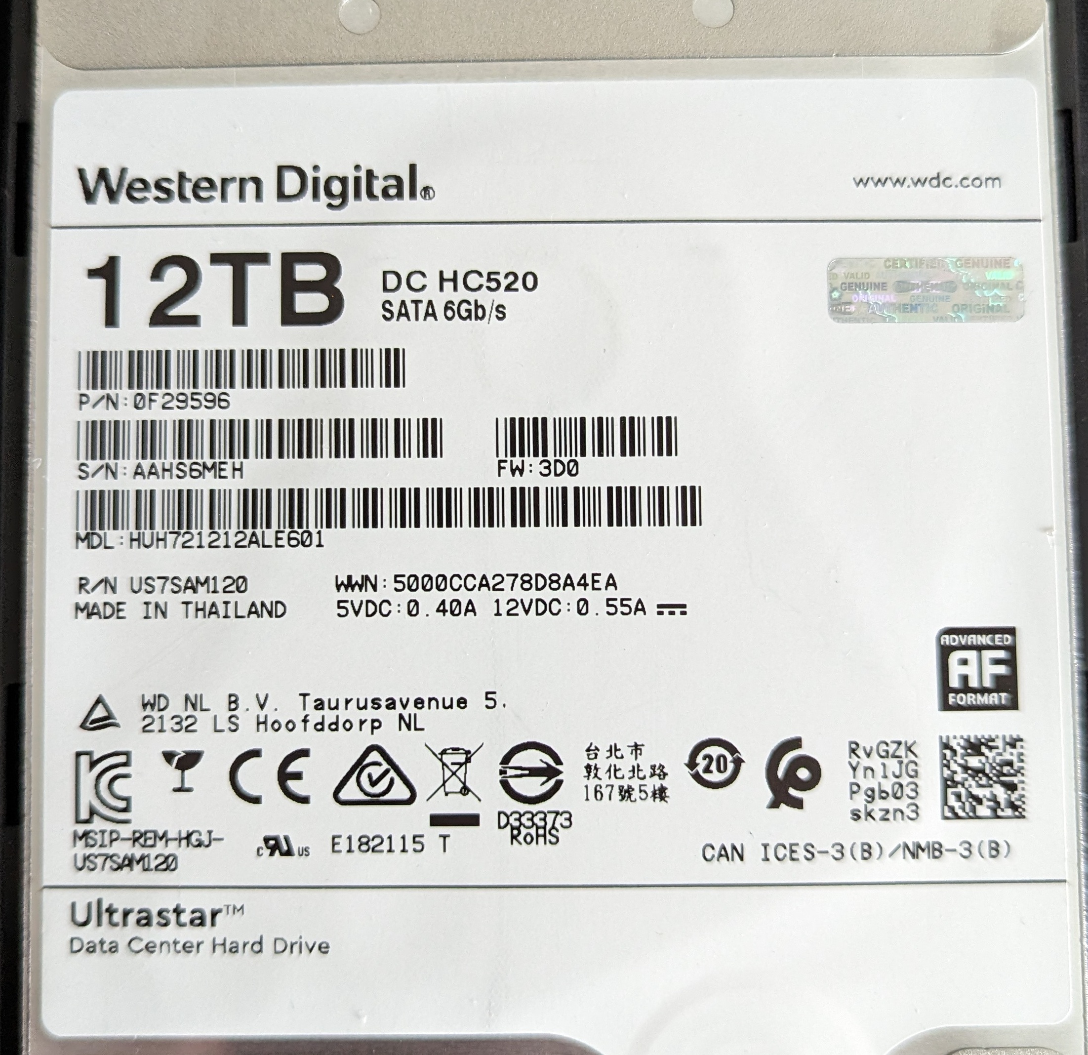

Could we see the label?

Sure, here you go.

I don't know what an "LHC drive" is. :-?
https://support-en.wd.com/app/warrantystatusweb
    Serial Number - AAHS6MEH
    Warranty Status - NO LIMITED WARRANTY
    Model Number - 0F29596
    Description - LHC Drive ASM 12.0TB, 512e, SATA P3_PWDIS_Support, Wasabi, SED

Label says fw is 3d0, i guess early this drive has standard oem fw, you could try update it with LEGNXB01

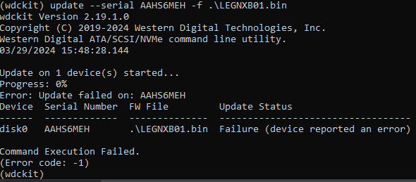

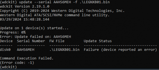

Gave it a shot and it failed. Did I run it correctly?

Tried with hugo and just got "failed to update firmware" error.
