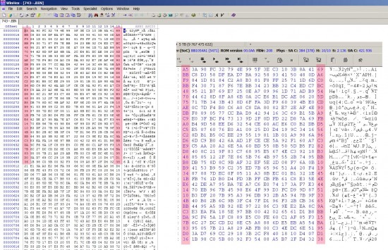

 Post subject: Anyone noticed this beside me?
PostPosted: March 31st, 2024, 5:50
Posts: 2857

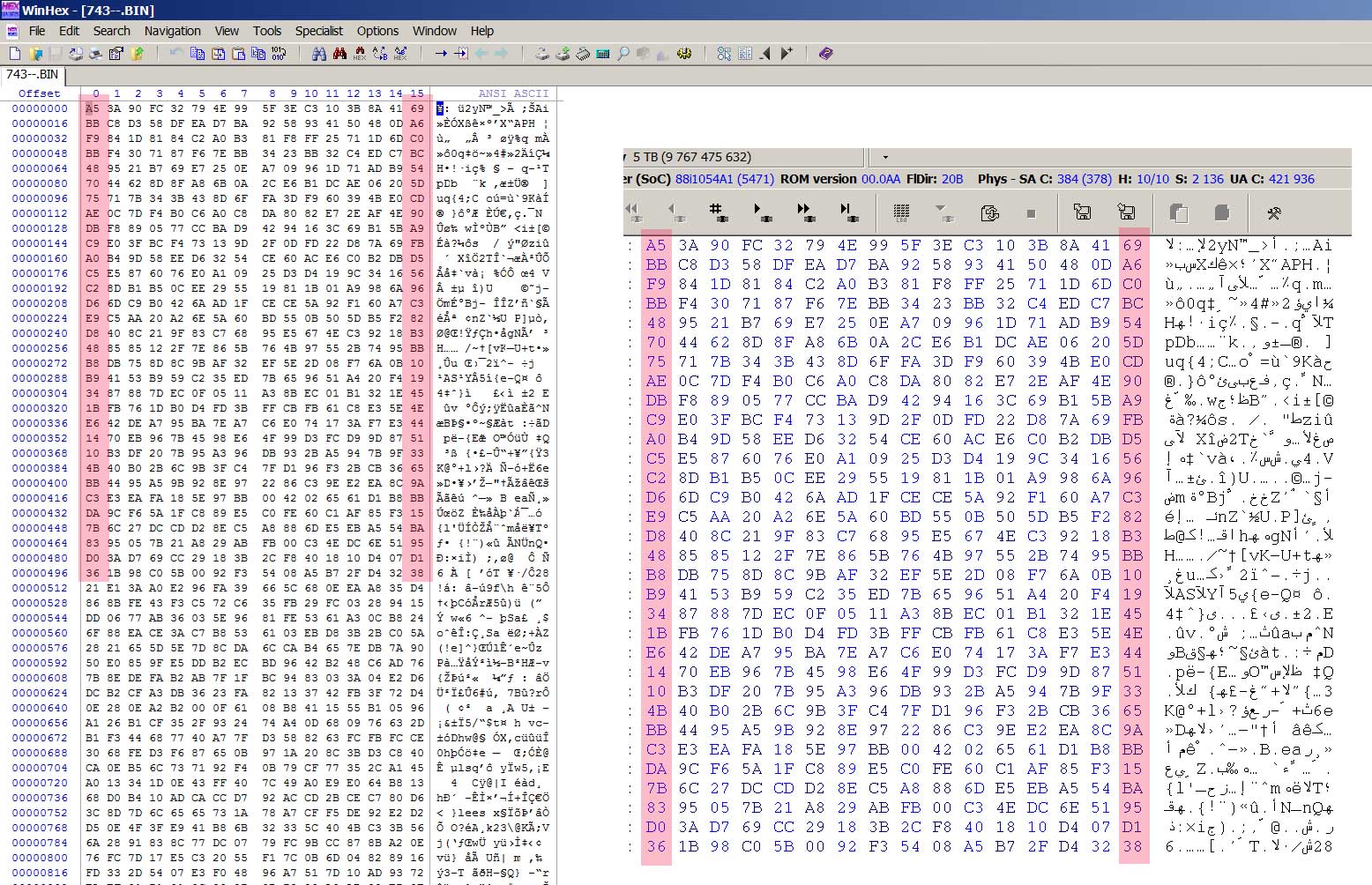

Comparing 1st. sector with other 2 PCBs (3k/winhex) in SpyG2 Ultra
:idea:

SpyG2 Ultra used 2 other USB3 with the same ROM written to both & gives the same Enc. pattern in sec0
means something?

Sector 0 does not look like a GPT MBR that was encrypted by WD's AES algorithm. I would normally expect to see two identical 16-byte lines in the partition table corresponding to two empty partition entries. Or am I misunderstanding something?

on these drives encryption is salted with something lba and offset (somehing like that), so you cannot see any patterns.

I didn`t change the SED (am aware of this)
@ fzabkar
Yes, its Encrypted,,,
The point here is no matter what Other USB pcb you use the encrypted sectors are the same (tested on this family now but i assume the others are the same)

"What is the capacity (in sectors) that is reported by the USB mass storage device?"
you will find it on the photo i uploaded (the inner photo top left 5TB - 9767473632)
FYI (since you are not into DR) those MCU PCBs are a must to access the data,
Original USB3 PCB >>> Data accessiable
Any other USB3 PCB (my case here) >>> whole drive encrypted (unique key inside MCU for data access)
My point is: no matter what other USB3 pcb you use >> sectors encryption is the same (as in photo to compare)
does this mean something??? maybe and may not

Your original post confused me. You seemed to be suggesting that all PCBs, including the native one, produced the same encrypted result. Therefore, I was wondering whether the ROM code was ignoring the MCU key.

I thought so,,, thats why i explained it in details on my prev. post :roll:

you mean writing original ROM (UN-patched by 3k) to usb3 results the same encrypted pattern as in photo in my 1st. post
 Post subject: Re: Anyone noticed this beside me?
PostPosted: April 4th, 2024, 8:05
Posts: 4854
SED off = turn it off in 02, use orig rom and the non-native pcb.
do you get the same data?
PostPosted: April 4th, 2024, 8:26
Posts: 2857
Yes pepe the same
