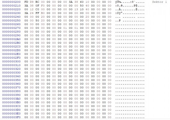

I got an old Buffalo DriveStation HD-CX500U2 500GB to save its data. No problem at all, the buffalo breakout board was intact and I was able to connect via USB, find the filesystem and copy out the files.
Next I tried to read the internal SATA disk Samsung HD502HI directly via SATA interface, but I was not able to find a data partition or raw userfiles. So I assume its encrypted in some way and not accessible without the proper buffalo breakout board.
I there a way to save the files without a working breakout board? How would you solve the case with hdd only?

When the drive is in the enclosure, what is the capacity, in sectors, reported by the USB mass storage device? If it is less than the native capacity of the bare drive, this would suggest that there is a reserved section at the end of the user area. If there is no reserved area, then this would suggest that the encryption key is stored in the bridge firmware.
There is a difference: When I connect the disk directly, there are 1.269.888 sectors more than connected via the breakout board. That corresponds to about 620 MB, the CD partition, which also shows up when using the breakout board, is about 600 MB, which is roughly the same.
Side finding: When connected via breakout board, R-Studio only finds the CD drive partition, but not the data partition or the drive itself. UFS Explorer, on the other hand, does.

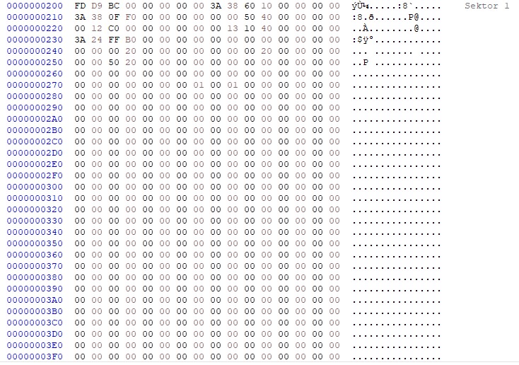

Can you upload the first 100 sectors or so of the encrypted drive? This might help to determine the encryption algorithm.
I manually checked the first 1000 sectors and they are empty, except sector 1, see picture. (HDD directly connected via SATA)
Can you dump the contents of any flash devices on the bridge PCB?
does not work. I connected another drive to the breakout board, but in windows only some kind of CD-Drive Partition appears, but does not work. No other partition showed up.

The native capacity of your drive is 0x3A386030 sectors.
Starting from offset 0x203, your LBA #1 appears to consist of big-endian LBAs and sector counts.
0x000000003A386010 = 0x3A386030 - 0x20
0x000000003A380FF0 = 0x3A386030 - 0x5040
0x0000000000005040
0x000000000012C000
0x0000000000131040
0x000000003A24FFB0 = 0x3A386030 - 0x136080 (0x136080 = 0x131040 + 0x5040)
0x0000000000000000
0x0000000000000020
0x0000000000000020
0x0000000000005020
0x136080 x 512 bytes = 650 MB
ISTM that interesting things happen at those LBAs.
size is correct, nice calculation, my mind blows :-)
here are these 650MB / 620MiB as zip
https://www.dropbox.com/scl/fi/rkyhjnw3 ... 47f3g&dl=1
A RAW Scan reveal 182-198MiB (depending on tool UFS/R-St), which are roughly the same size as the files in the CD-Drive Partition, when connected via breakout board. Also the content of that files is same. This area seems to be not encrypted.
What to do next?

I search around in this area for hours :-) I also came over Offset 0x26208000 and thought this must be encrypted zeros and data from here on. I could not interpret it like you, that this seems to be some kind of mbr, but your idea is great! I looked before and after that sector, now I'm looking at the end of the disk, but cant find anything useful.
I also started to investigate the breakout PCB and dumped its bios chip (winbond 25xx), but also no luck: chip detected, but only FF inside... :-/

I feel that there is something special in the last 0x20 sectors, but I don't know what that is.
after finding the probably last encrypted data, I exported the last 10MB of the drive.
zip file attached.
SAMSUNG HD502HI last 10MB.zip [12.43 KiB]

there is sector 1 again, and something called OPT :?:
