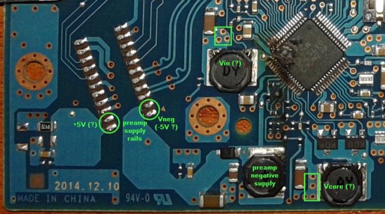

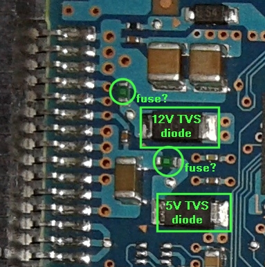

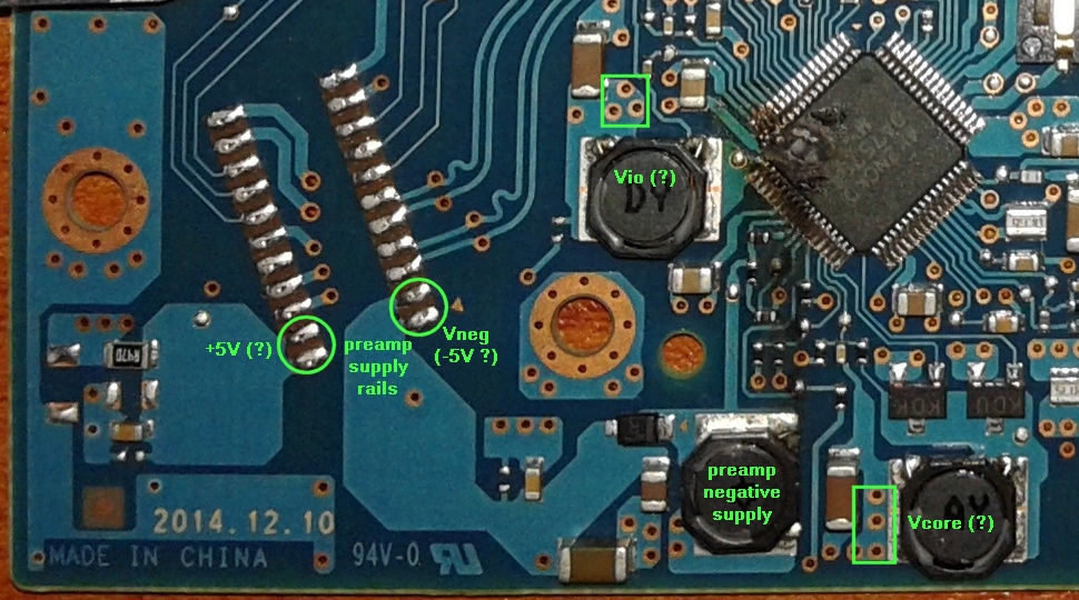

PostPosted: December 2nd, 2015, 14:39
Posts: 17228
The damage to the motor controller IC appears to be on the 5V side. The MCU also appears to be cooked. It's only academic now, but the OP could test the TVS diodes and fuses (?) to see whether the damage was due to an external overvoltage.
To confirm whether the preamp is shorted, I would measure the resistance between ground and each of the preamp supply rails.
