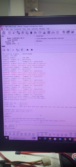

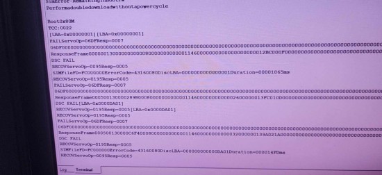

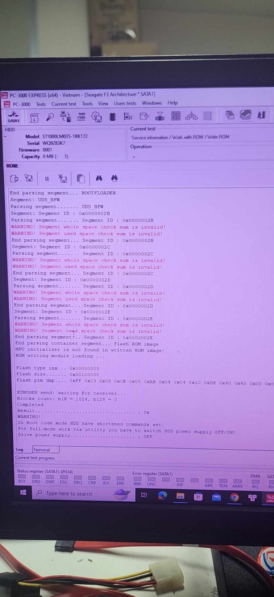

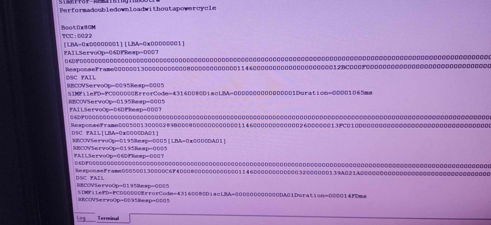

I have this Seagate ST1000LM035-1RK72 WQ9283K7 FW:0001 which is weak and died upon recovery.
Changed new sets of heads > was clicking for a while > got DSC FAIL error > Performadoubledownloadwithoutapowercycle > goes into DRD state > but cannot do anything
Upon unlocking Tech mode i noticed this errors.
What can i do in this situation??
Anyone can help?
Thanks!
File comment: ROM Unlocking ERROR
436592361_3706898886305250_604240151697957729_n.jpg [ 119.97 KiB | Viewed 4208 times ]
File comment: Error after changing heads

The "used space" and "whole space" checksum errors are bogus. Segment 2B contains SMART attribute data.
By bogus: you mean they are fake?? Fake logs?
 Post subject: Re: Seagate ST1000LM035 DSC FAIL after head change. Error in
PostPosted: May 13th, 2024, 0:12
Posts: 17228
No, the data is OK, but there are no checksums. PC3000 is wrong.

gameboybin wrote:
Ok that means. The heads must be incompatible
Use F3RomExplorer to extracts those segments to a file, then analyse the files with a hex editor.
https://www.hddoracle.com/viewtopic.php?p=18531#p18531

Do the new heads still work in the donor drive?
PostPosted: May 16th, 2024, 4:58
Posts: 4816
the error means drive can read servo fine but cannot sync on sector, on both sa copies, which suggests it is looking at wrong location, which typically happens if rom is not native or head map is screwed.
Or both heads are weak, but i consider that having less chance.
Yes. They work flawlessly!
PostPosted: May 16th, 2024, 10:03
Posts: 1729
I would say this is a typical issue of scratches to the surface that preventing heads from loading SA.
