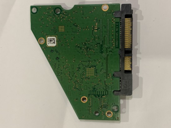

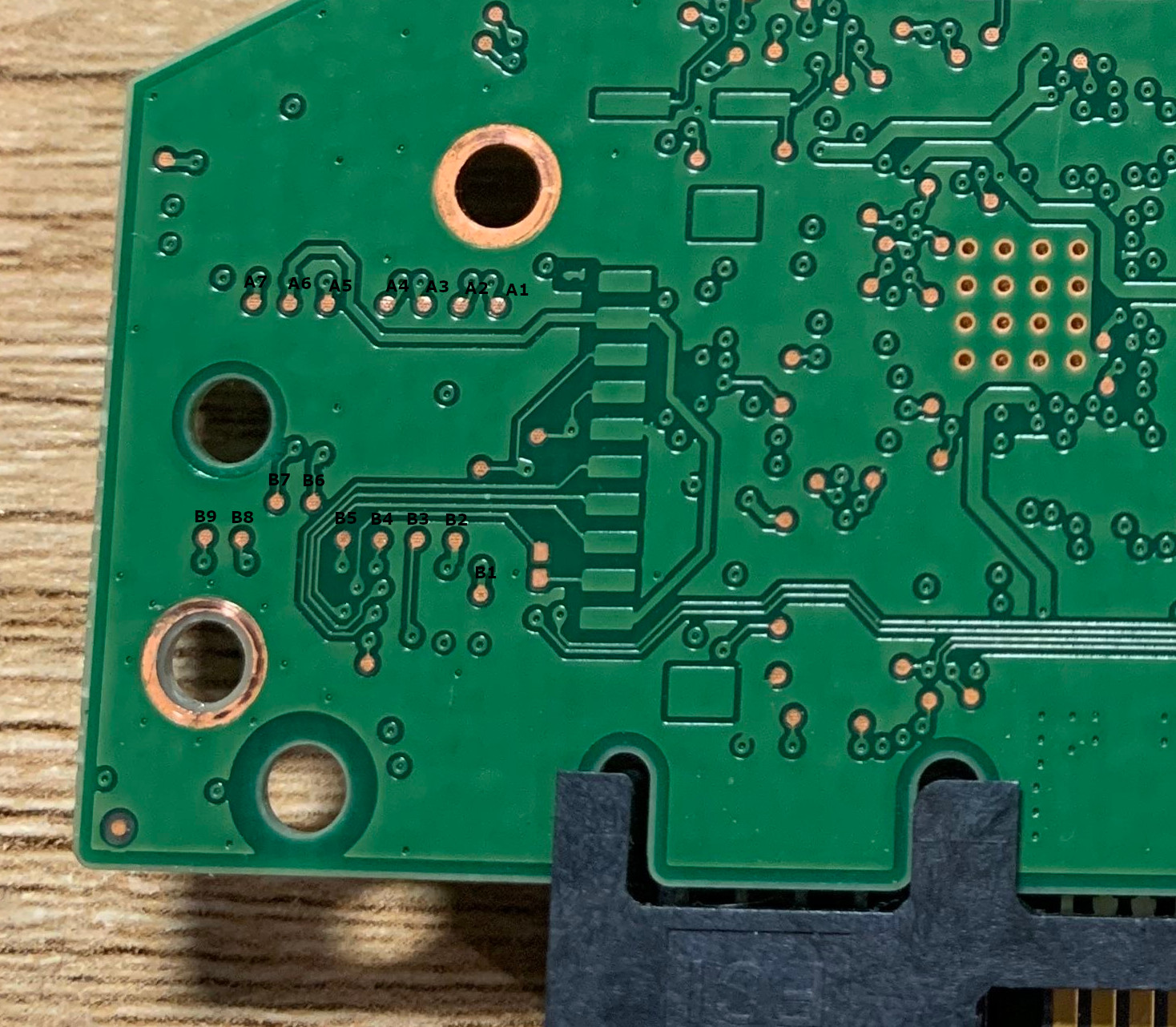

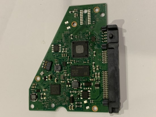

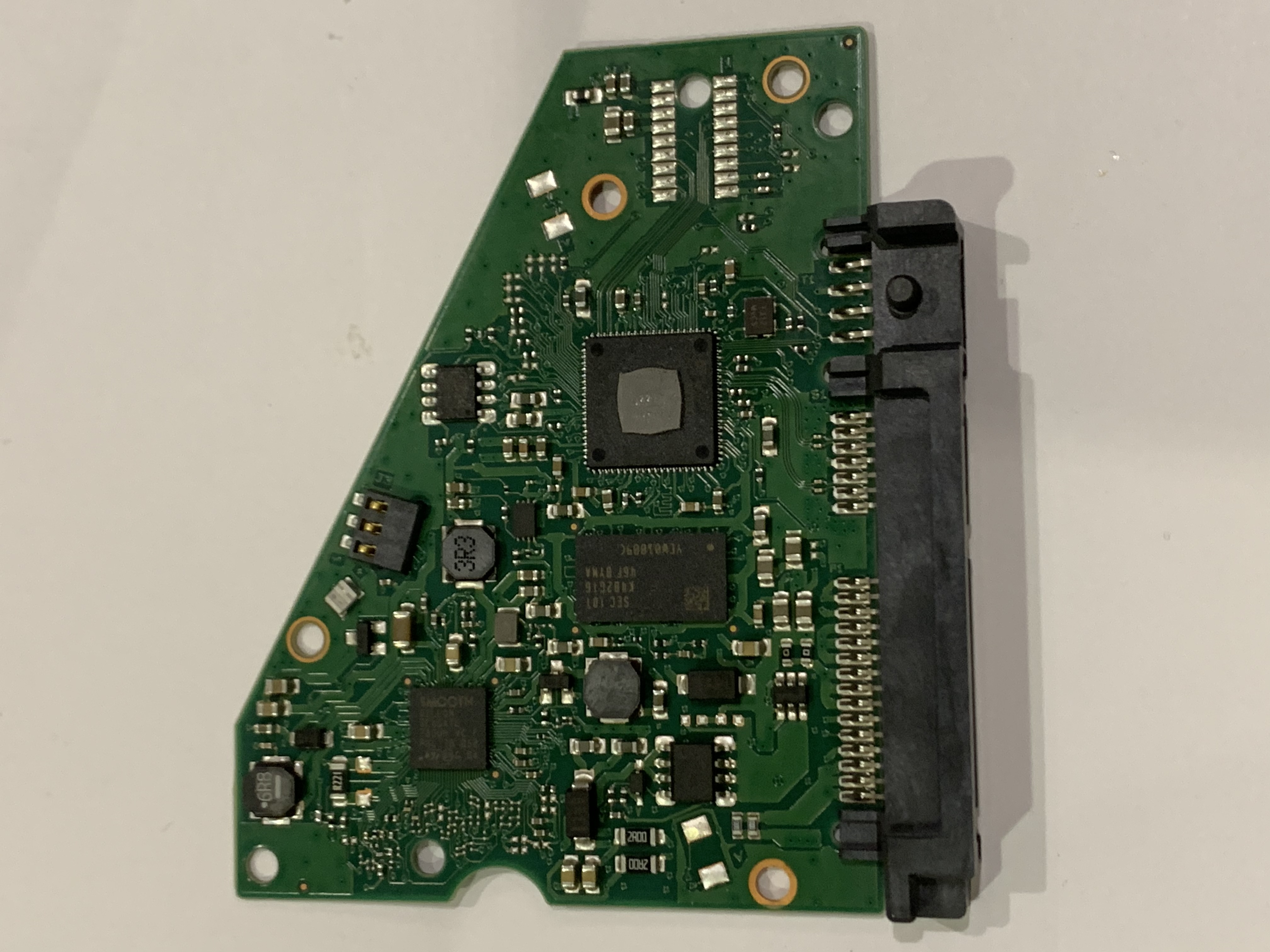

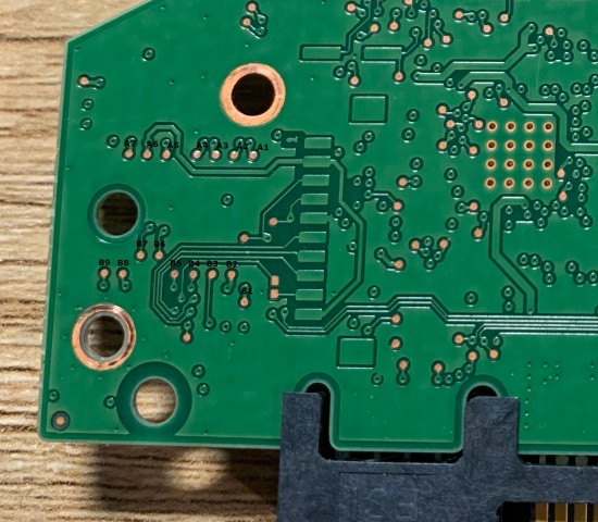

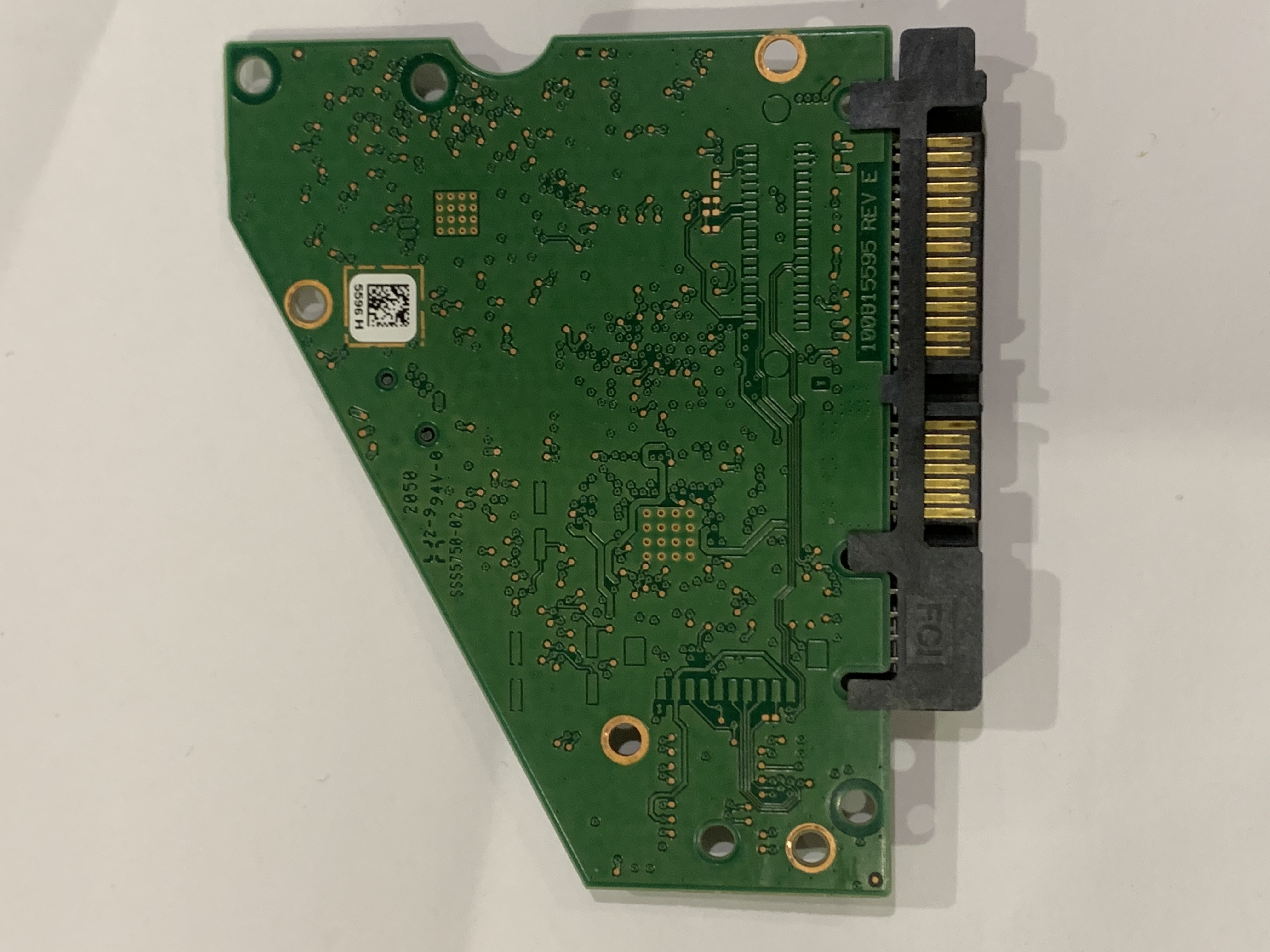

Hello. To access the terminal i need to make a short pins in this PCB, but i don't know which ones exactly.

What voltages do you measure between ground and each of the 4 HDA pads when the PCB is on and off the drive?
PCB is off the drive
    A1 = 1.37V ; B1 = 0.68V
    A2 = 1.37V ; B2 = 1.02V
    A3 = 0.03V ; B3 = 3.22V
    A4 = 0.03V ; B4 = 0V
    A5 = 0V ; B5 = 1.76V
    A6 = 5.18V ; B6 = 0V
    A7 = 0V ; B7 = 0V
    ------------- ; B8 = 0V
    ------------- ; B9 = 0V
PCB is on the drive
    A1 = 1.75V ; B1 = 6.04V
    A2 = 1.75V ; B2 = 6.00V
    A3 = 0.98V ; B3 = 2.23V
    A4 = 0.98V ; B4 = 1.51V
    A7 = 2.96V ; B7 = 0V
    ------------- ; B8 = 1.76V
    ------------- ; B9 = 0.03V

The write channel would be driven by the MCU whereas the read channel would be driven by the preamp. Therefore, I believe that A3/A4 is the read channel pair (because it sits at 0.03V when the preamp is not connected).
