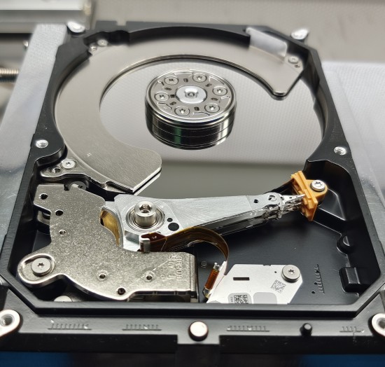

Just got a case with two ST1000DM000 in RAID 0. One of those drives has damaged H0. I did recover most of sectors from other heads. Trying to find a donor but this model is nowhere to be seen. Trinidad family. Also i've never seen an ACxx preamp.
Did anyone of you had this model and found a matching heads in any other Seagate family? PCB is quite common - 100617465 but heads look more like those in ST2000DM001

If heads look more like those in ST2000DM001, why don't you try those. I often do visual match with head from other capacity / model and it works many times.

They look more like, not the same. Also i don't have ACxx preamp and never seen such.
