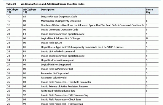

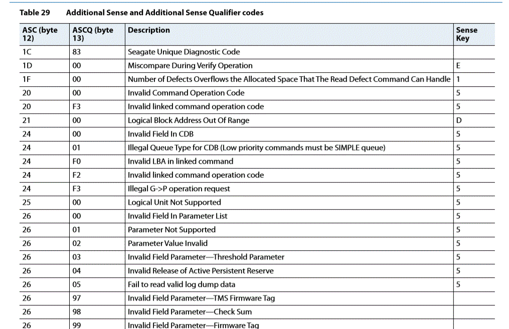

xdvst8x wrote:
Sense key: Illegal Request
ASC=26, vendor specific qualification ASCQ=98 (hex)
Write buffer failed: Illegal request sense key, apart from Invalid opcode
Just to elaborate on what has already been stated …
SCSI Commands Reference Manual, Fibre Channel (FC), Serial Attached SCSI (SAS):
https://www.seagate.com/files/staticfiles/support/docs/manual/Interface%20manuals/100293068k.pdf
ASC (byte 12)  ASCQ (byte 13)  Description                         Sense Key
26             98              Invalid Field Parameter—Check Sum   5
