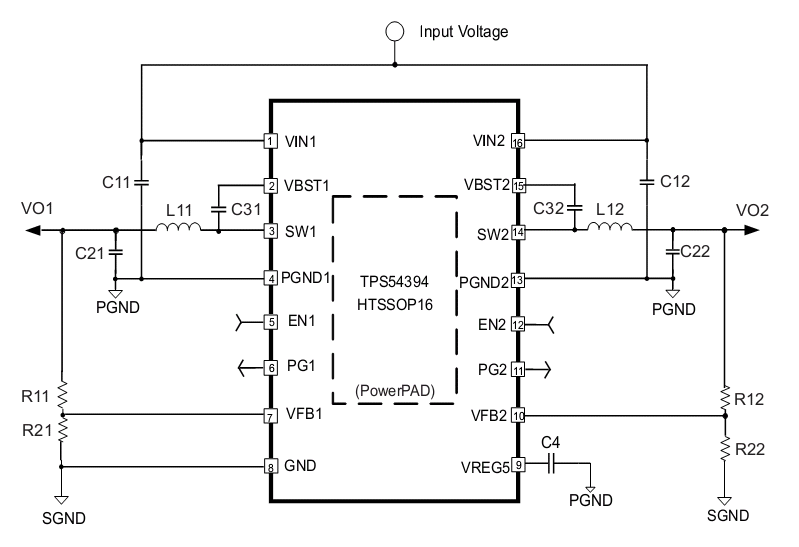

March 28th, 2018, 8:47
References:
APM4532, Anpec, Dual Enhancement Mode MOSFET (N-and P-Channel), 30V/5A, -30V/-3.5A:
http://www.anpec.com.tw/ashx_prod_file.ashx?prod_id=242&file_path=20081002153109520.pdf&original_name=APM4532K.pdf
http://www.audiolabga.com/pdf/APM4532K.pdf
TPS54339EDDA, Texas Instruments, marking 54339E, 4.5V - 23V Input, 3A, Synchronous Step-Down Converter:
http://www.ti.com/lit/ds/symlink/tps54339e.pdf
http://www.kynix.com/uploadfiles/pdf65976/TPS54339DDAR.pdf
W25X40AVNIG, Winbond, 4Mbit, SPI serial flash memory, 3.3V:
http://www.darisus.de/Elektonikshop/Datenblaetter/Winbond/W25X10A_W25X20A_W25X40A_W25X80A.pdf
W25X20CLVIG, Winbond, 2Mbit, 2.3V - 3.6V, SPI flash memory:
https://www.winbond.com/resource-files/w25x20cl_a02.pdf
RT8060A, Richtek, 1.5MHz, 1A High Efficiency Step-Down Converter, 2.7V - 5.5V in, SOT-23-5, marking 20=:
http://www.richtek.com/assets/product_file/RT8060A/DS8060A-00.pdf
JMicron JMS561 USB 3.0 to dual SATA III bridge:
http://www.jmicron.com/PDF/brief/jms561.pdf
http://img.hqew.com/file/Others/110000-119999/113018/Electronic/201581223388927288.pdf
ASMedia ASM1074 4-port USB3 hub:
http://www.asmedia.com.tw/eng/e_show_products.php?item=128
TPS54394, Texas Instruments, Dual Step-Down Switcher, 3A, 4.5V - 18V input, 0.76V - 7V out:
http://www.ti.com/lit/ds/symlink/tps54394.pdf
TPS2022D, Texas Instruments, marking 2022, 1.1A, 2.7-5.5V Single Power Distribution Switch IC Hi-Side MOSFET, Fault Report, Act-Low Enable, 8-pin:
http://www.ti.com/general/docs/lit/getl ... leType=pdf
http://www.farnell.com/datasheets/1831007.pdf
http://www.ti.com/lit/ug/slvu226b/slvu226b.pdf
