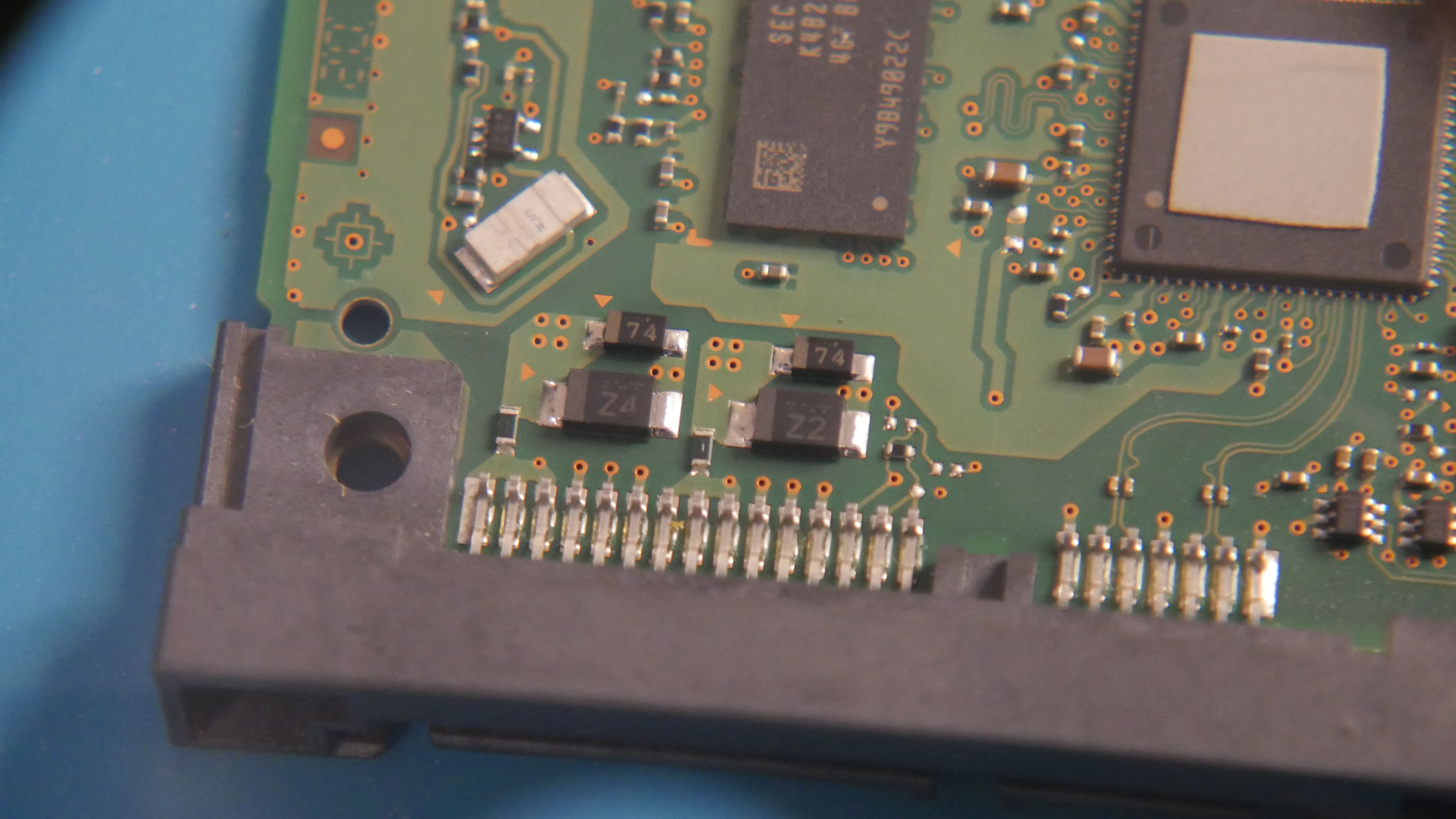

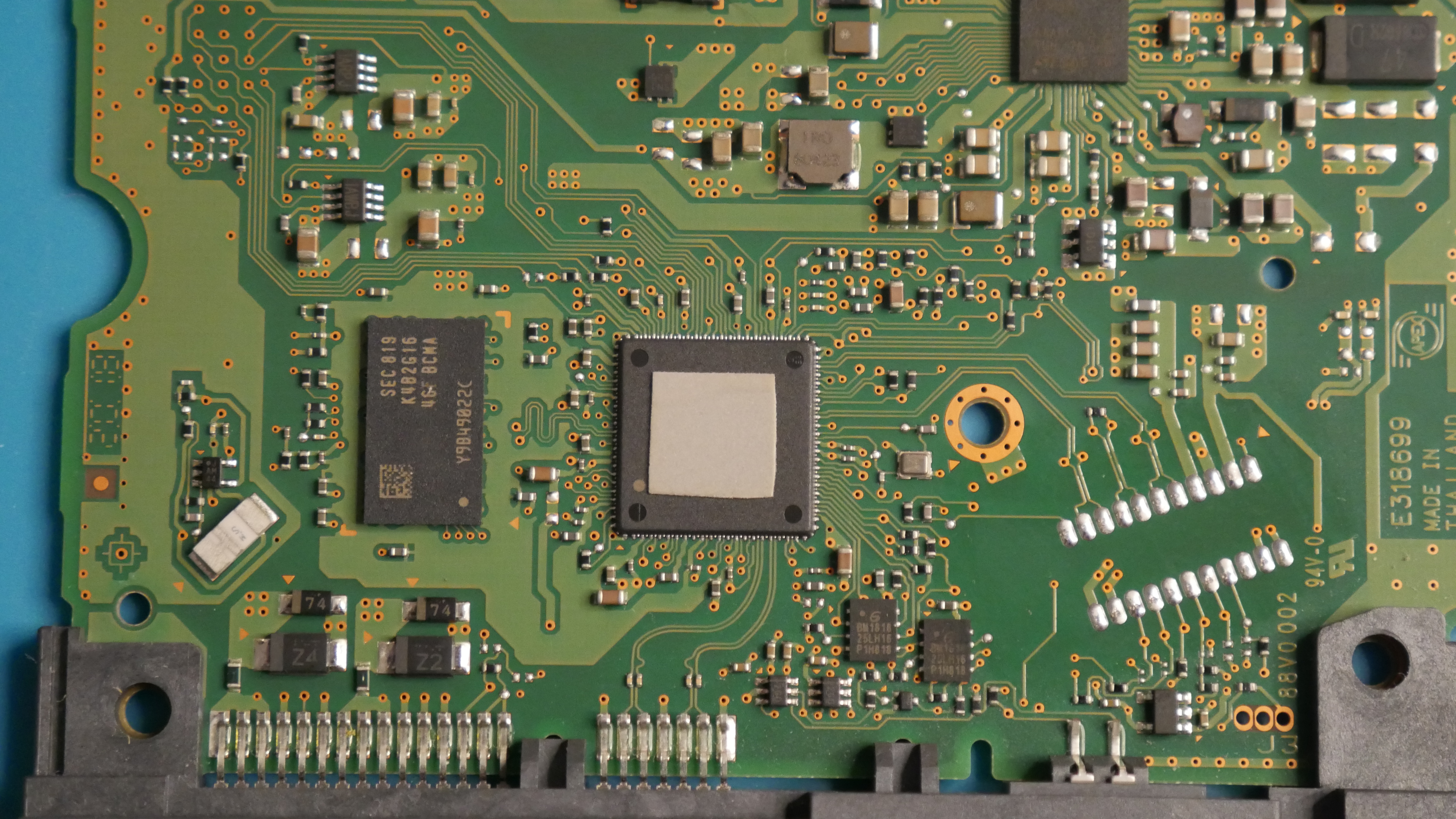

I made an account to get some help on this..
I was swapping my PSU and ended up frying both of my drives by forgetting to switch my SATA power cables. One SSD and another HDD. The SSD is currently in a data recovery center, and was a pretty penny, and I don't mess with SSD's all that much. However, I have this HDD which I don't really mind mangling with it too much, and I purchased a Donor board and waiting for that to deliver soon.
I'd like to know what to switch out from this to my donor so I can at least extract some data off this drive. Even if I have to run the drive without certain parts in place (I just don't know which one). I have the tools to perform this, I'm just not savvy for hard drive related stuff.
HDD Details
HDD Type: Western Digital 6TB WD Black Performance Internal Hard Drive HDD - 7200 RPM, SATA 6 Gb/s, 256 MB Cache, 3.5" - WD6003FZBX
PCB: 001-0B36131
https://files.catbox.moe/lpmdr7.JPG
https://files.catbox.moe/bppt0k.JPG
https://files.catbox.moe/5lgrw5.JPG
https://files.catbox.moe/52fz1v.JPG

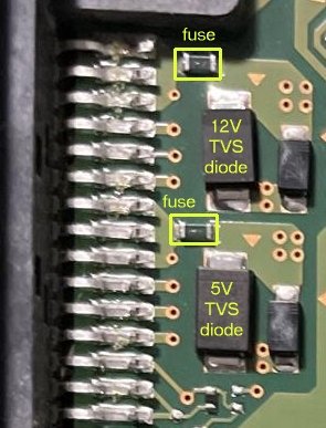

Start by measuring the resistances of the smt fuses and TVS diodes. If a diode is shorted, remove it. You can snip its pins with flush cutters.
Measure the resistances between ground and each of 5Vin, 12Vin, 5Vout, 12Vout.

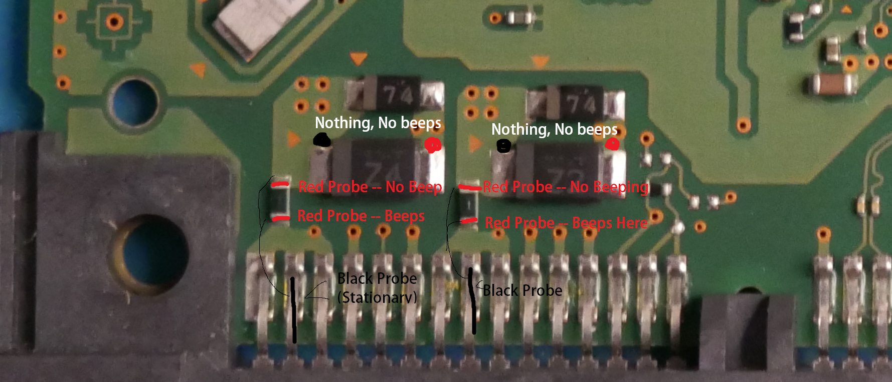

For the first picture, there is no activity or voltage coming through either the 5v in/out and 12v in/out. No beeps.
For the smt fuses, it looks like it only beeps in one direction but not the other. I'm not sure if I'm using my probes right, so I made a picture of what I did.
https://files.catbox.moe/eaa59k.png
 Post subject: Re: 6TB WD Black -- WD6003FZBX Repair Help
PostPosted: June 19th, 2024, 17:17
Posts: 17336
Both fuses are open. That's unusual. Now check the resistances of the two TVS diodes, Z2 and Z4.
PostPosted: June 19th, 2024, 17:56
Joined: June 18th, 2024, 17:47
Posts: 8
I removed both TVS diodes to test them individually and with my black probe in the line side and red on the other I got 0.6 for both.
PostPosted: June 19th, 2024, 19:55
Posts: 17336
Is that 0.6 ohms on the 200 ohms scale, or is that 0.6V on the diode range? If it's 0.6 ohms, then both diodes are shorted.
PostPosted: June 19th, 2024, 20:05
Posts: 8
It shows 0.6V on the Diode Test mode on my Multimeter. When switching to OHMS, it shows 0L.
PostPosted: June 19th, 2024, 20:45
Posts: 17336
That means the diodes are OK and that the fuses are probably the only faults.
The best thing to do would be to replace the fuses and reinstall the diodes. However, if there are no other problems, you can flow a blob of solder over each fuse. It all depends on what you are comfortable with. You don't need to reinstall the diodes, but you will be without continued protection if you don't.
PostPosted: June 19th, 2024, 22:32
Posts: 8
Okay so I reinstalled the diodes back in to their respective positions. But Z2 has issues still so I removed both diodes again and blob'd over each fuse like you said. And the drive works! (For now). I'm going to clone the disk to a new HDD I purchased, then replace the diodes at some point later on and keep the drive for misc data.
