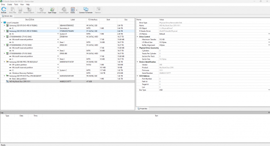

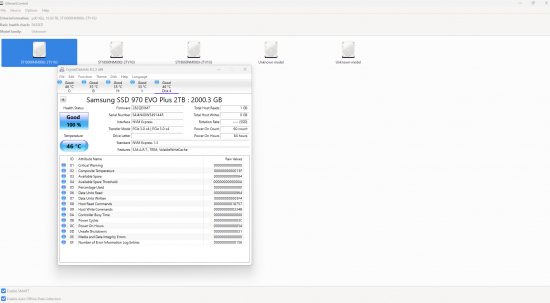

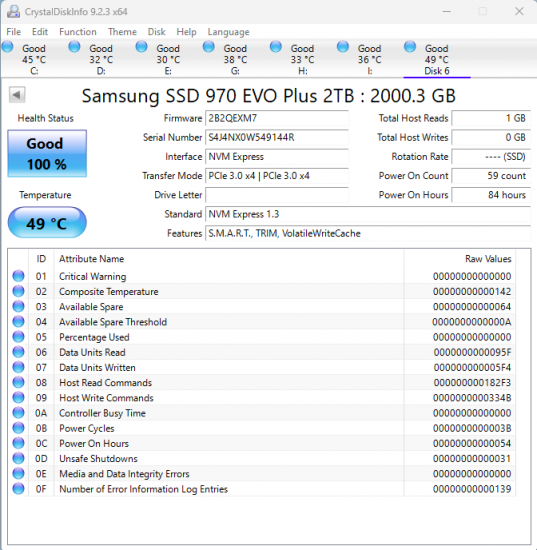

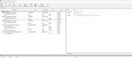

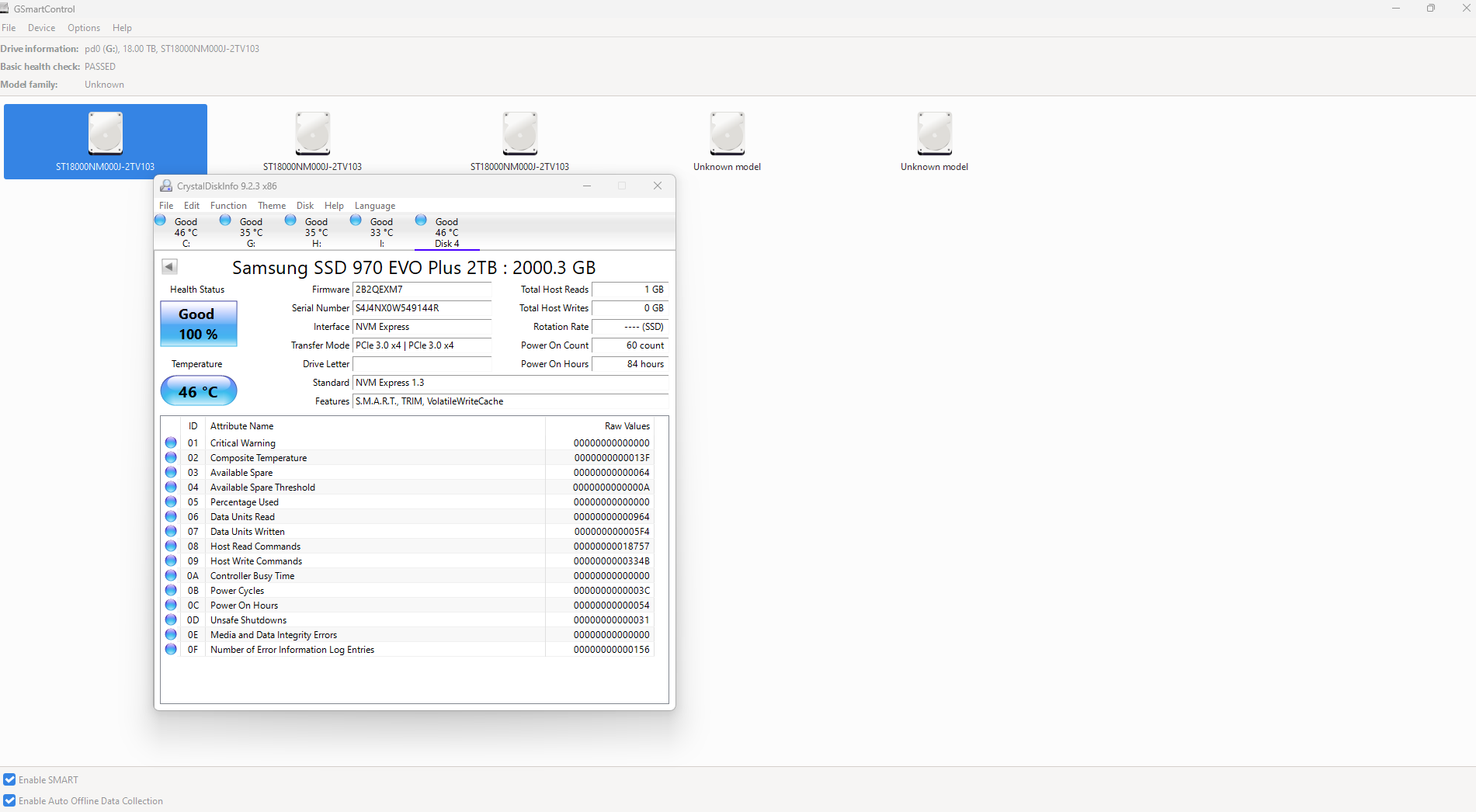

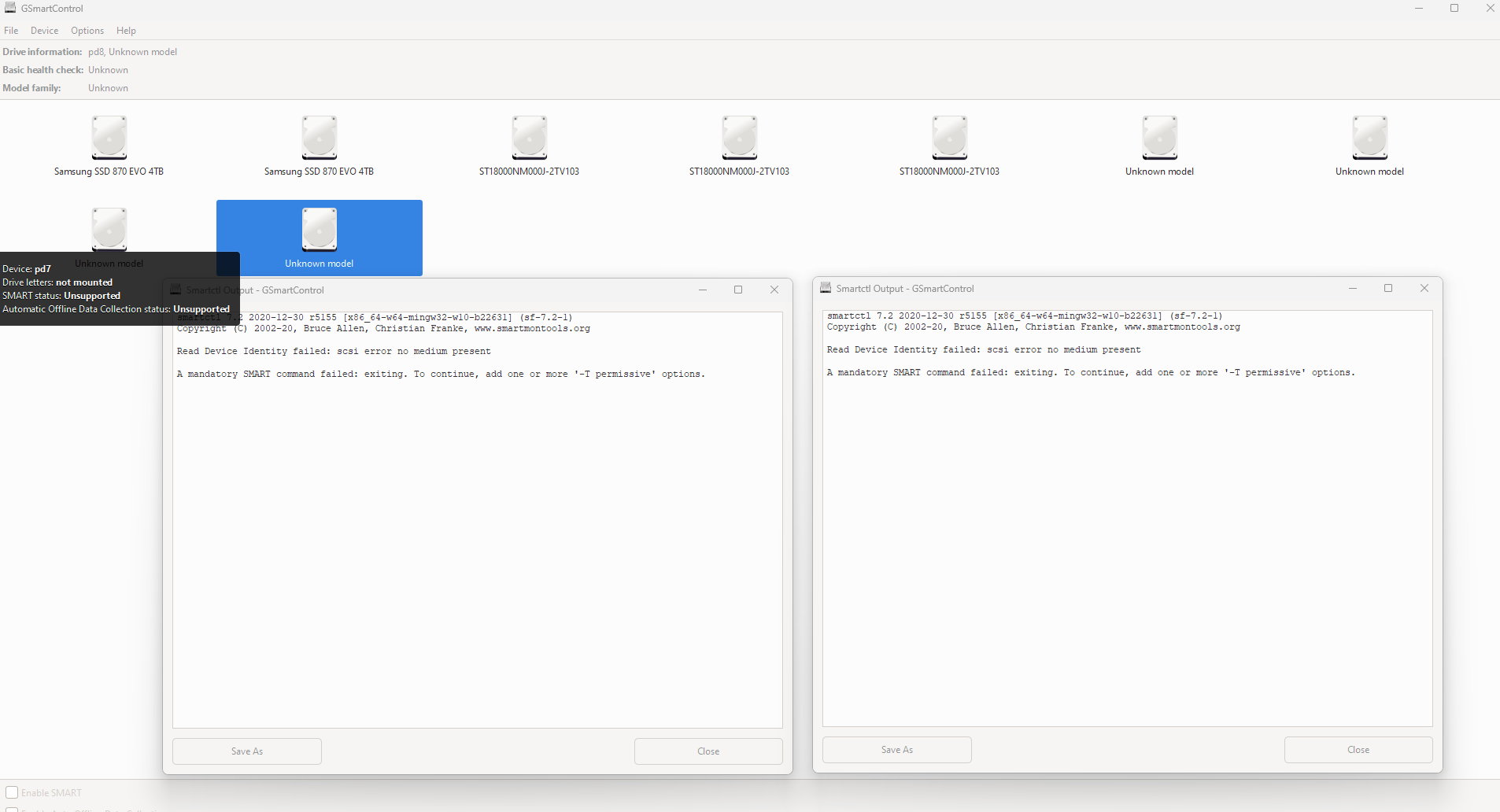

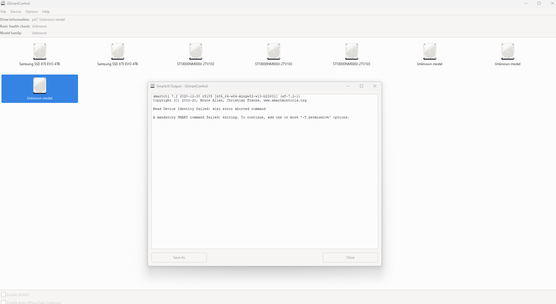

there is to few information on the 3 softwares in the article, in the CrystalDiskInfo the app didn't detect the hard drive at all, about your question if it is set as 14TB or 28TB I don't know how to get this information.
thanks for the replay

You need to remove each drive from the Duo and test it inside your computer. Keep a record of the drive order inside the Duo.
Since you were unable to answer my RAID 0/1 question, I suspect that you would probably be best advised to engage a pro service.

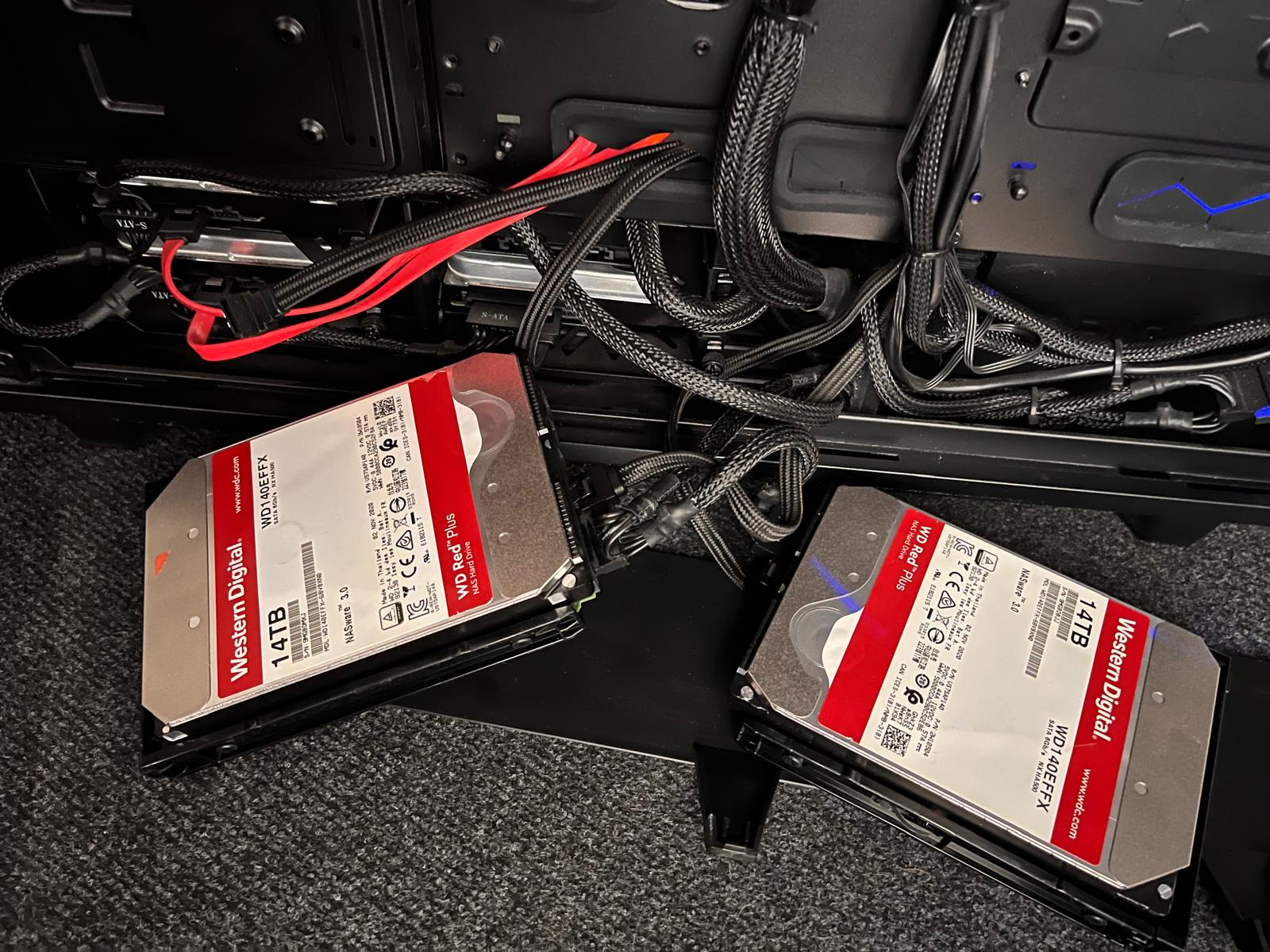

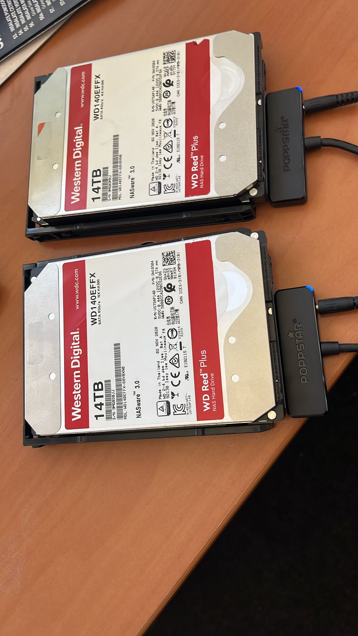

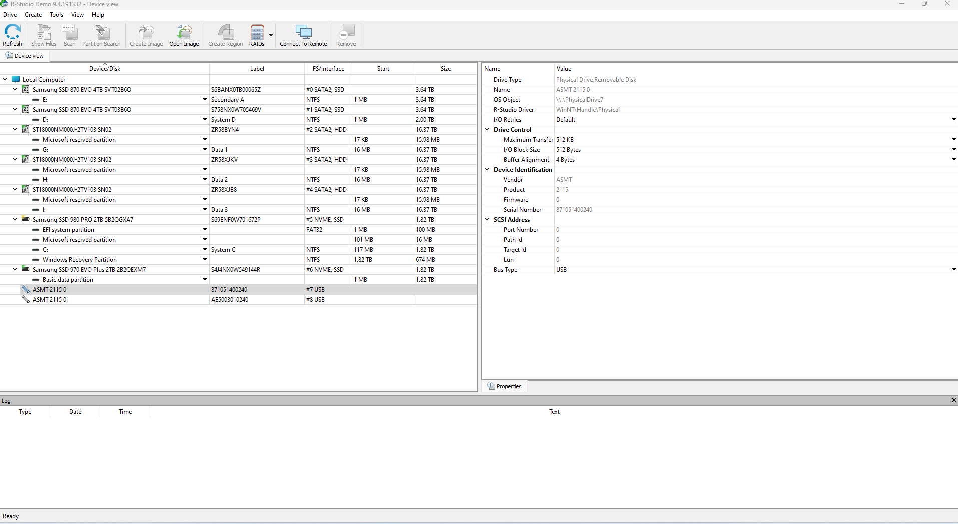

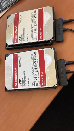

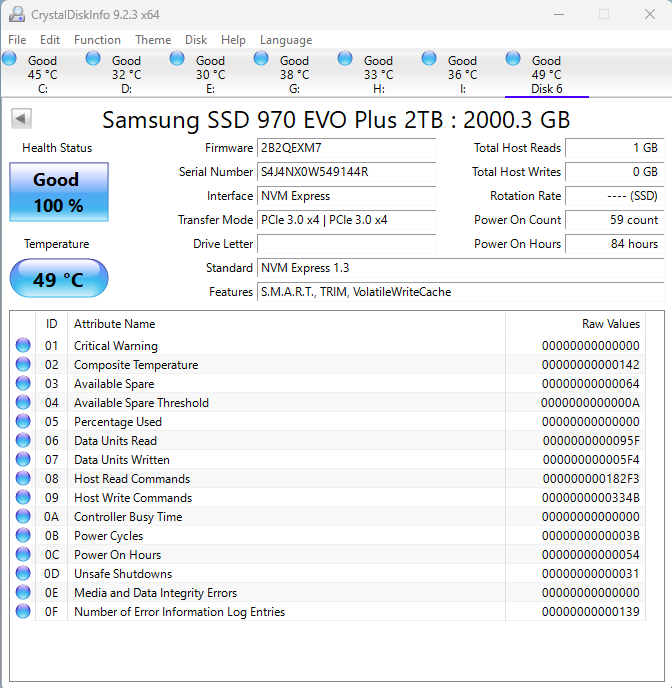

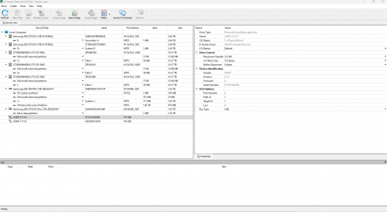

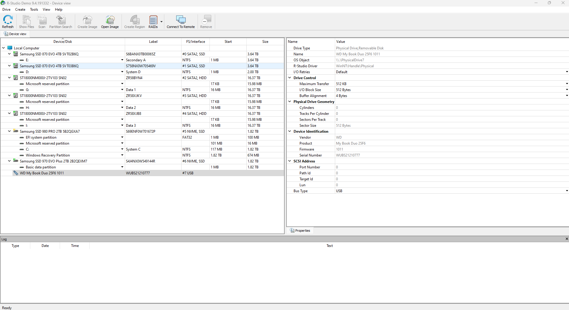

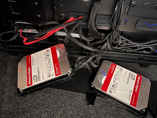

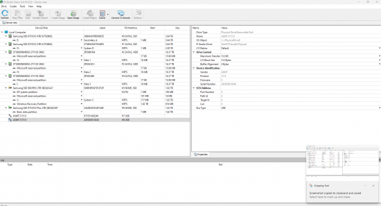

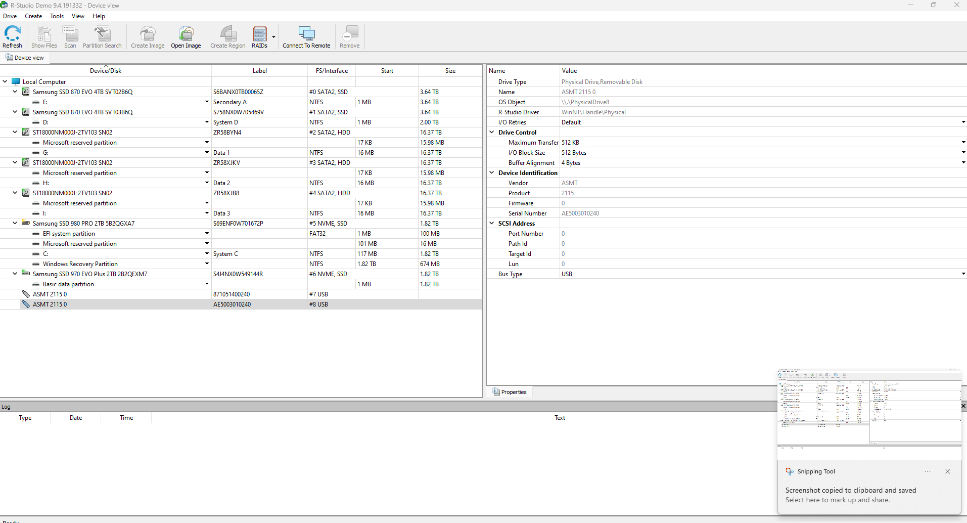

I connected the drives separatly to the PC, as in the photo
in the CrystalDiskInfo no drives are detected, on the other 2 apps they are detected but no information are shown

 Post subject: Re: WD My Book Duo is totally offline
PostPosted: July 7th, 2024, 9:19
Posts: 1748
Use direct SATA cables to your PC.

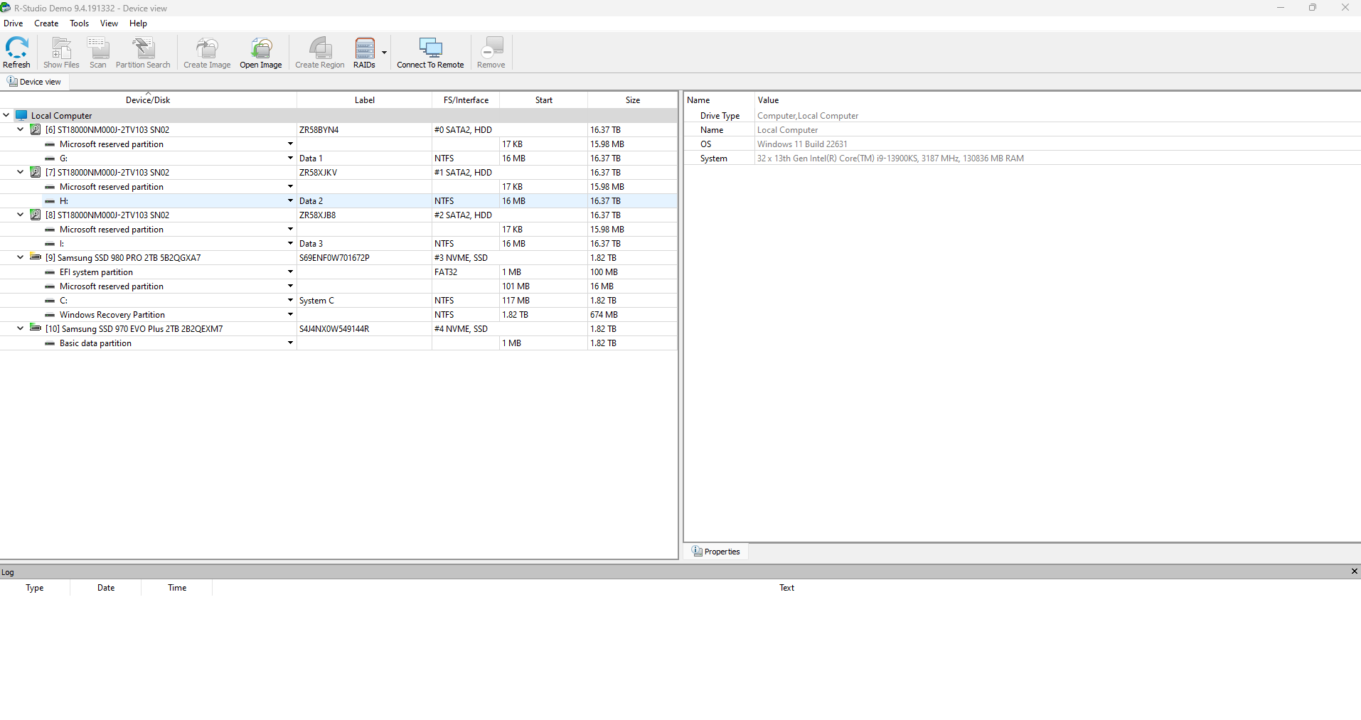

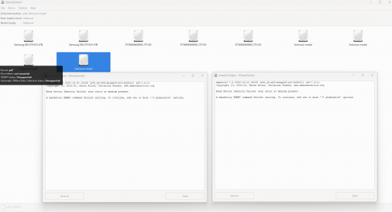

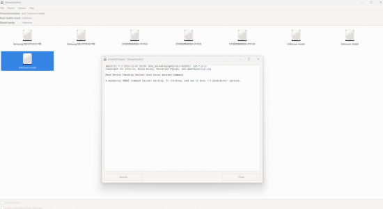

I did, but no hard drives are detected at all on all apps :cry:

Do the drives spin up?
PostPosted: July 7th, 2024, 16:02
Joined: January 14th, 2024, 9:15
Posts: 8
Location: Germany
No, I don't think so, no sound is coming from the hards
PostPosted: July 7th, 2024, 16:08
Posts: 17336

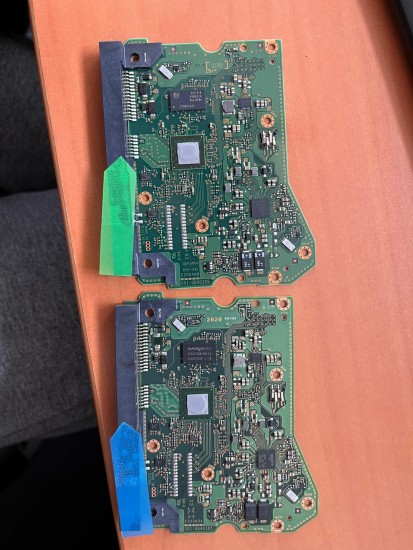

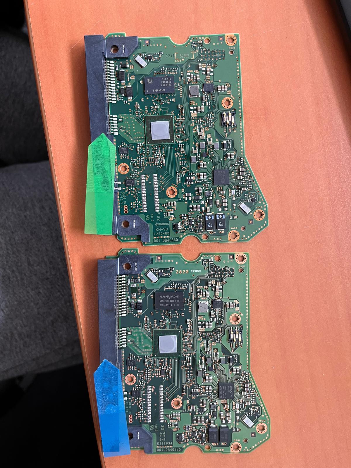

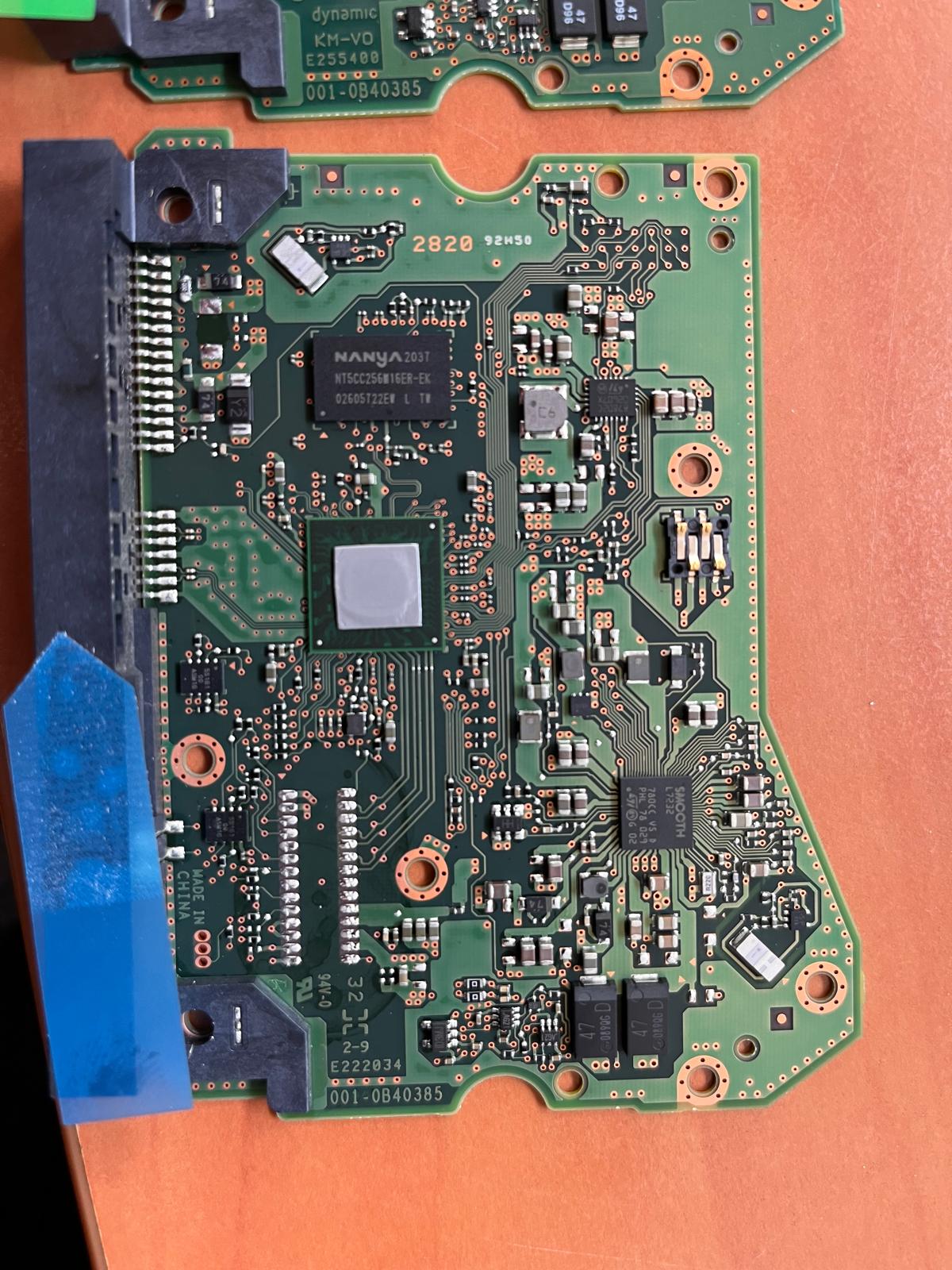

Then it appears that your drives have PCB faults. Can you remove the PCBs and provide photos of the component side?
PostPosted: July 8th, 2024, 2:47
Posts: 8
Location: Germany

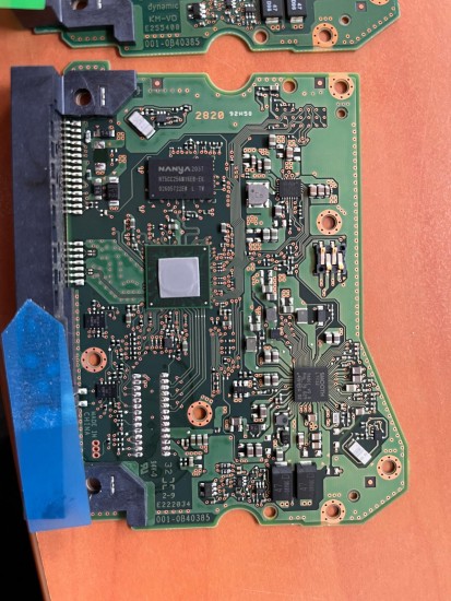

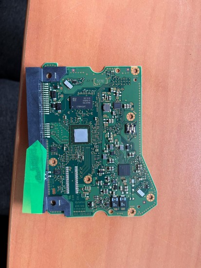

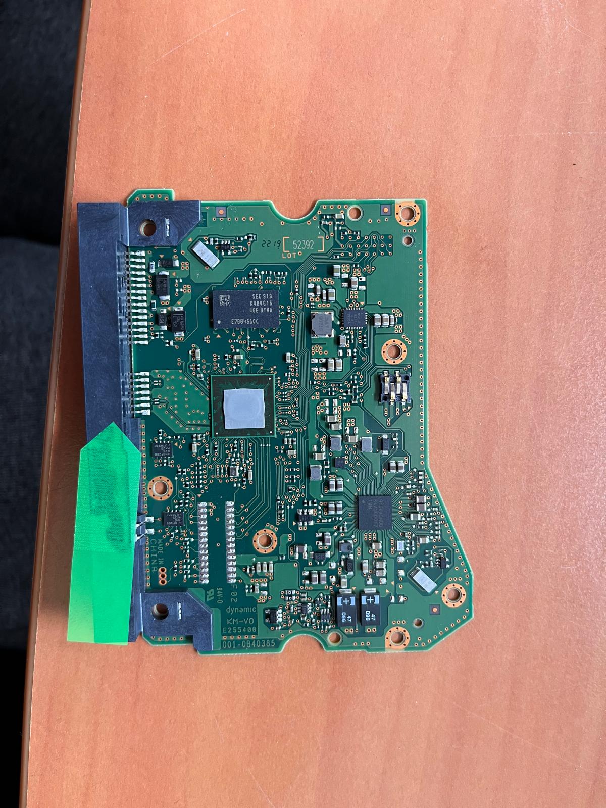

like this? if the PCB is damaged, replacing it would be enough? or other things matters like the ROM or other parts

If it were RAID 1, then it would be only 14GB volume which is a mirrored disk and only one needs to be recovered.
If it's RAID 0, then it would be 28GB and makes it harder as both will need to be recovered.

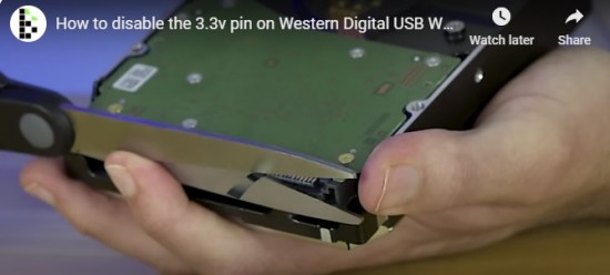

Some WD White Label large TB drives can't be plugged into normal PC PSU and need the 3.3v pin on the SATA power connector masked to work..
I don't know if this is the issue here, as Fzabkar says, it sounds like the PCBs are faulty.

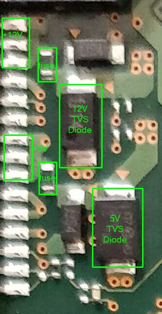

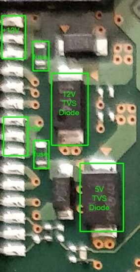

Check the TVS diodes and fuses.
TVS Diode FAQ:

Thanks for the help, fzabkar.
A friend of mine tested the components based on your article and confirmed issues with the diodes and one of the fuses. On one of the PCBs, the 12V diode is completely missing.
Unfortunately, my friend is not qualified to replace them, so he suggested purchasing new PCBs. Based on your experience, are there any parts that need to be transferred from the old PCBs to the new ones? and is buying new PCBs is a good idea in the first place?
Thanks again for your help. You've given me hope, and I can't thank you enough.
PostPosted: July 9th, 2024, 13:39
Posts: 17336
It would be much safer to replace the diodes and/or fuses rather than transferring the ROMs.
Which components were faulty? This is important, as this will point to the power source as the culprit. If you continue to use the same power source, you may damage other HDDs.

Drives are fine. Need to isolate 3,3V pin (common for wd/hgst removed from ...)
After that, need to decrypt data-space (JM561 bridge) and assemble virtual raid. Raid1 or raid0
