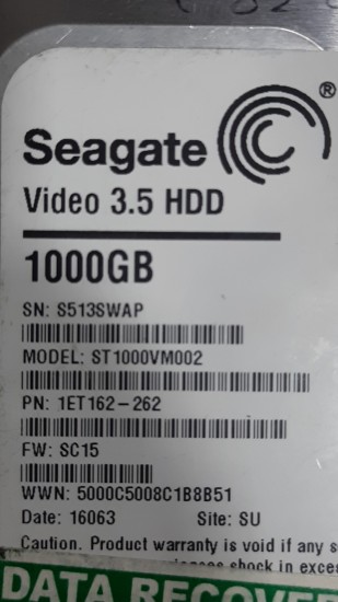

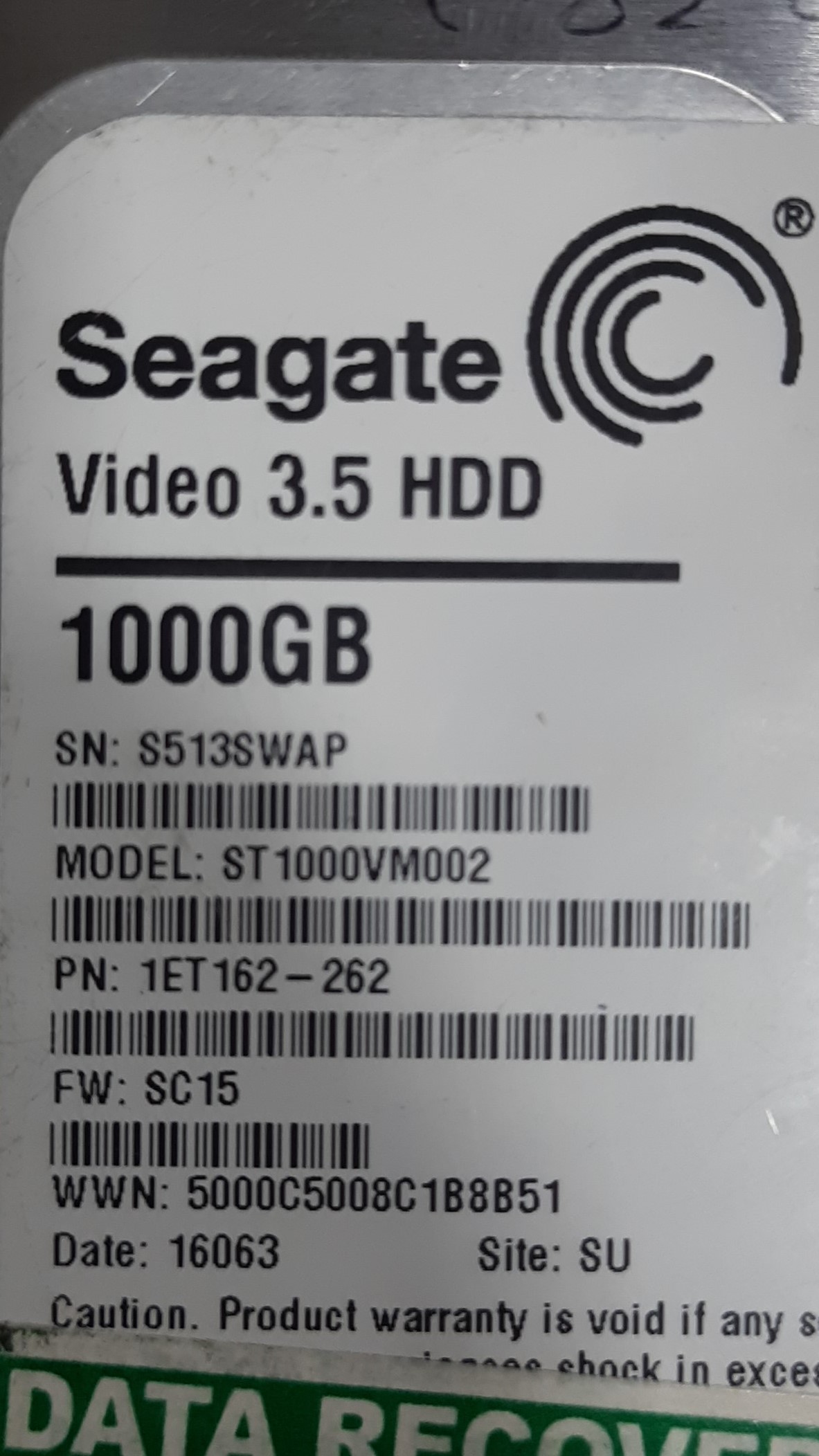

Required donor rom for ST1000VM002 1ET162-262 F/W : SC15
November 12th, 2024, 4:58
Hi does any 1 has donor rom for Seagate 1TB Model ST1000VM002 P/N 1ET162-262 F/W : SC15 Its Bacall Family
