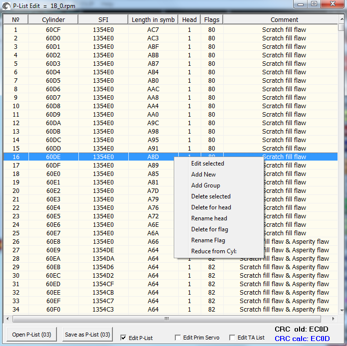

 Post subject: Re: Seagate ST2000DM001-1E6164 sys file 03x1B checksum
PostPosted: July 18th, 2024, 15:17
Posts: 347
Location: Eastern Europe
If anyone can share a resource from LM007, I would be grateful.
In my SG program in editor 1B there are no such table offsets.
When I abandoned my program, there were no such resources yet...
Sorry for the interruption...
PostPosted: July 20th, 2024, 14:55
Posts: 347
"Thank you!" No longer necessary. :lol:
PostPosted: July 21st, 2024, 11:17
Posts: 347
Thank you! No need to. I found from LM035, and your 1B is quite good.
