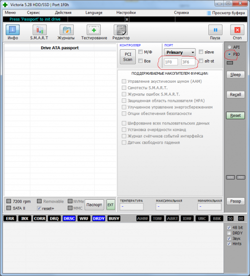

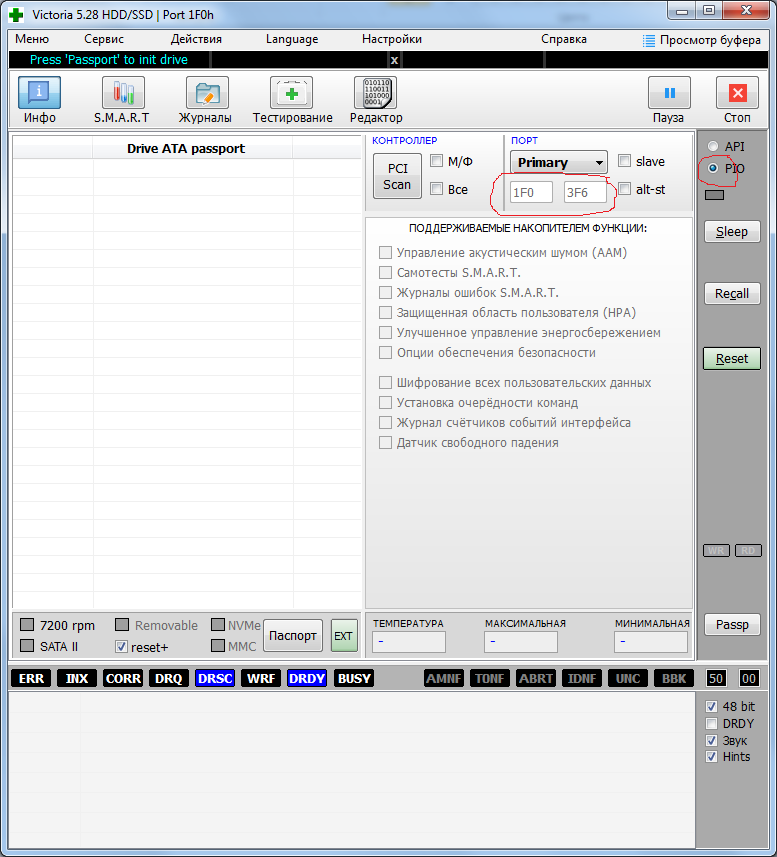

First of all, I would like to see a picture of the passport in the PIO mode in the Victoria program...
I still don't understand where and how the HDD is connected. :?

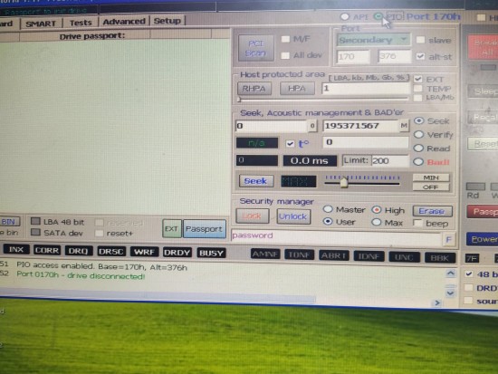

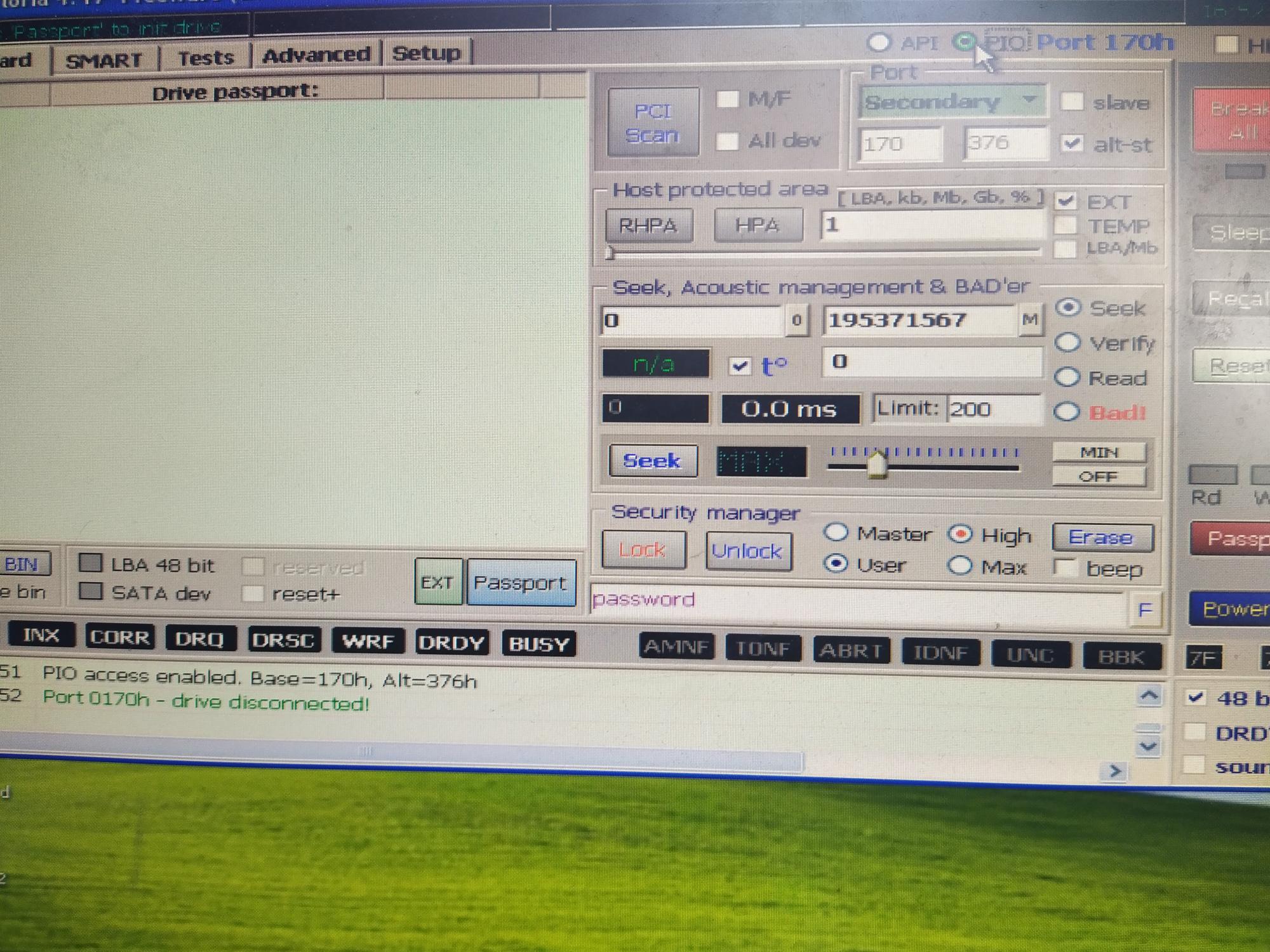

It seems like this board (gigabyte) doesn't like password locked HDD's when booting into XP, but has no problem booting into DOS. Tried a different mainboard (this time, an ASUS which detects SATA as SATA). In PIO mode, I get 170h on BASE, 376h on ALT, same as on the gigabyte (without the fujitsu HDD). I'm also getting Port 0170h - drive disconnected!
