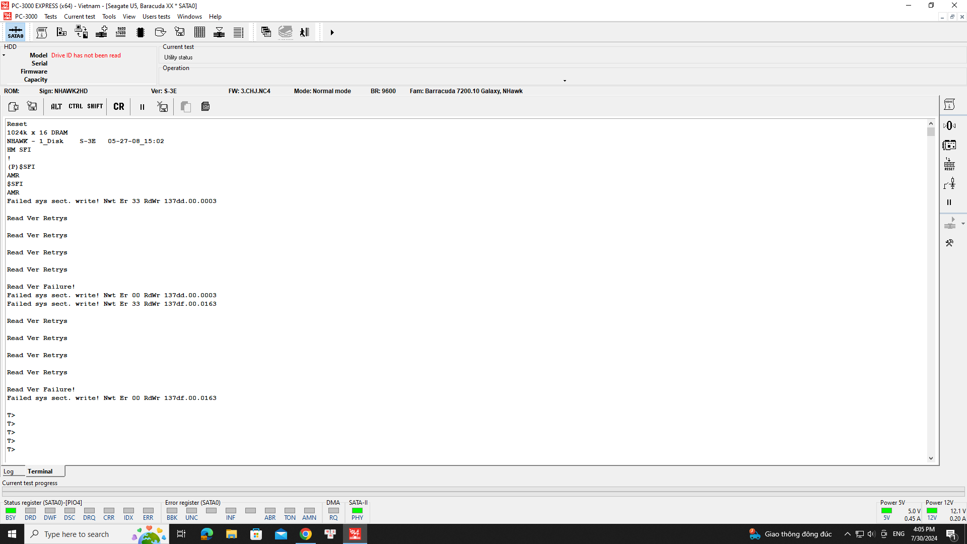

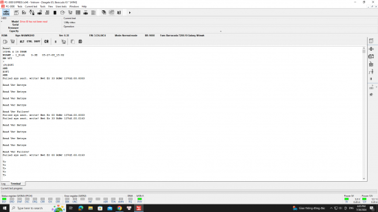

PostPosted: July 30th, 2024, 5:09
Posts: 261
Location: Vietnam
Got a 160GB one. With same problem. Drive was spinning but stayed busy. After swapping both Heads and PCB this are the logs
