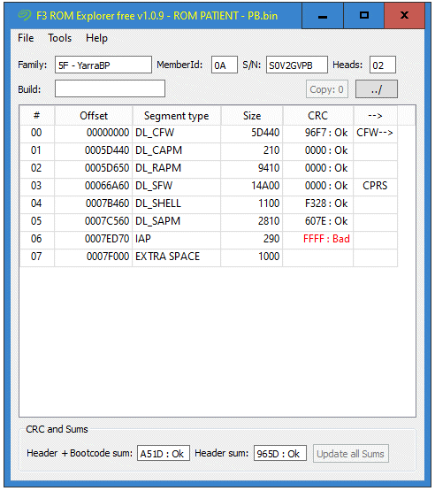

Can anyone help provide a ROM of a Seagate ST500LT012 HDD drive with the below characteristics?
Model ID..................: ST500LT012-1DG142
FW........................: 0001SDM1
Fam ID................... : 0x5F (Yarra1D)
Servo FW rev code........ : 0xA487
I'm trying to patch a ROM with the same Model ST500LT012-1DG142 and sale FW 0001SDM1 but a different Servo rev code, but unfortunately, it is not working.
I need the exact Servo code. I searched on the hddsurgery.com database, but unfortunately, I didn't find it (most of the drives are recent).
My Patient drive DOM is 06-2013
Thank you in advance for your help

 Post subject: Re: ROM Ressources for ST500LT012 drive
PostPosted: July 30th, 2024, 3:12
Joined: September 7th, 2012, 16:37
Posts: 198
Please find attached the corrupt ROM. The drive was working fine, then after an electrical surge problem, the drive stop working.
I thought it was a PCB problem, so I changed the PCB and transferred the ROM but the problem remained.
I contacted PC3000 support and they suggested correcting the ROM with a donor that has the same HDD Model/FW/Servo Rev (which I don't have).
ROM PATIENT - PB.rar [449.64 KiB]
Downloaded 207 times
PostPosted: July 30th, 2024, 10:46
Posts: 198
@SWM
Thank you very much. It was a compatible ROM, I transferred the adaptive data, and the ROM issue was fixed.
But it looks like the electrical surge damaged the ROM/PCB/+ the heads.
I need to transfer the heads to see if the problem is resolved.
Thank you for your help
PostPosted: July 30th, 2024, 11:55
Posts: 17342
F3RomExplorer doesn't find a problem with the patient ROM. :-?
