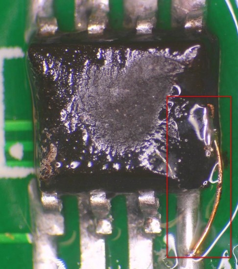

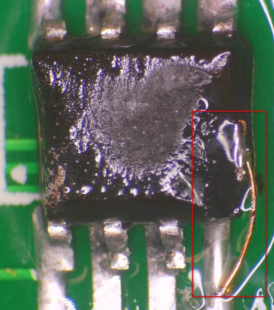

Seriously guys, this was still readable with some work...
Wow...

Did someone bring this to you because they damaged it with very bad soldering skills? and you had to fix it with that jumper wire?

I would exempt the word "skills"; but yes.
I've never seen a ROM module so puffed up and still readable.

Yeah thats a crime scene but well done for getting it to work again.
