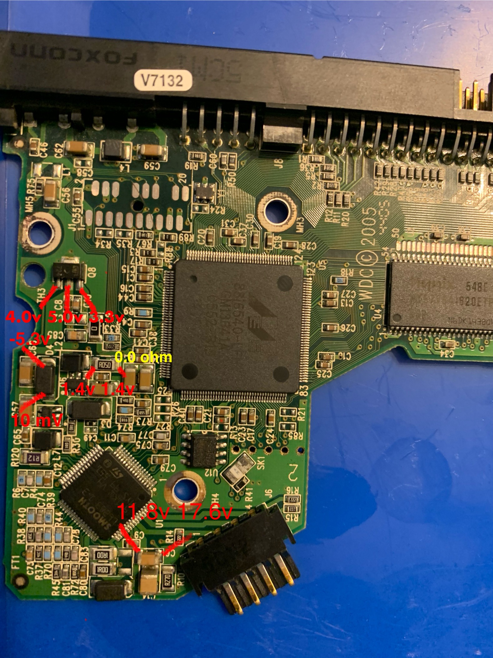

I suspect the SA is no longer readable as the drive spins up and "clicks". Has been progressively failing to detect in BIOS over the past few resets. Was reading extremely slow when it was last detected a month ago, with just a few bad sectors, but data was being read OK. Now appears "blank" in BIOS. ROM reads fine.
Using scraped-together tools (non-PC3K/MRT/etc.) calling WD VSC ATA commands gained access, so it would be great to send over firmware while in safe mode to see if the unit can read again.
Yes, the drive is old and replacements are cheap. It's the contents of the drive I'm after. Non-critical but like-to-have items, plus it's a learning experience for me.

If the MCU is getting hot, measure the Vcore and Vio voltages.

Tested PCB alone, no temperature issues. Same in safe mode. Seems to draw nominal wattage while (attempting) to seek/read, gets very hot while motor/heads are active.
Also, was asked to check voltages to some chips; I am unable to find official schematics and don't want to be guessing that pin1 is Vcc on each.

When you find "official schematics", please tell the world. As for "guessing that pin1 is Vcc on each", I have no idea what you are talking about. I'm asking for the Vcc and Vio supply voltages (Q8 and R050). C6 and D4 are the -5V preamp supply.

My apologies, I thought you were referring to the microchips’ voltages.
I’ve attached an image with values requested and some additional I found on another forum post of a similar drive troubleshooting
This is drive not attached and with ground on the molex cable. Hope this is useful.

-5V and +3.3V are OK. I think there was a similar PCB in another thread where the researcher measured +1.37 as the Vcore. In short, I think these voltages may be OK.
https://forum.hddguru.com/viewtopic.php?p=298644#p298644

I checked a few other resistors mentioned in that thread, mine seem okay.
I'm thinking these heads are trash. That's why I asked for firmware because of the three times (over the course of the last year) that it did detect on the PC, I was able to read _something_, albeit with tons of random read errors. My thought is that it's read erroring the service area on power up, and that I might be able to bootstrap it's detection and continue to rescue the data.
