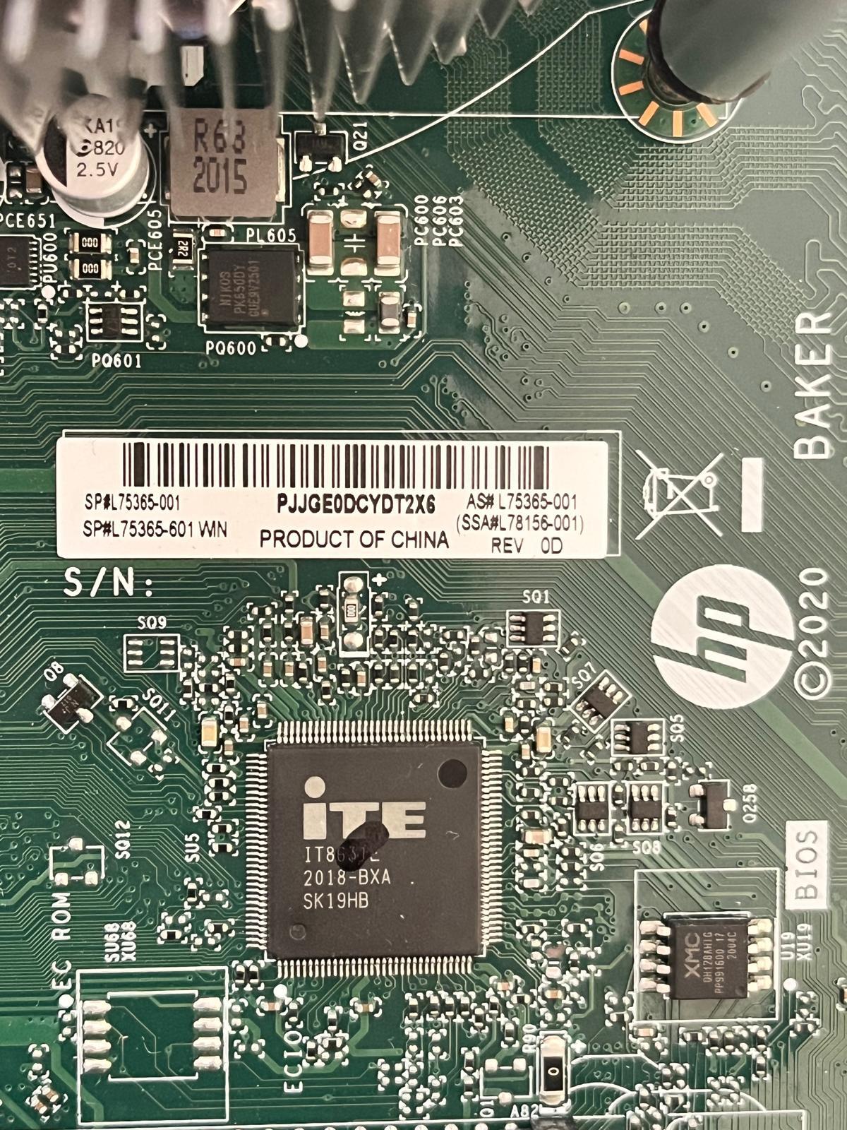

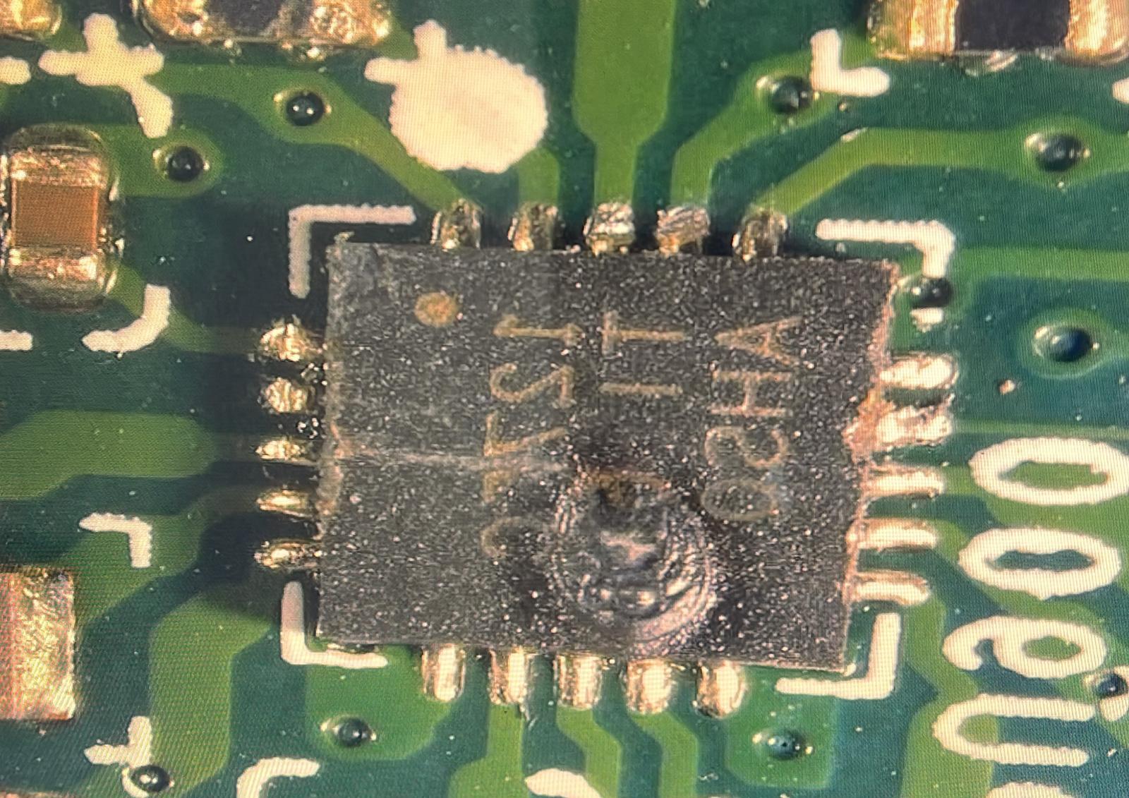

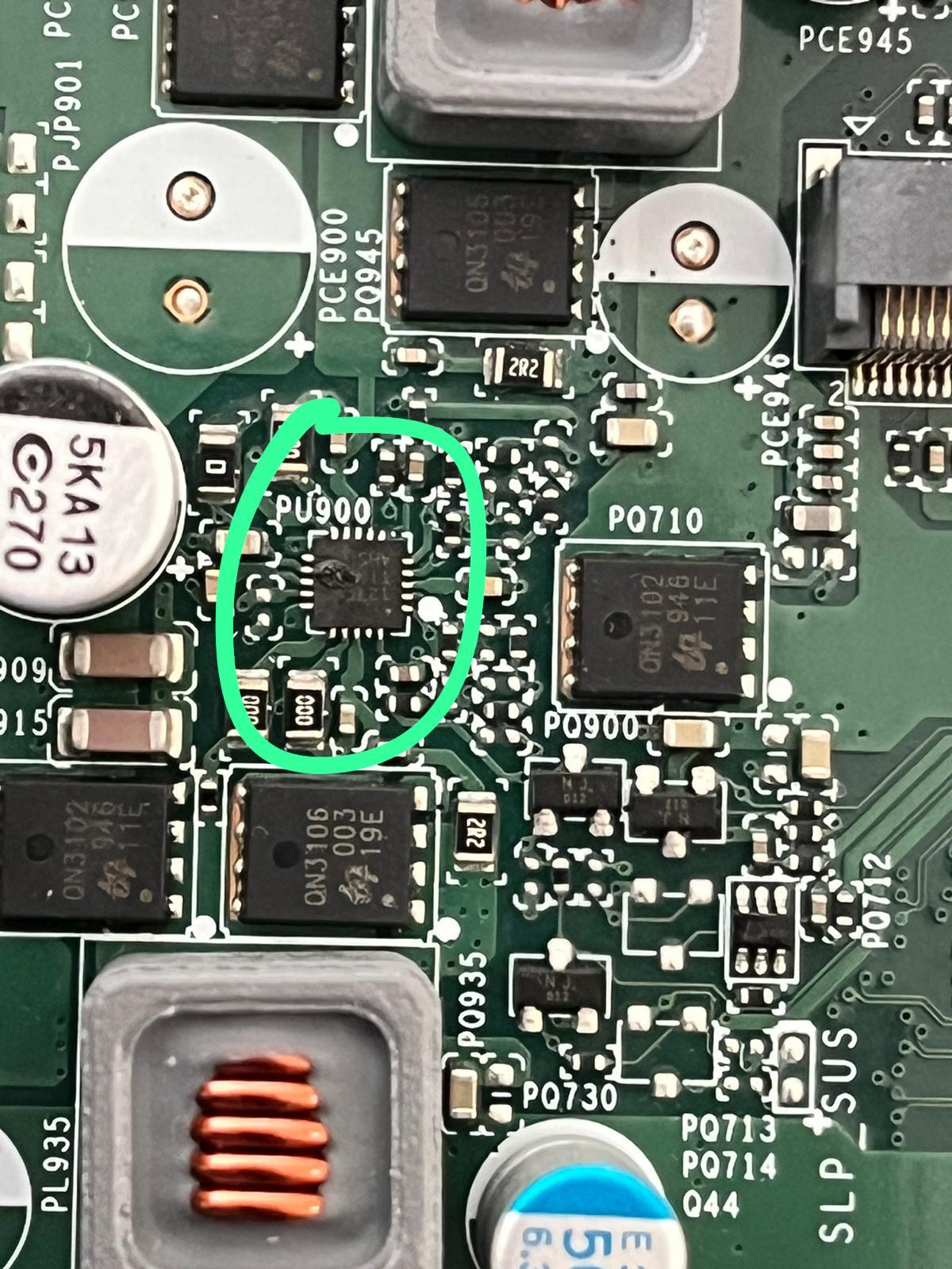

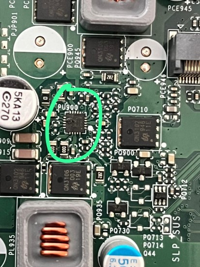

I know it's not directly related to HDD but if somone can help me identify this burnt IC on my motherboard. I've posted on other forum but no answer.
I've search here http://markingcodes.com/search/c/ld but the marking is odd, I can't find anything. I beleive it's a Mosfet QFN 20. ID burned after a stor/ligntening. Now PC start for one seconds and stop.

https://www.ti.com/packaging/en/docs/partlookup.tsp?partmarking=127
Probably "1275C", in which case a TPS51275C.
https://www.ti.com/lit/gpn/tps51275c
Also ...
http://markingcodes.com/search/c/1275c
http://markingcodes.com/search/c/127 (third page)

I would check the MOSFETs as well.
https://qinwei.haoduomoban.com/uploads/20240713/c64ac59a78b8960c746852126f610337.pdf (QN3102M6N)
https://datasheet.sisoog.com/file/7a657573/datasheet/0b6d71c35b68d1e65d0f6807a81f04c16f9f7983.pdf (QN3106M6N)
