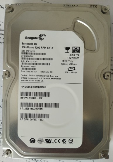

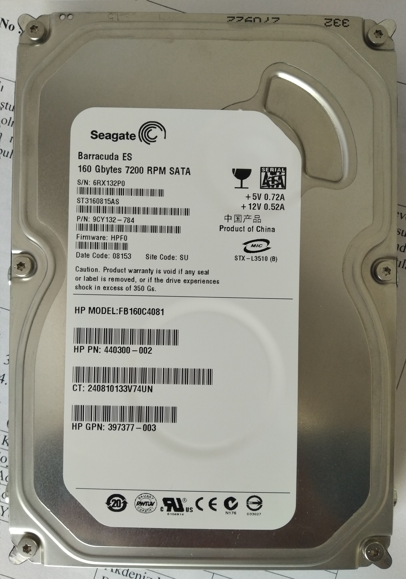

Hi Guys.
I got a Seagate HDD salvaged from an old HP Server case. When I connect the disk to my PC's SATA port, it is not shown in Windows' disk management console. When I check in the device manager, I see an unknown device (yellow exclamation mark) named FB160C4081. (This device is definitely this HDD because it disappears when I remove the disk.)
When I double-click it and look at the VID/PID values, it says /SCSI/FB160C4081.
When I connect the same disk to my PC with a cheap Chinese USB-SATA cable, the PC detects the disk without any problems. It shows the files in it.
Why can't I access the disk when I connect it directly with a SATA cable? Can I fix the problem by flashing Generic Seagate firmware to this disk?

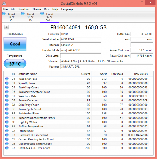

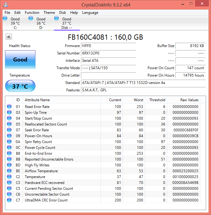

Bios detected as FB160C4081. CrystalDiskInfo detected this disk, and shows Smart information.

Looks correct to me. HP are using a custom model name for this model.
