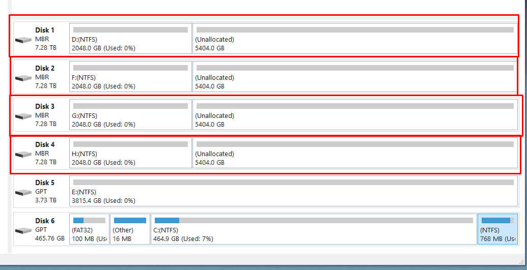

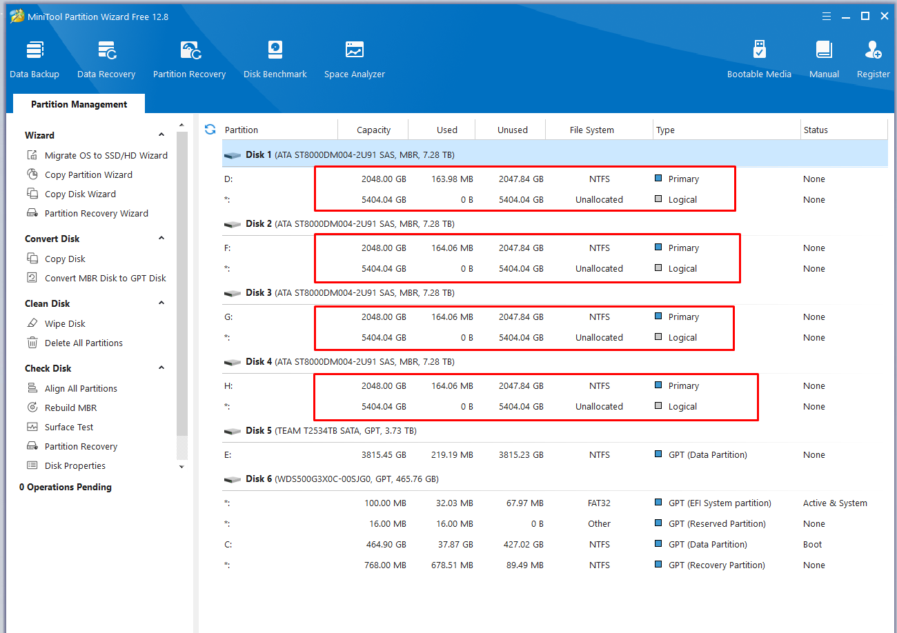

:| I have 4 Harddrive and One SSD with the same situation after using my hard drive with Linux and having my hard drive with Raid10, I don't know a lot about hard drives, and I'm trying to know if it is fixable with a partition manager
I have my SSD acting like 5 different SSDs so I only have one Disk but it showing in Windows as 5 disks, 4 with the same serial and one Samsung name and code.
On the other hand, I have 4 hard Disks 8TB each with a 2 TB partition and 6 TB partition, I cannot extend I cannot delete them.
Anybody here can explain to me what I did wrong and if this is an easy fix?
Show DMDE partition TAB for this one.
You mean you can not delete the unallocated portion? That's because it's un allocated, there's nothing to delete. For drives > 2 TB you MUST create GPT style partitions (rather than MBR like you did).
