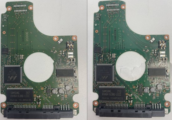

 Post subject: Re: ST1000LM024 NOT SPINNING
PostPosted: September 3rd, 2024, 6:11
Posts: 17228
Sorry if I'm stating the obvious, but are you aware that there are two different PCBs for this model?
https://recuperodatos.com/sites/default/files/webform/donantes/01147-PCB.jpg (BF41-00354A)
https://recuperodatos.com/sites/default/files/webform/donantes/01318-PCB.jpg (100720903)

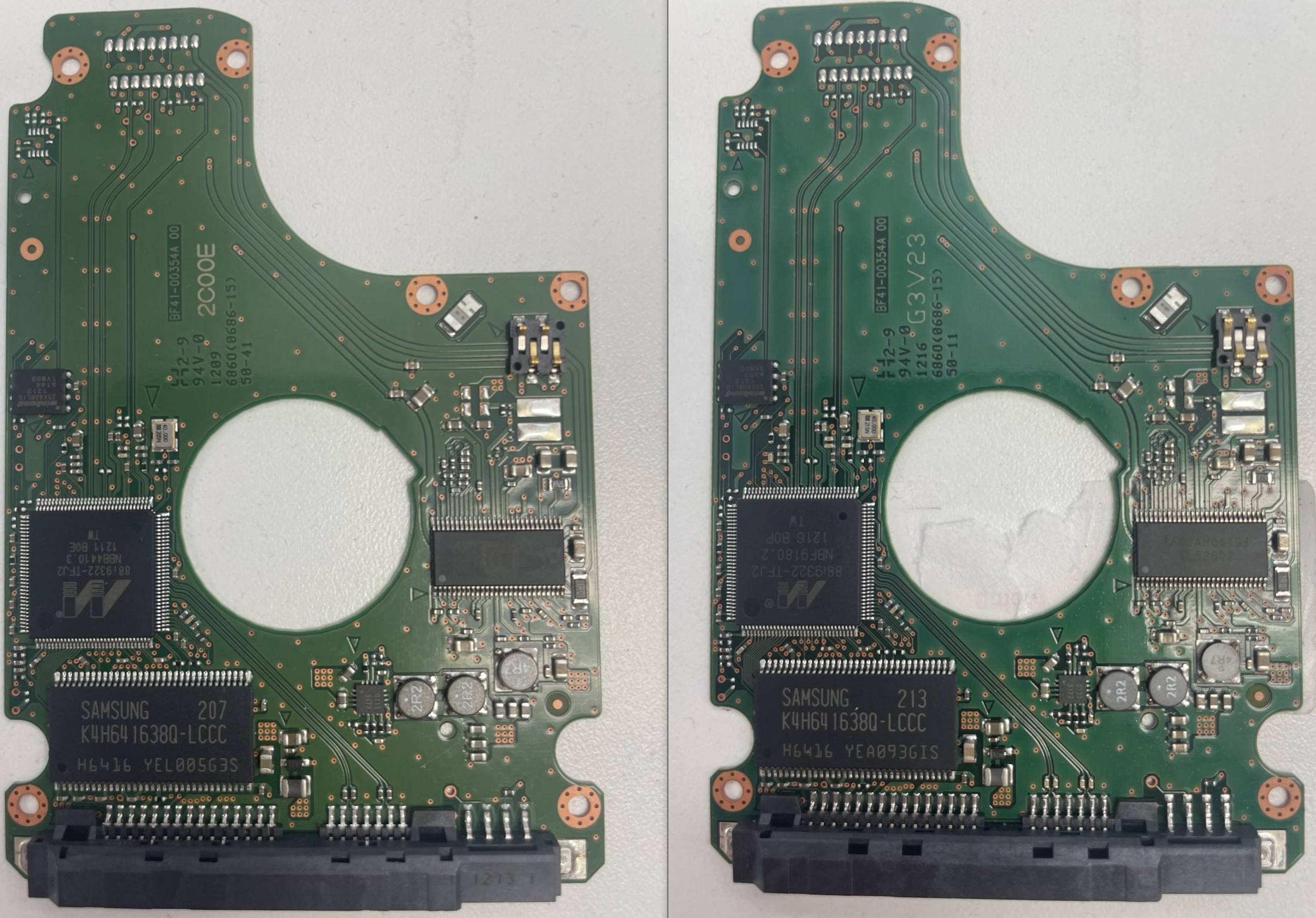

PostPosted: September 6th, 2024, 3:28
Joined: January 23rd, 2008, 2:28
Posts: 11
Thank you! Yes, I moved the ROM from the patient to the donor PCB using the same model. I will double-check again just to be certain, but I do believe I checked that.
Left is the donor, right is the patient.
Wasn't able to get the log file, but will try again tomorrow.
Thank you again!
I'm always learning...
== A goal properly set is halfway reached ==
PostPosted: September 7th, 2024, 16:30
Posts: 17228
Measure the voltage at the 5V TVS diode. There is an inductor between the diode and SATA +5V. Samsung's soldering has been affected by dry joints in other models, so this would be something to check.
Also measure the voltages between ground and the 2R2 and 4R7 inductors.
Apologies for the late response. Been away with kids. For some reason, the forum didn't send me the notification, and I thought there wasn't a reply. :) Sorry.
I will check that this week and respond with the findings. Thank you so very much for your time! I really appreciate you are helping so many people here.
Best wishes!
