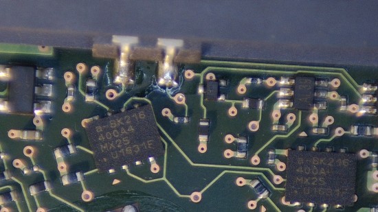

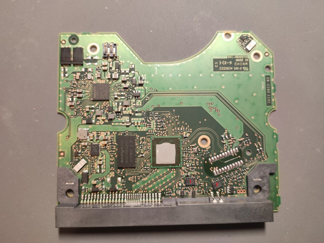

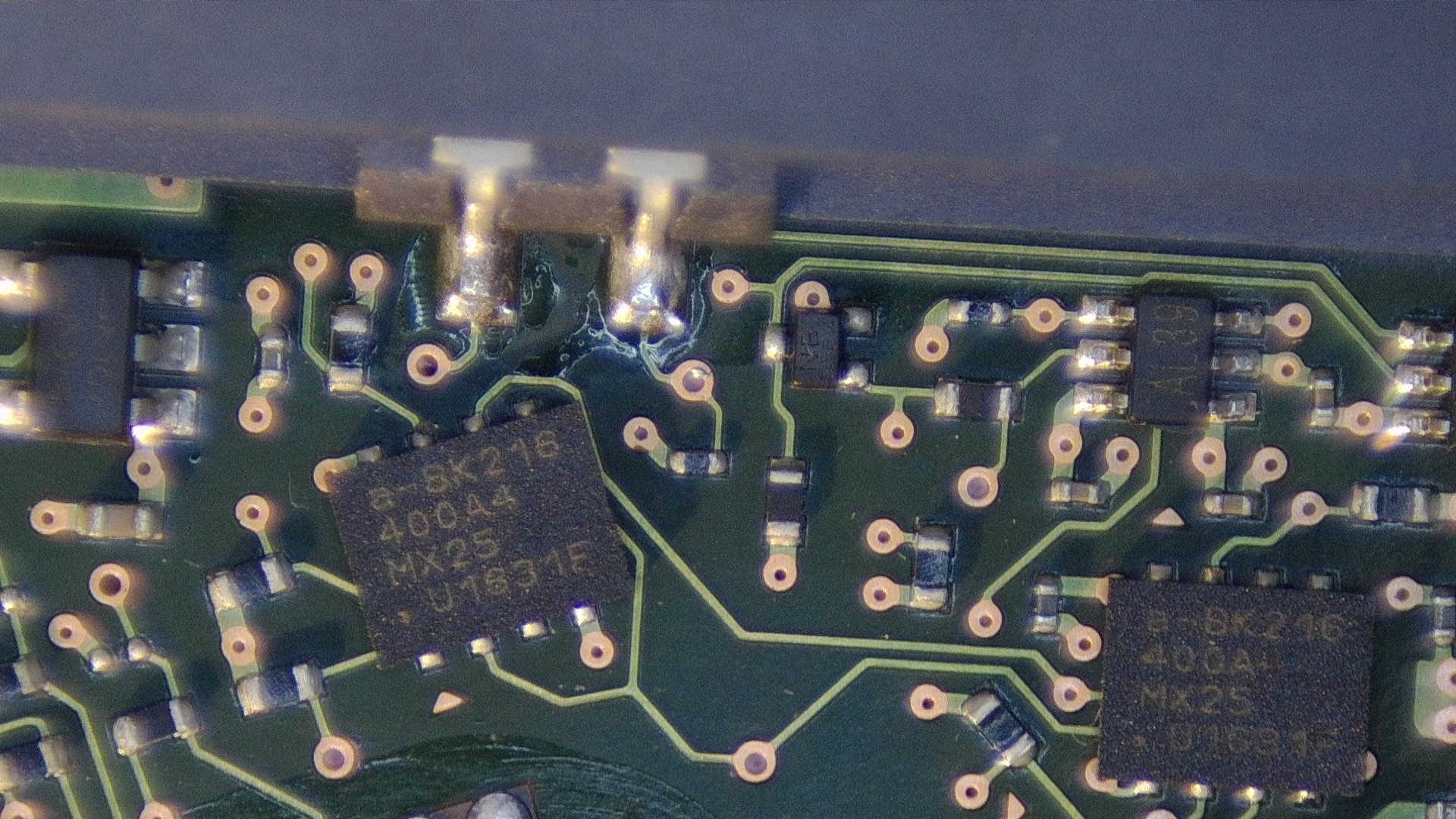

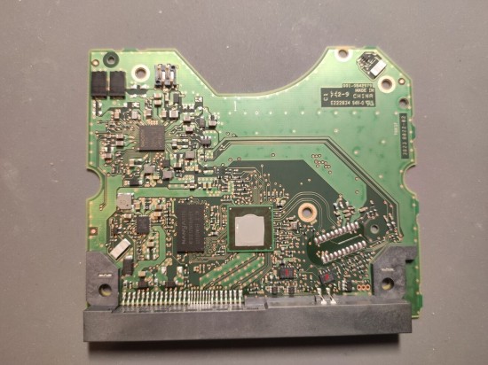

I have a non spinning WUS721010AL5205 and want to extract its ROM. From what I have researched so far, theses HDDs has 2 flashes but I'm not able to identify the IC (attached). Anyone know what they are?

MX25U163.... ?

pepe wrote:
MX25U163.... ?
Damn I'm stupid sometime...

Check the TVS diodes and fuses. No need to mess about with ROM swaps until you've done some basic troubleshooting.
There are two additional e-fuses in this IC:
https://www.hddoracle.com/viewtopic.php?p=22339#p22339
