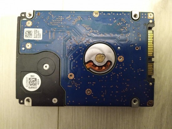

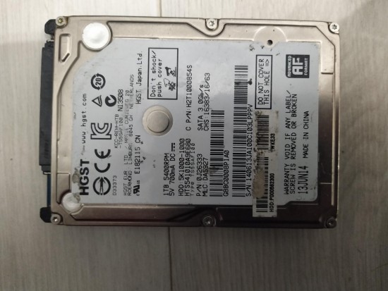

After trying to install w7 I was greeted with wierd noises from the HDD. It hanged the installer too.
So I tried to LLF using the llf tool from here. At first everything was going smoothly until it got to around LBA 10,000,000 and it started doing the weird head noises. Smart only shows around 500 bad sectors.
My first thought was one of the heads was stuck to the platter, but that doesn't make much sense (to me).
I guess its gonna be a screwed sector that is damaged so badly it makes the heafs freak out.
Drive noises are here.
