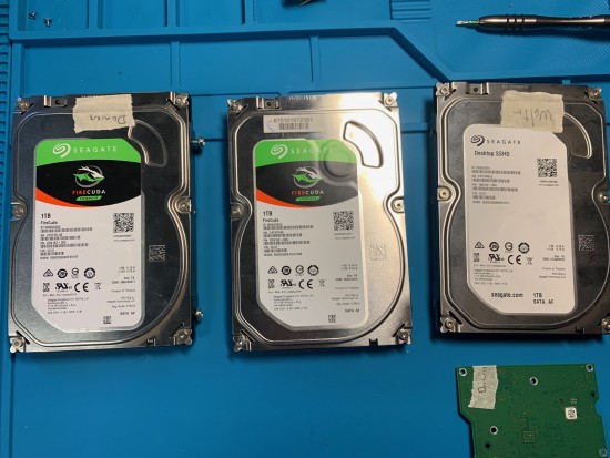

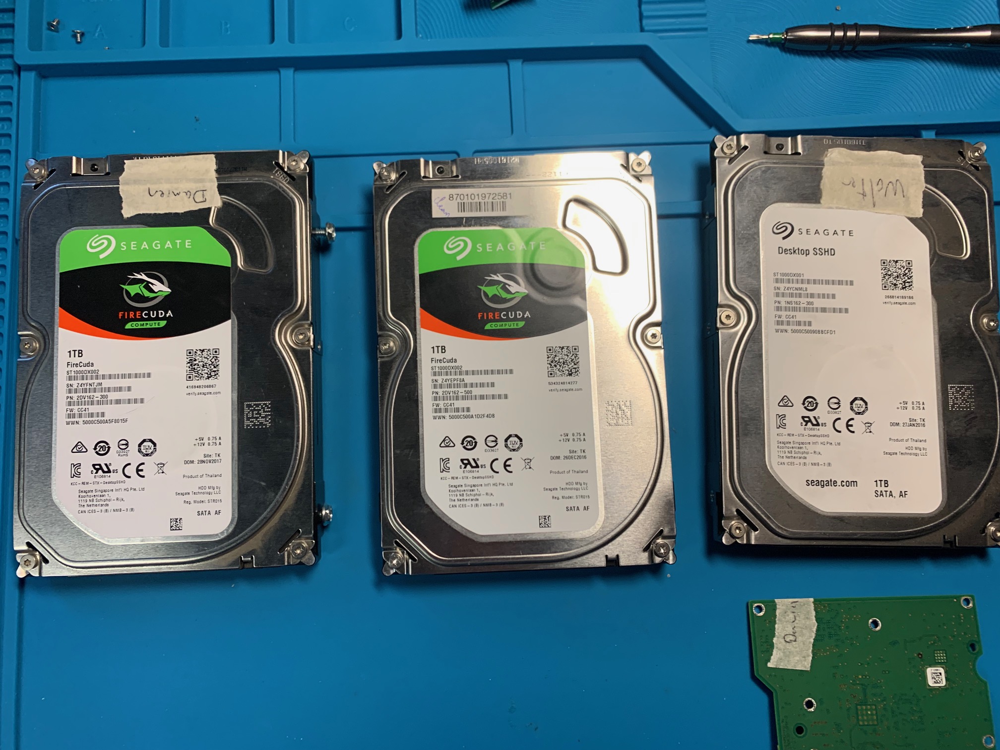

Northwind you're right I messed up since a computeur came in with a dead hard drive which has the exact same pcb and firmware and i played around with it..I'd rather be more methodical and rigorous.
If you allow me I'll keep this post as a log to remind me and hoppefully share informations with the community.
So now I have the patient drive and two donnors:

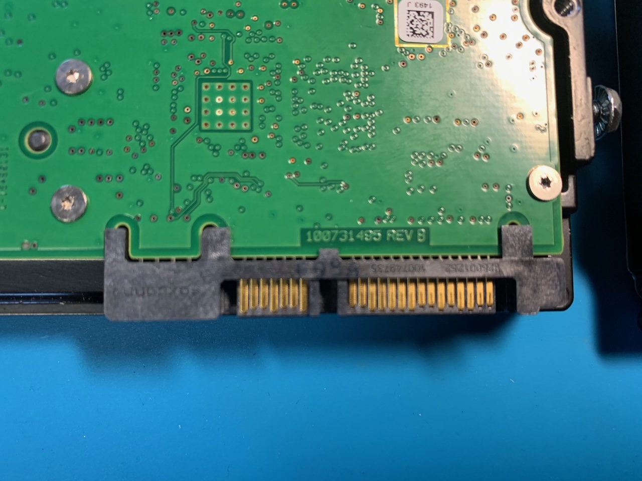

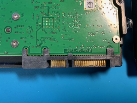

so it seems that ST1000DX002 et ST1000DX001 share the same PCB (100731495 rev B) and here they have the CC41 firmware

gurus here suggested me to repair the patient pcb, I have no schematics, I checked for the obvious devices pcb not plugged.
I picked a sata power harness yesterday and will come back with voltage measurement since I can compare boards and will update this post.
In the mean time I will source an adapter to access the pcb via serial port.
