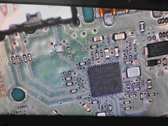

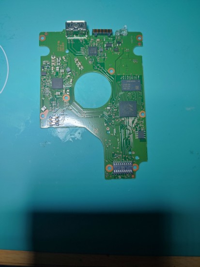

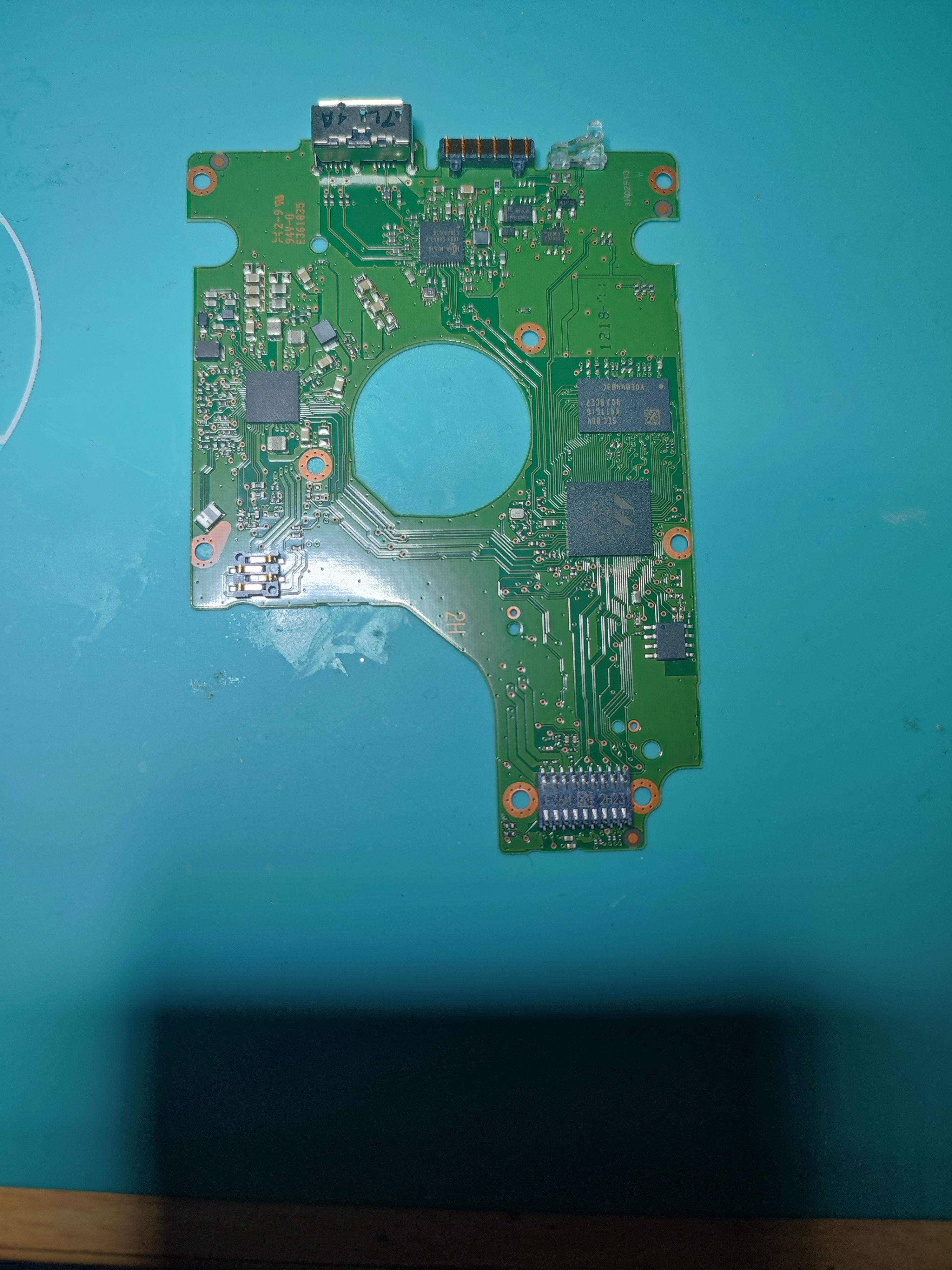

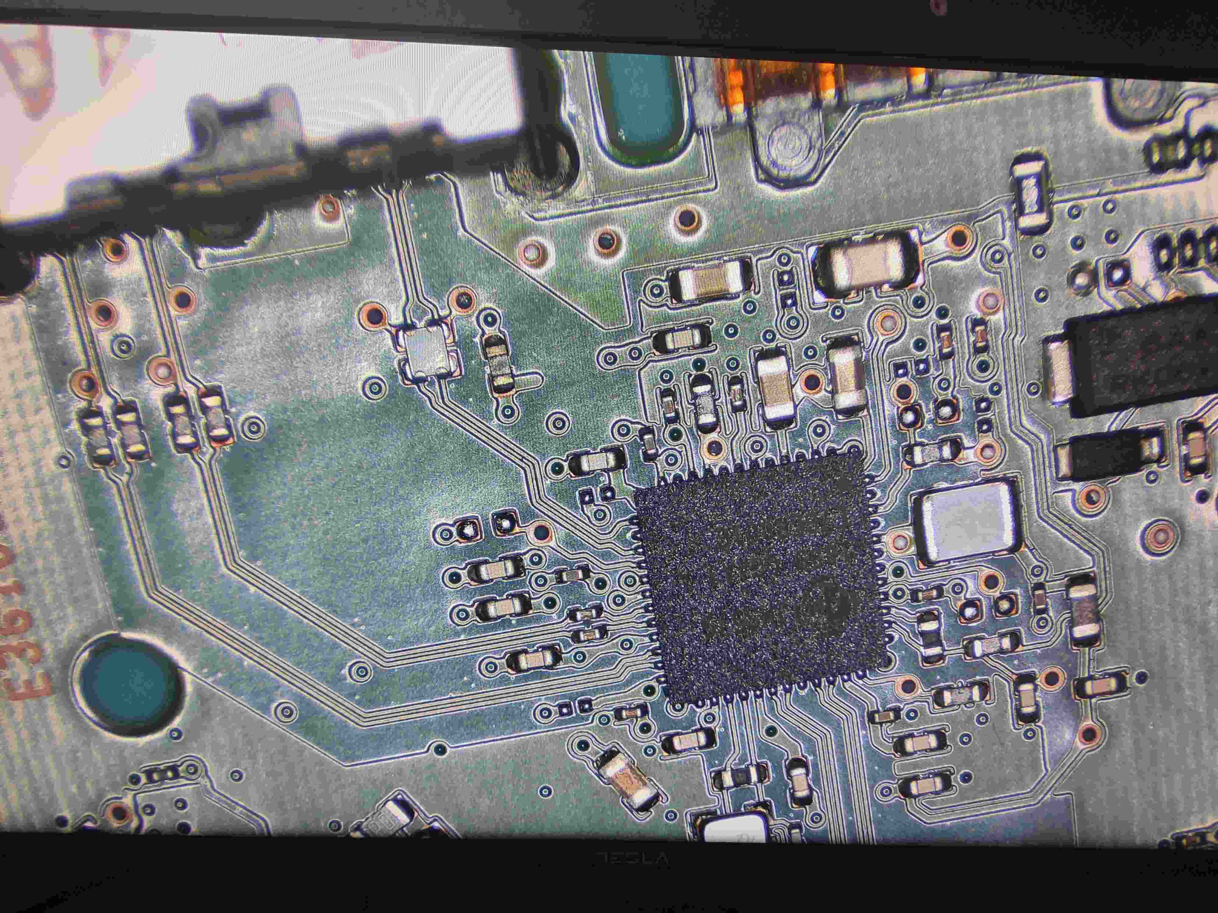

Hello, i have this pcb where i have to unsolder the capacitors and put the adapter.
Can you indicate at the photos attached?
Thank you

Posts: 1323
https://www.blizzarddr.com/convert-wd-usb-to-sata/

Posts: 17336
Which adapter are you intending to use?
If you have am MRT pogo pin adapter, then try this instead:
Locating the Reset* pin on USB-SATA bridge ICs:
https://www.hddoracle.com/viewtopic.php?f=59&t=3381
