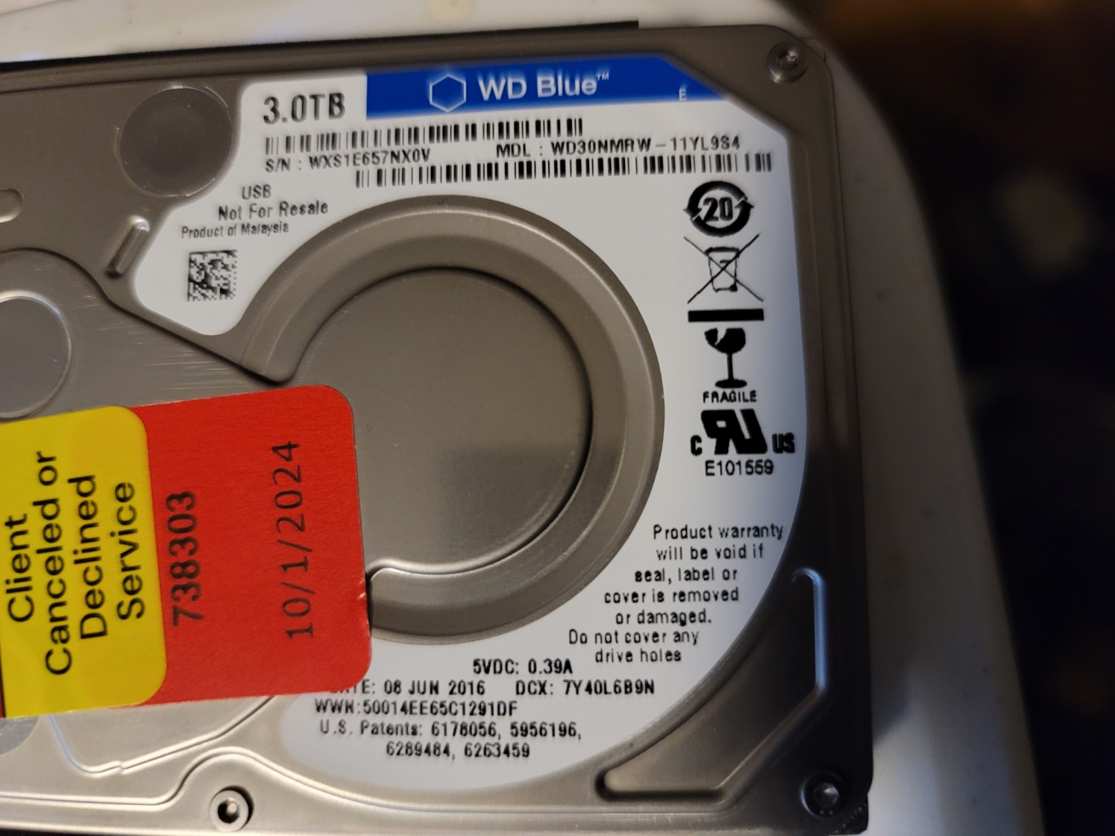

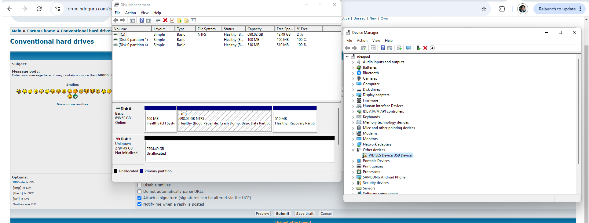

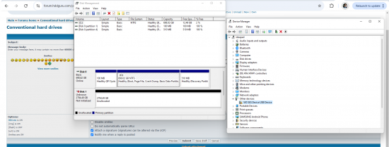

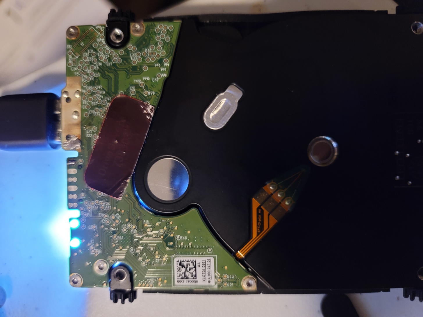

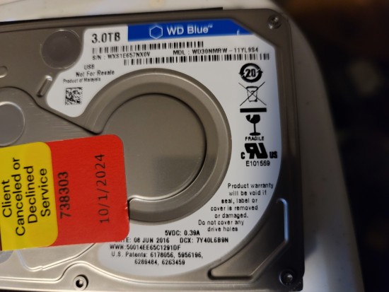

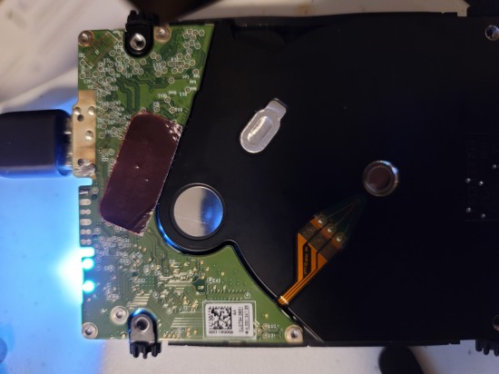

I am sorry for asking a n00bie question, but I've had 2 USED WD USB HDDs full of data come to me in this condition. Spins up fine, but it shows Unknown, Not Initialized, and Unallocated without any Drive letter assigned. It lists under "Other devices" with a yellow explanation mark on the Device Manager. Driver automatic update doesn't work.
I've tried SATA conversion following
https://www.dolphindatalab.com/how-to-c ... interface/
but it the drive isn't detected on the Device Manager.
What would be possible reasons and repair steps to follow?
TIA!
File comment: back
File comment: front
File comment: Unknown

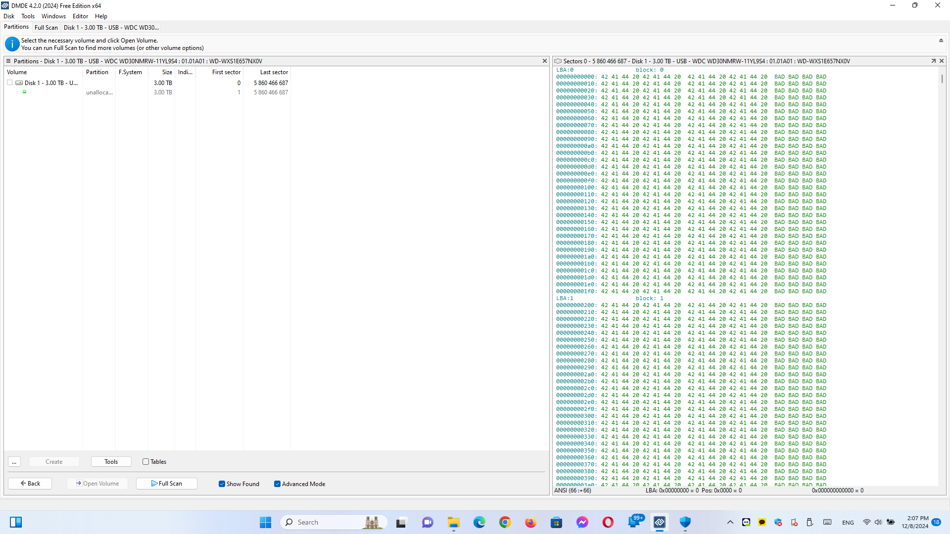

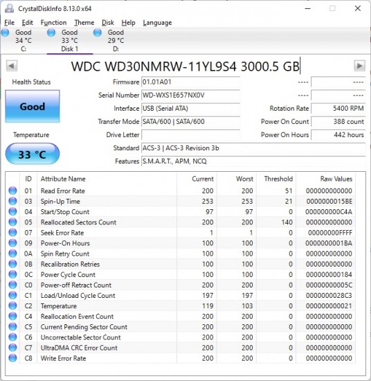

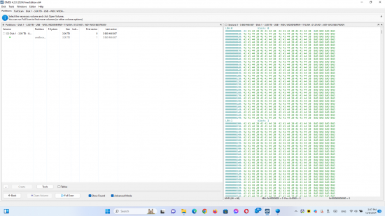

 Post subject: Re: How to recover WD HDD Unknown, Not Initialized, Unalloca
PostPosted: November 27th, 2024, 15:42
Posts: 17228
Can you show us a SMART report:
https://www.reddit.com/r/datarecoverysoftware/wiki/index/smart/
Can you show us the Partitions tab in DMDE?
https://dmde.com/
Tick the Advanced checkbox and show us what you see in the RH pane.

Isn't that a drivesavers recovery label ?

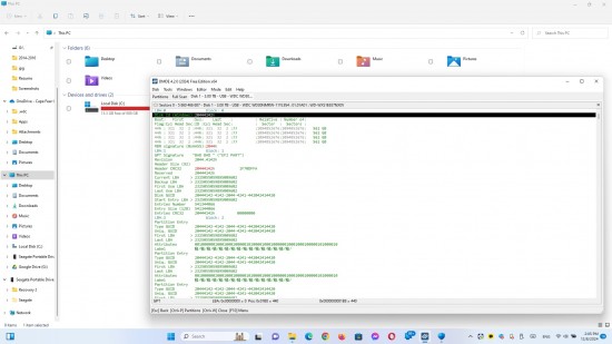

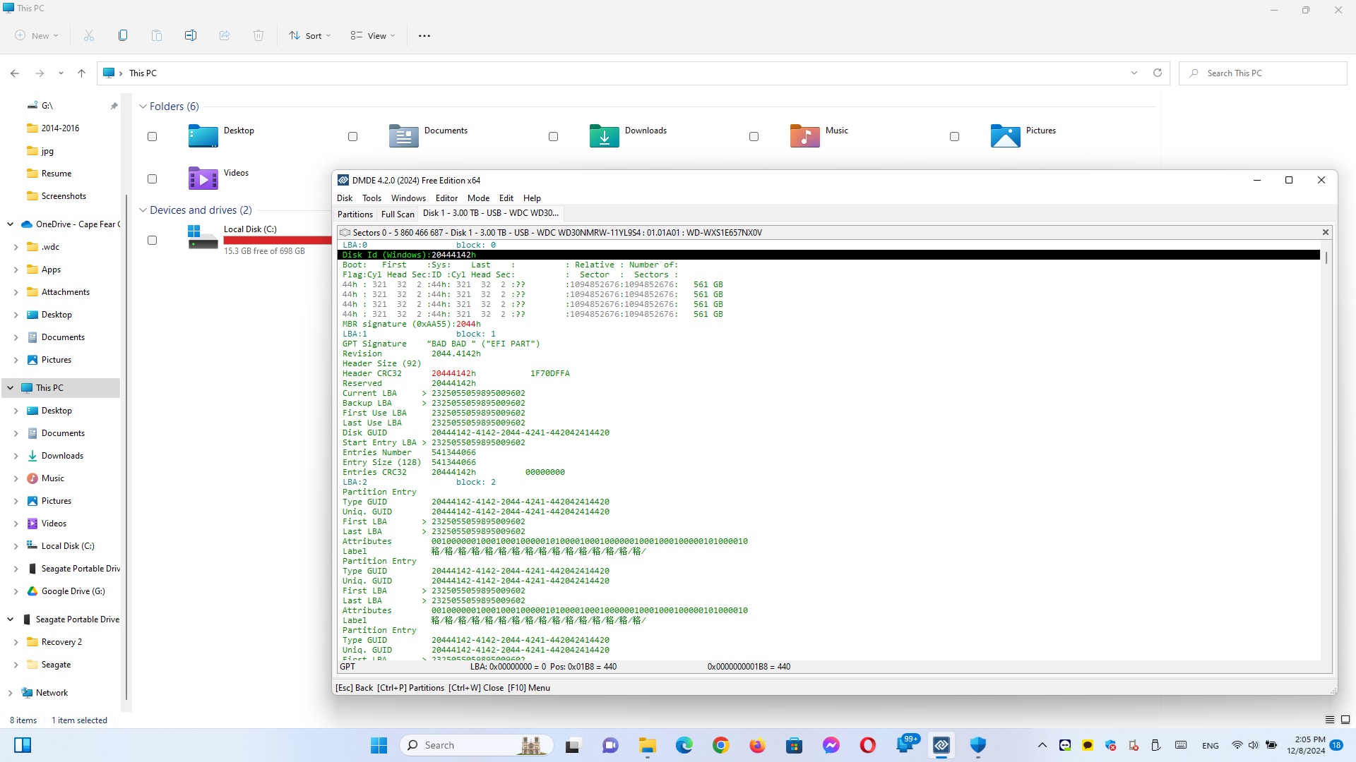

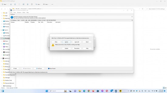

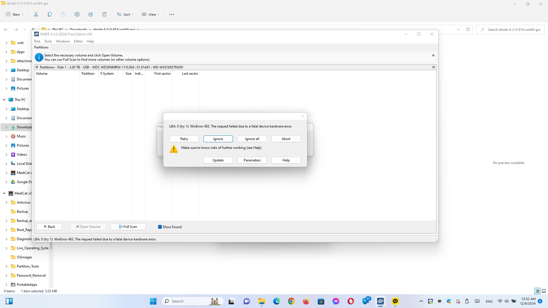

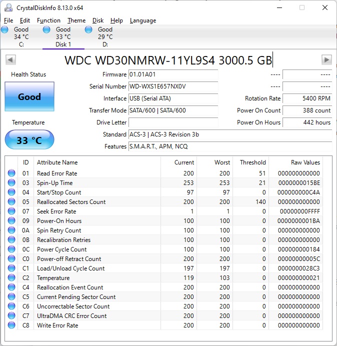

PostPosted: December 8th, 2024, 15:18
Joined: September 18th, 2024, 9:29
Posts: 11
https://dmde.com/
I finally got to doing it. Please let me know!
