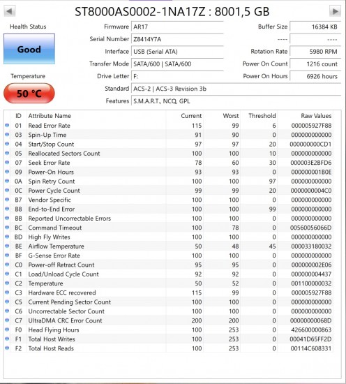

Here attached you have the SMART report screenshot. Regarding the chipsets, I have to investigate. I’ll post it asap.

That drive doesn't have any reallocated, pending or uncorrectable sectors. However, there are 1645 (= 0x66D) command timeouts and 86 (=0x56) sectors which required more than 7 seconds to read.
If you decide to ignore cloning advice, at least configure DMDE to use SCSI protocol and increase read time-out to 10 secs or so, then see if you still get MFT read errors.
