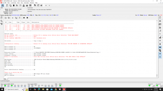

I have an external WD drive with USB connection that got dropped.
I already changed the heads, checked the platters, unlocked PCB and soldered SATA connection to the drive
I tried uploading LDR but
I cannot upload Module 2, cannot reach SA or data. Can anyone help me with this case?? Many thanks!

See if you can get heads to read SA. Try them individually and try blocking all the options to firmware. Maybe a bit too technical for a beginner.
Well you are right, a little elaboration would be very helpful, thanks!
