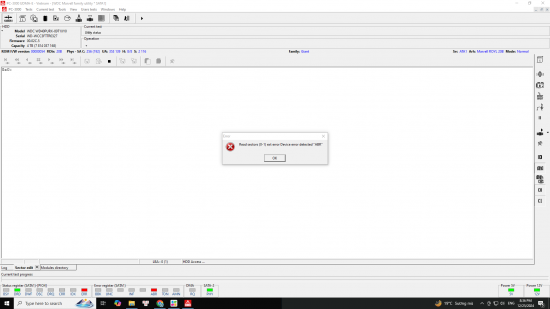

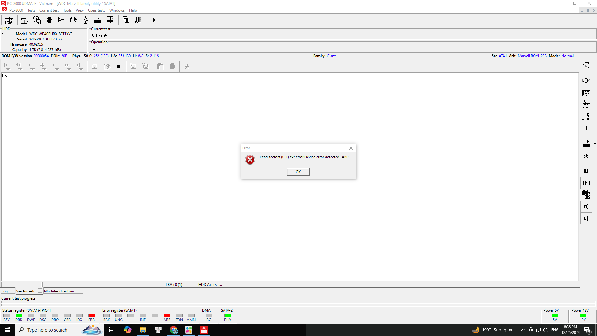

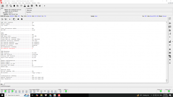

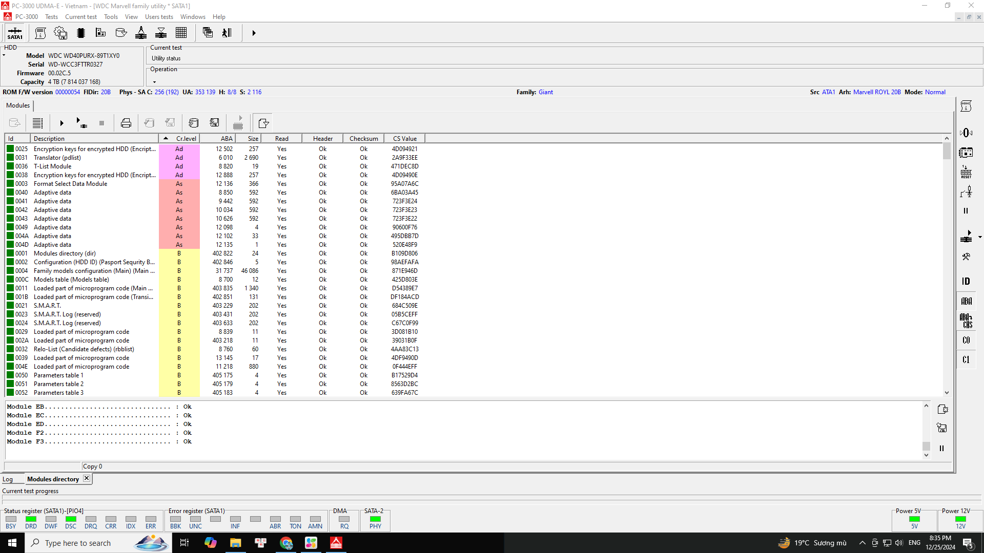

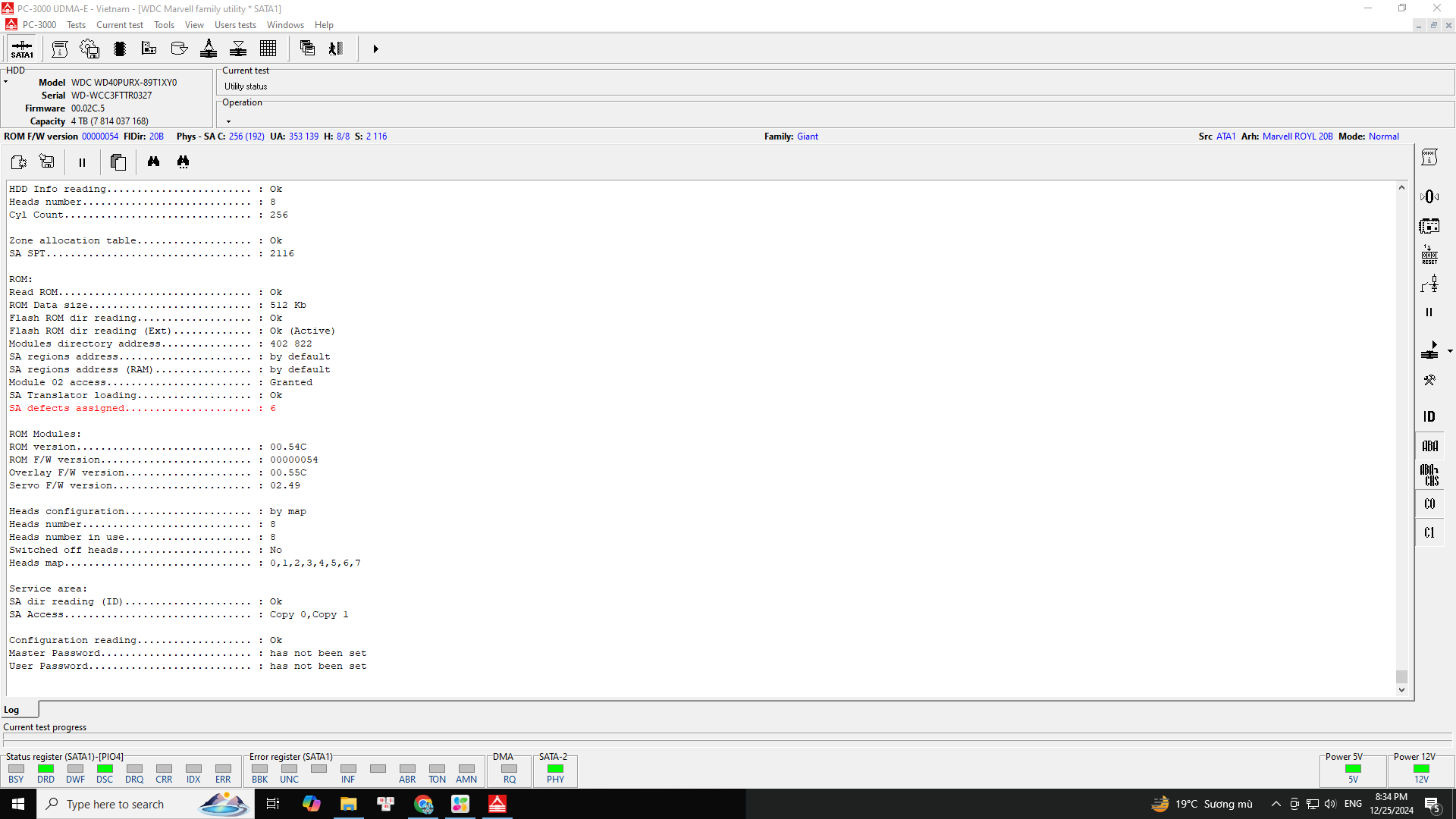

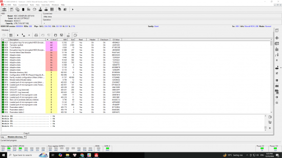

Hi everyone. I need some help with this drive
4TB Purple WD40PURX. Got full ID and modules. However cannot read the data!
Many Thanks!

 Post subject: Re: WD40PURX Full ID but cannot access data
PostPosted: December 25th, 2024, 14:26
Posts: 17336
Password protected?
DVR security?
PostPosted: January 1st, 2025, 13:40
Posts: 1748
All sectors shows ABRT means a critical error in some important module/s in FW and/or defective head/s.
