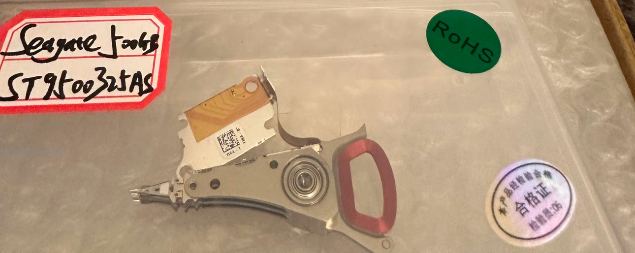

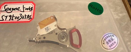

I want to replace the damaged read/write heads. Unfortunately, I couldn't find an identical donor drive. However, I came across a seller who sells individual read/write heads.
I sent him pictures of my hard drive, and he confirmed that he has the heads in stock.
After placing the order, I requested photos of the product and noticed slight differences between the original heads from my drive and the ones I purchased.
When I reached out to the seller, he assured me that the heads would work fine and that the minor differences don’t matter.
I kindly ask for clarification from those with expertise:
Will the heads work without requiring any software intervention or firmware modification?
Is there any reliable website where I can check compatibility by entering the head's code?
If the heads are not compatible, could they cause data loss?
Can the heads from all ST9500325AS models be swapped without issues?
Below are the photos for reference:
Original Magnetic Heads
File comment: Original Magnetic Heads
Purchased Magnetic Heads
File comment: Purchased Magnetic Heads
Please, anyone with information, don’t hesitate to share your insights. Thank you!

Heads you bought are problably damaged already. Sliders must be separated. Unless i didn't notice that there's something between. Also if you don't know what preamp your heads had, there's a little chance that you'll get proper ones.
Yes, I noticed that the heads were not separated, so I asked the seller about it. He told me that the heads are completely new and have a type of adhesive keeping them attached, which leaves no residue on the heads. He also mentioned that if they were separated before shipping, they would most likely get damaged during transport. Therefore, it’s up to the buyer to separate them directly before installation.
I’m not entirely sure if this is true, but I thought that if he wanted to scam me, adding a separator would make the claim more believable that the heads are in good condition. Additionally, I found some positive reviews about him.
What I want to know is, if I test the heads and they turn out to be incompatible, what will happen?
Especially since the connector to the PCB is identical, and the overall design is nearly the same.
Is there any risk of data loss, or will the heads simply not move if they’re incompatible?
And if I manage to find perfectly matching heads, will they require any calibration?
 Post subject: Re: Replacing the heads of a Seagate Momentus 5400.6
PostPosted: January 5th, 2025, 13:09
Posts: 357
If heads are incompatible they would click. Also when there's media damage. We don't know why do you want to change heads, what happended to the drive etc.
Got no idea why would anyone sell just heads. Never saw it before. We always but complete drives. Then check preamp version and this way get the donors. You don't know that preamp do you have. No info about bought heads preamp too.
Why do you want to do it by yourself? Any skills, tools, hardware and software or experience?

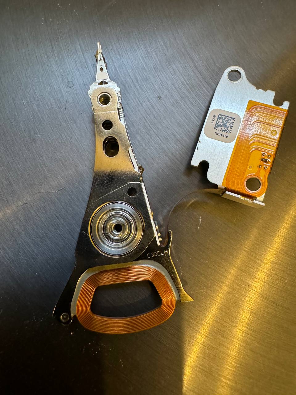

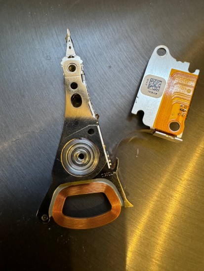

The hard drive suffered a severe fall, which caused the cover to dent inward. Upon opening the drive, I found that the dent in the cover had pressed against the arms of the read/write heads, causing them to bend slightly and preventing them from accessing the platters.
Interestingly, there was some dust on the surface of the first platter, even though the drive had never been opened before. This might have been due to the fall, allowing dust to enter through the filter area of the drive.
As for the tools:
I built a laminar flow box with an H13 HEPA filter and small openings for hands. I also have some tools, such as magnetic head combs, appropriate screwdrivers, anti-static gloves, and other necessary items.
For recovery, I will only use Linux-based recovery tools.
I want to handle this myself for trust-related reasons.
How can I find information about the preamp?
I have the numbers engraved on the read/write heads—would they help?
Any advice that could make a difference would be greatly appreciated.

Preamp version is in ROM. You can read it with terminal. How do you plan to get rid of the dust?
Don't you think that the whole operation without any experience is doomed to failure? At least buy the same model, remove heads, put them back and see how good you are.

TIBA vs TICB. Not the precise match I look for, but if you don't care enough about your data to have a pro do the job, go for it. Just remember that the more you do, the less likely a pro will be able to help after.
