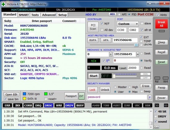

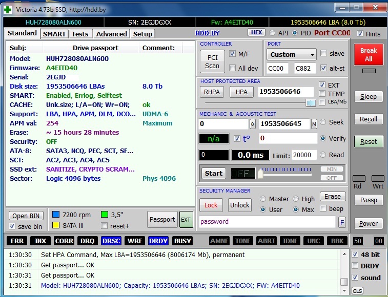

hi
please, what is this problem
i have 8tb hitachi sata, showing the capacity of 1tb.
thanks
 Post subject: Re: HITACHI 8TB /T1B
PostPosted: January 7th, 2025, 19:20
Posts: 4854
it shows 8TB. Sector size is 4k, which probably confused you, didn't it?
