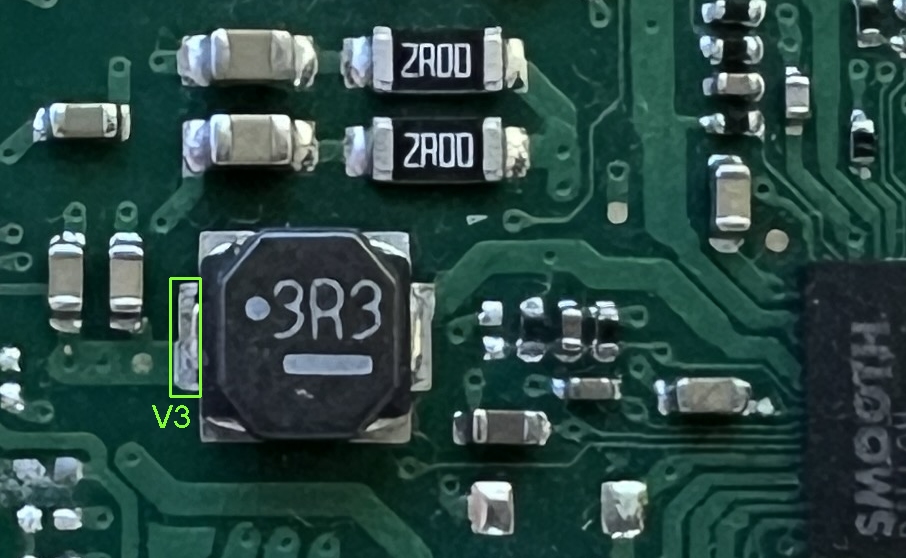

I've removed the 5v TVS diode and confirmed that it was shorted. When I supply 12v to the board from my bench supply via a SATA power connector I get 12v across the 12v TVS diode - so I'm assuming that my problem is completely on the 5v side.
When I feed 5v onto the 5v rail on the SATA power connector I'm measuring 5v on one side of the zero ohm resistors, but only 0.17v on the "downstream" side - so looks like the zero ohm resistors are close to being open circuit.
When I bypass them by shorting from pins 7/8/9 to what's supposed to be the +5v pad of the (now removed) TVS diode the board still doesn't draw any current.
I've also tried injecting 5v onto what I believe are "downstream" parts of the 5v rail but still no current draw (and at this point I'm struggling to understand where tracks lead to).
Photo of the board can be found at: https://pbase.com/cjsouthern/image/1751 ... iginal.jpg (this is the full resolution version -- it's too big for the 1024px limit of image tags)
Any further thoughts?

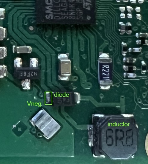

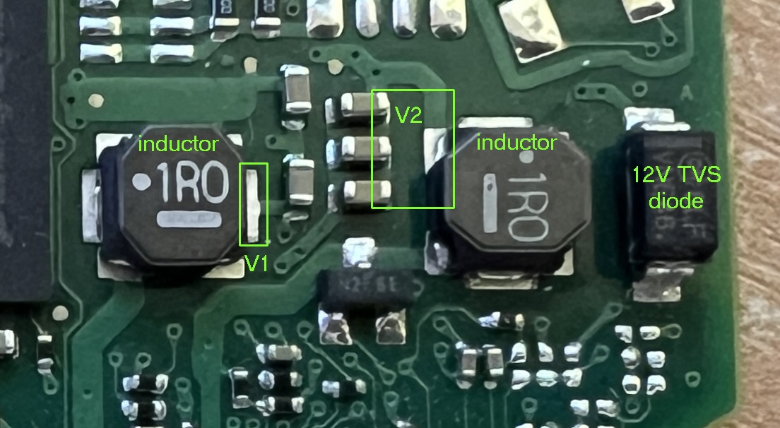

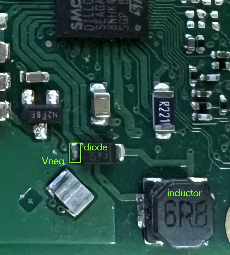

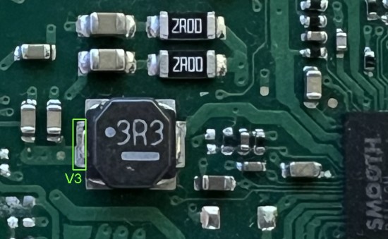

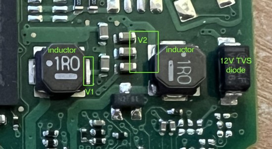

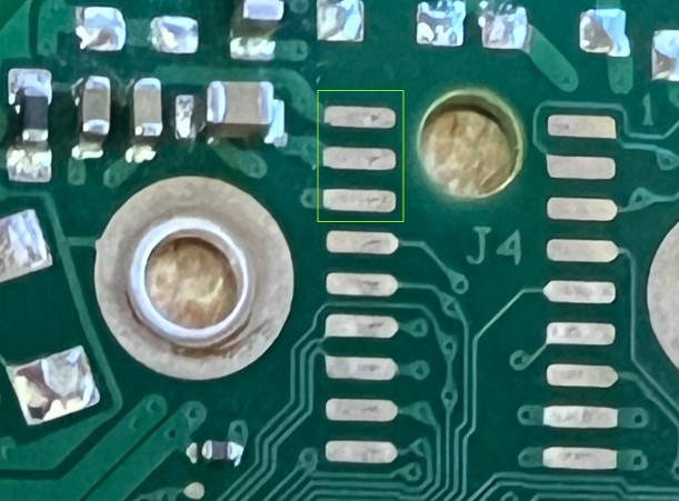

Measure the resistance between ground (any screw hole) and V1, V2, V3, Vneg. If no test point is shorted, then measure the voltages at these points.
No shorts.
I've applied 5v across where the previously installed 5v TVS diode was because the zero ohm resistors are open circuit. I'm not supplying 12v anywhere.
Voltages are as follows:
V1: 1mV
V2: 3mV
V3: 0mV
Vneg: 0mV

Did you test the zero-ohm resistors near the 5V TVS diode? I expect you'll find that they are open.
 Post subject: Re: 2x Dead Seagate Drives - Advice on Path Forward Please
PostPosted: January 14th, 2025, 14:38
Joined: January 6th, 2025, 15:38
Posts: 11
Location: New Zealand
Yes - and they are open - but unless I'm mistaken, they sit between the SATA power connector 5v input and a common rail that the TVS diode is normally connected to; hence the reason I injected 5v directly to that common rail to bypass them since I have no way of replacing them until my hot air soldering iron arrives.
But even after doing that (and verifying that the voltage was now indeed present at the 5v rail), I still essentially had 0v at those 4 points you asked me to measure - so in the absence of a circuit diagram, I'm assuming that there's some other series component that feeds the downstream sub-circuits on the 5v rail that's open circuit ... but I can't figure out what.

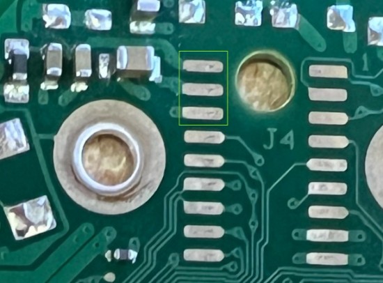

Before you waste money and time on a replacement PCB, you need to confirm that the preamp IC on the headstack (inside the drive) isn't shorted.
The 3 pins in the attachment should be connected to Vneg, +5Vin, Ground. Use your DMM to identify which is which, and then test for shorts to ground at the corresponding pins on the HDA connector.
I just measured the resistance of all 3 with my DMM using one of the metal screw holes on the drive. The first 2 appeared to have some kind of capacitance; the meter reading was in the megaohms and climbed higher and higher. the 3rd pin showed about 0.3 ohms. So from what you said, that sounds about right?
