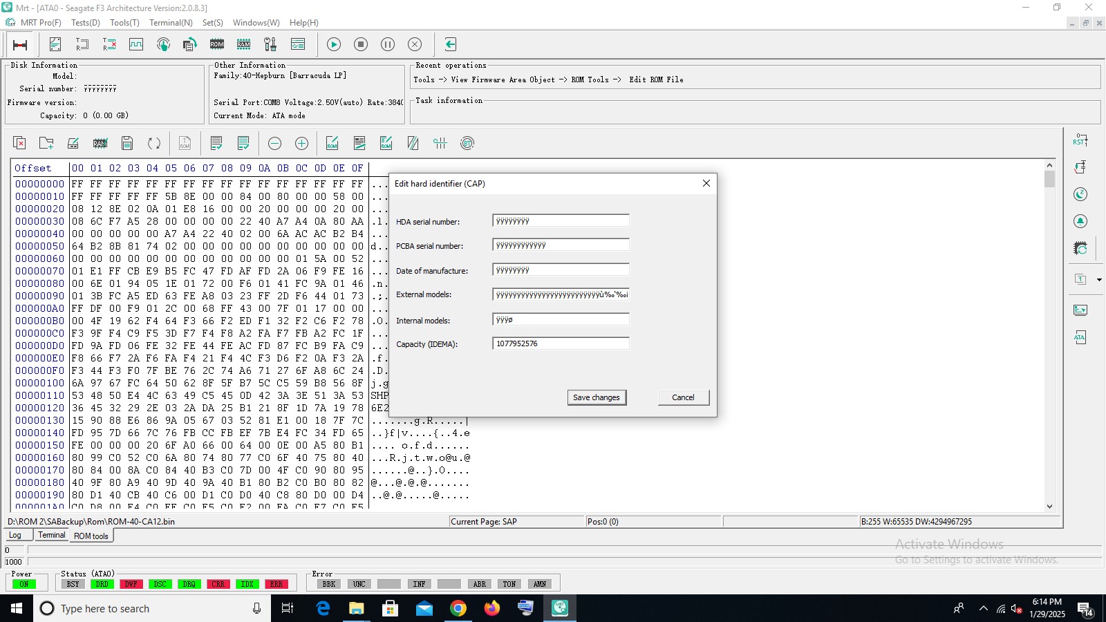

Data recovery experts can help me in this case. When i wright this rom the pcb power off.
I have a backup of the firmware of this hard disk. Are there problems in the structure of this rom?
Rom.rar [439.9 KiB]
Downloaded 178 times
The ROM is badly corrupt. Hopefully you still have the original flash memory IC, otherwise you have trashed your client's data. The patient ROM chip must have been OK for you to have backed up the SA.
This is what I get if I rotate the CAP segment by 2 bits to the right:

This means that you are using some crappy probes or crappy programmer or wrong voltage or wrong technique.
