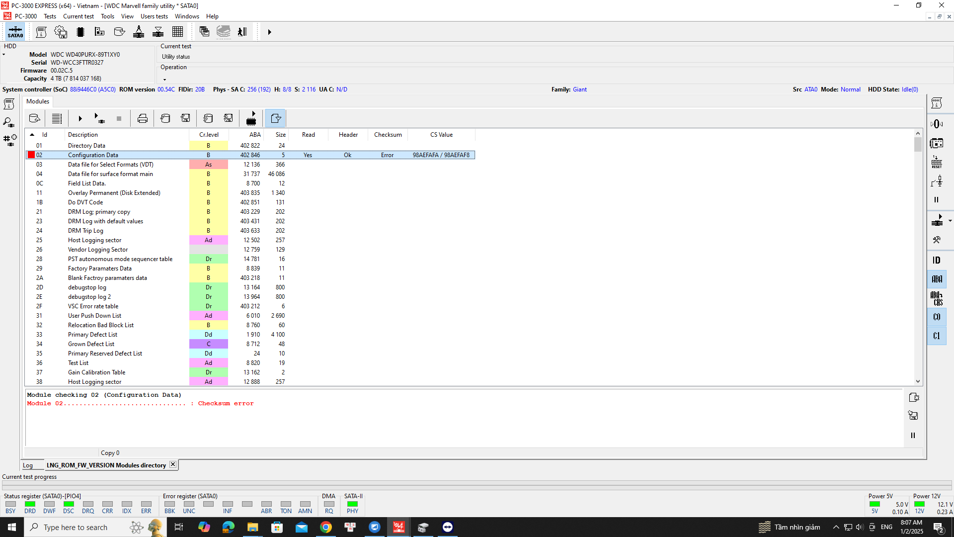

Hi everyone. Need your help with this case. The drive readies, full access to SA and can read and write to SA normally. However have the Module 02 checksum error. And wont let me access to user Sector

I have tried uploading LDR + Module 2 from different donors. Still have no access to data. Module 2 still has Checksum error
Thanks for the help!

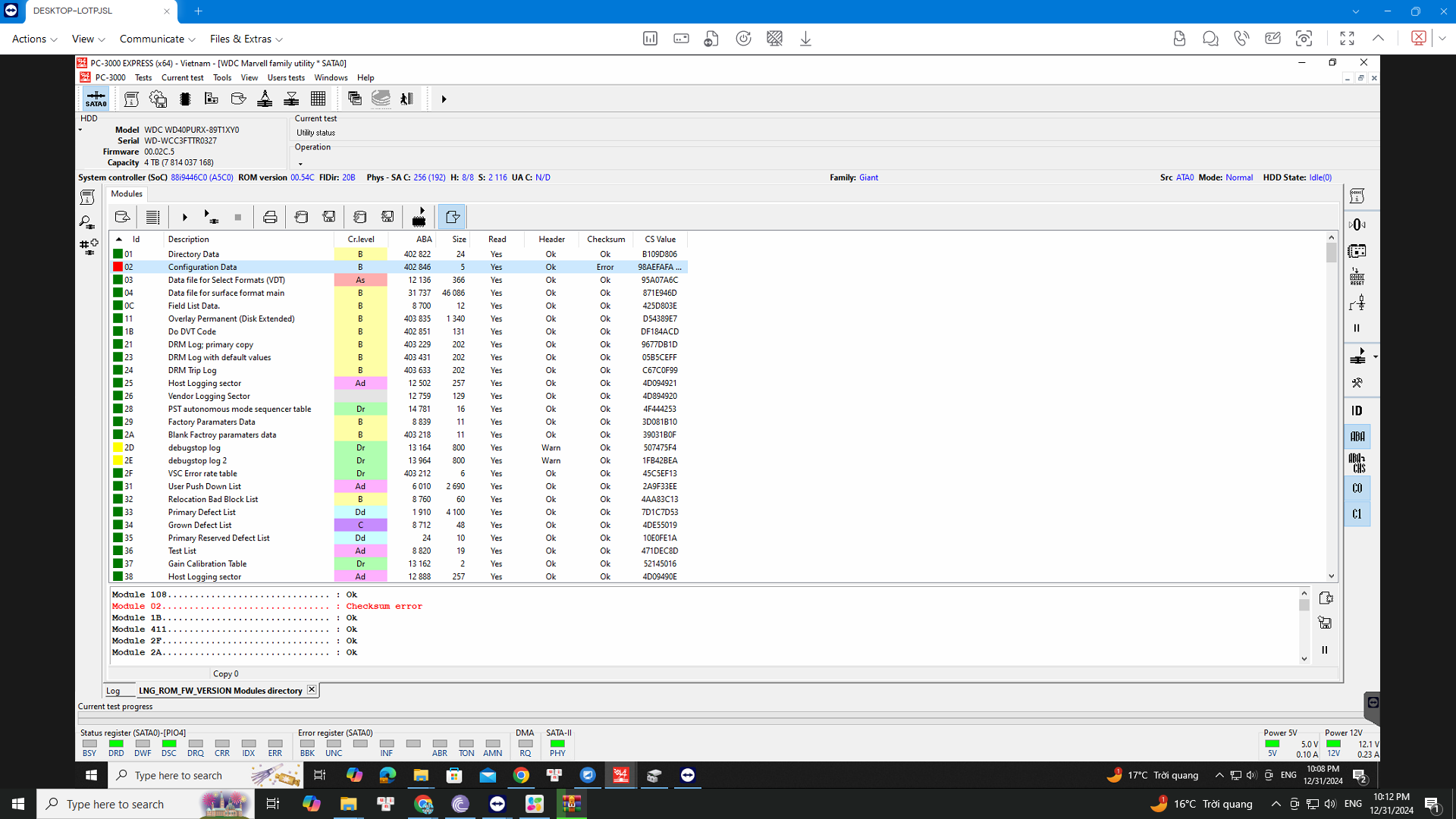

Your screenshot shows a CS of 0x98AEFAFA whereas your modules report 0x94AEECFA. That's a difference of 0x04000E00.
00000000  52 4F 59 4C 01 00 30 00 02 00 05 00 FA EC AE 94  ROYL............
00000010  30 30 30 38 30 30 30 30 07 07 07 00 00 00 00 00  00080000

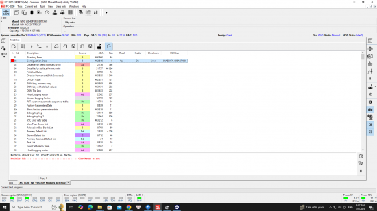

It is showing Bad checksum with every single module 02. No matter which one it is

Could there be bad SDRAM on the PCB??? Would it be worth trying a PCB swap???

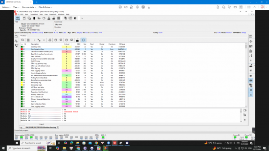

I conclude this case with no solution to this
- I have tried fixing modules. Writing, reading
- Tried swapping PCB
- Tried changing Heads
=> As Fzabkar said. This drive is totally Chinese wizardry. The Label and the ID on the side of the drive didn't match.
