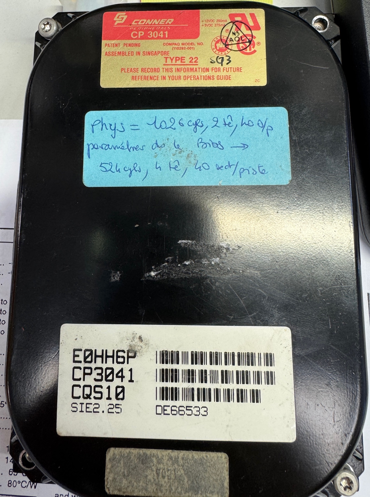

I want to save a very old HDD. It's a Conner Periphals CP3041 HDD of only 40MB It was installed in a COMPAQ Computer
https://www.redhill.net.au/d/140.php
The disk has 1 platter and 2 heads.

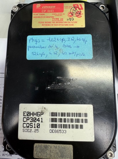

A little sticker on it claims :
Phys 1026Cyl, 2heads, 40 sectors/track
BIOS settings : 524 cyl, 4 heads, 40 sectors/track

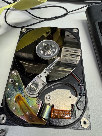

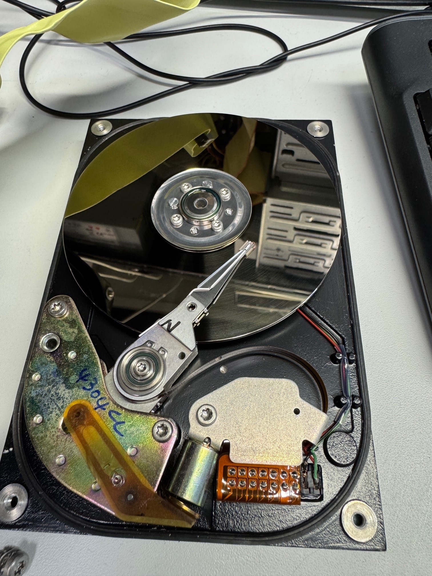

File comment: Open HDD with donor head and donor magnet

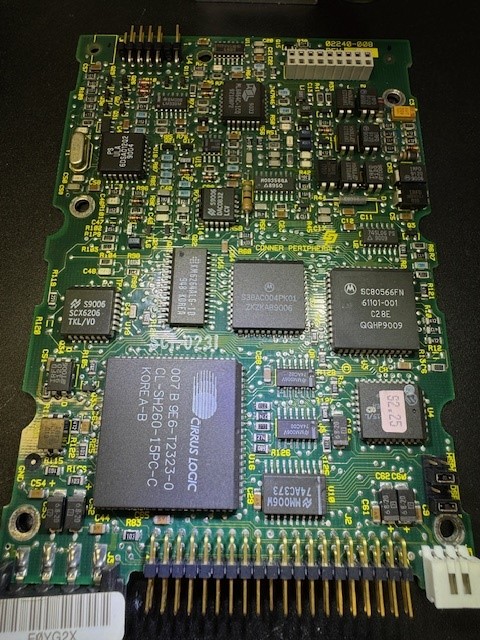

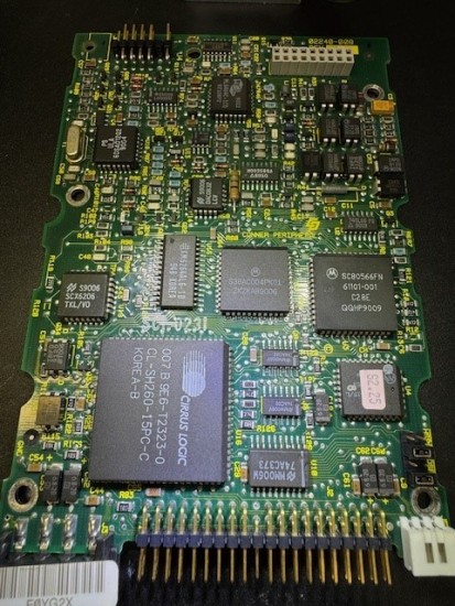

* I've tried to swap PCB. I've checked PCBs and they seems to be correct.
File comment: donor PCB but both are the same !

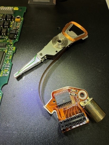

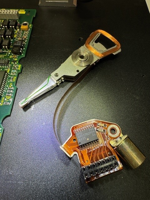

* Head is equipped with a VM117R2POM IC.
File comment: head ferromagnetic. Good coils and seems to be good
* PCB with ML8464C https://bitsavers.trailing-edge.com/pdf ... L8464C.pdf

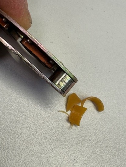

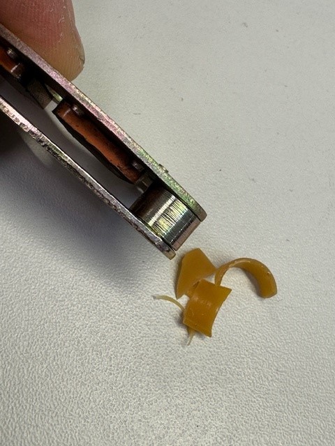

* The magnet had a rubber on a side, I know it's to avoid the head hit the side but it was inflated, on the original disk the rubber was sticky and inflated, on the second one it was yellow and very breakable. Came loose in parts.
File comment: magnet clean of the sticky rubber and the dry rubber from the other one.

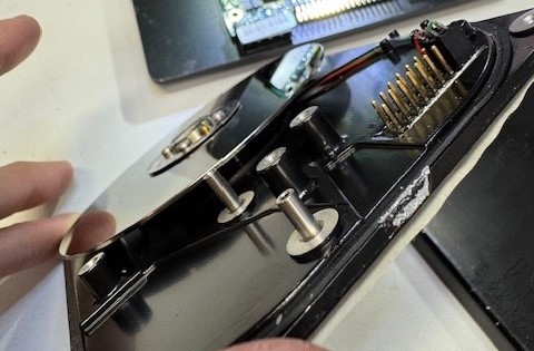

You should be working inside a dust-free "clean cabinet".
How are you keeping the two heads apart? They should not be allowed to touch each other.
Your BIOS translation parameters exceed the capacity of the drive, so I expect that your drive would reject them.
    1026 cyl x 2 heads x 40 sectors/track = 82080 sectors <-- native CHS
    524 cyl x 4 heads x 40 sectors/track = 83840 sectors <-- BIOS CHS
    5 x 255 x 63 = 80325 sectors <-- hdparm CHS

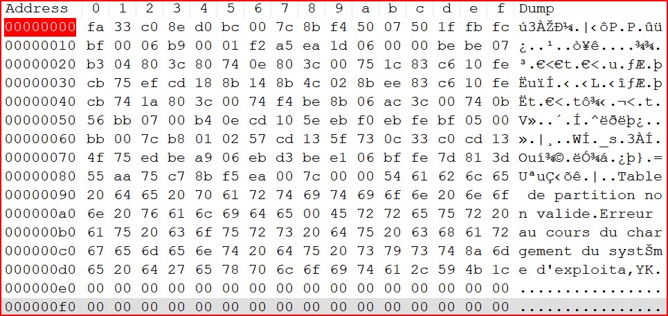

Can you show us the hexadecimal content of LBA 0 (CHS = 0/0/1)? The partition table will tell us how the drive was originally configured.

Yes, you're right. I'd better open it in a clean cabinet or grey area.
I'm wearing gloves and a white blouse when opening the disk I wanna save data.
For the moment it stays clean.
On the picture, the open one is the donor.
I don't keep heads appart on this disk.

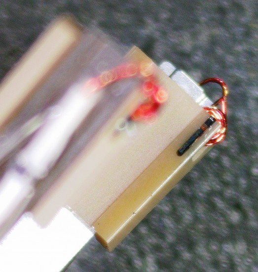

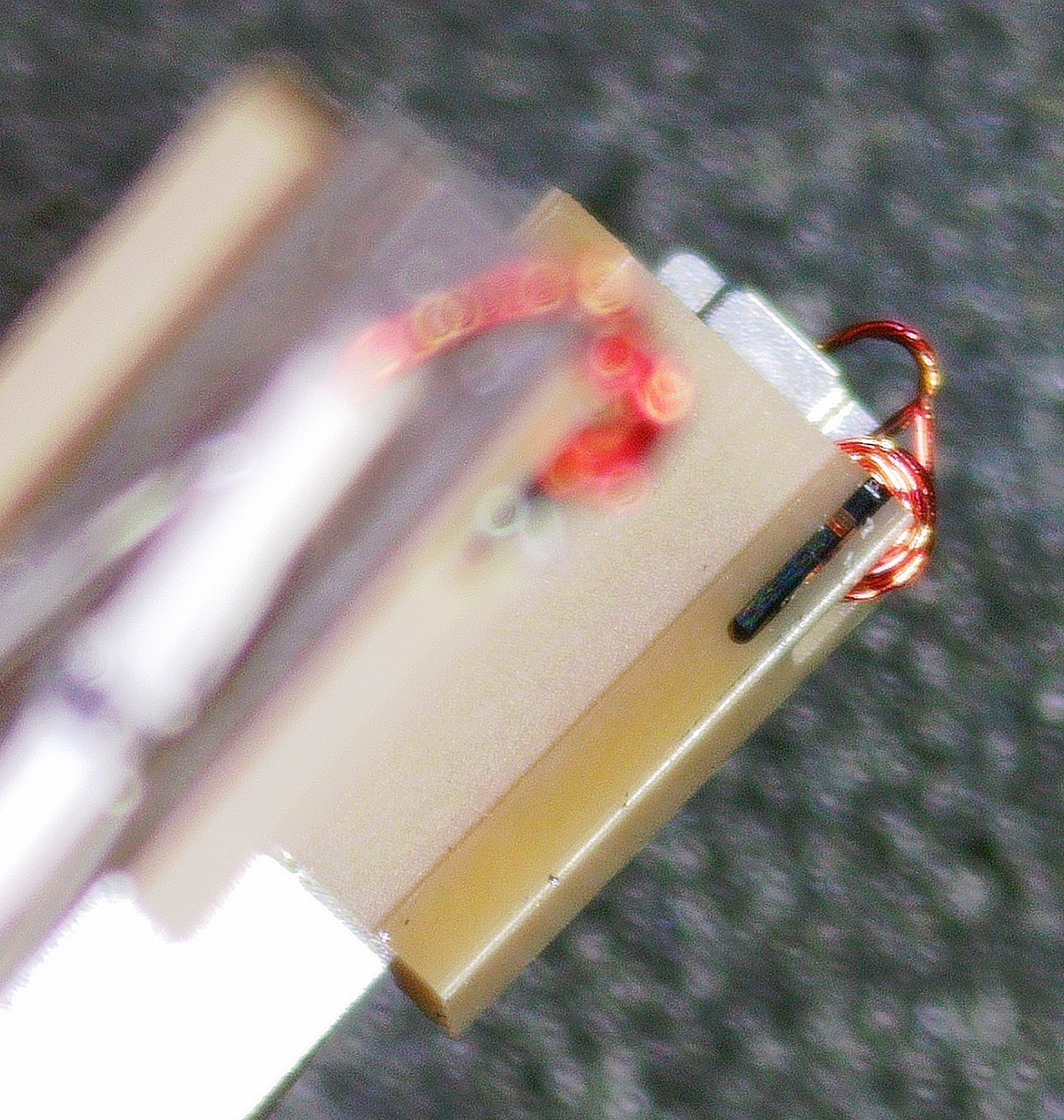

Because it's ferromagnetic heads. They are flat
File comment: Close up picture of the head

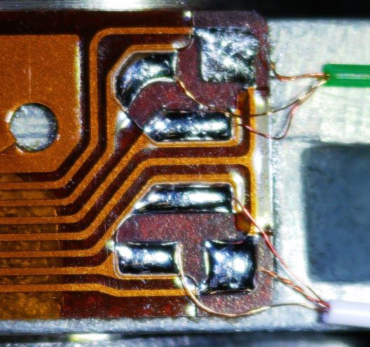

Here is a close up view of th coil connections.

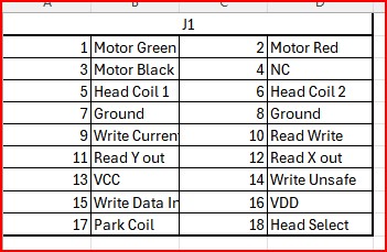

I've opened one side to measure the coil and reverse engineer the wiring on the amplifier circuit.
File comment: Coils connection

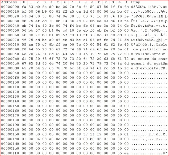

Here are the first data I've been able to save before sending the disk to a professional company !
File comment: first data

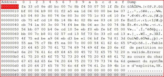

We need to see the end of the first sector. That's where the partition table lives.
https://thestarman.pcministry.com/asm/mbr/STDMBR.htm
Here is the datasheet for your preamp:
https://www.datasheetarchive.com/datasheet/VM117R2POP/VTC?id=5ffb8017d0023fd0&term=VM117
http://bitsavers.trailing-edge.com/components/microLinear/_dataBooks/1991_Micro_Linear_Semi-Standard_Analog_Data_Book.pdf (page 389)
ISTM that you could test the heads by comparing the coil resistance, and you could examine them for contamination under your microscope.

Thanks, I've found the datasheet for the amp.
And already did the schematic and measured the Head Selection Signal.
Seems to be fine...

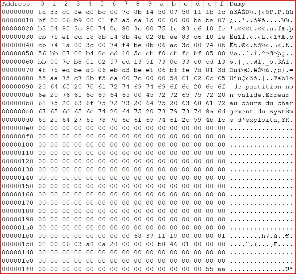

Here is the first sector, right?

 Post subject: Re: Vintage Conner Peripherals CP3041 - Help Please :)
PostPosted: January 24th, 2025, 7:26
Posts: 17341
The partition starts at CHS = 0/1/1 and ends at CHS = 522/3/40.
The capacity of the partition is 83640 sectors = (523 x 4 x 40) - 40.
Therefore the correct translation mode is 524/4/40 (1 x maintenance cylinder), which is your BIOS translation mode. This is larger than the capacity on the sticker. :-?

A picture of the HDD with the label :
PostPosted: January 24th, 2025, 8:54
Posts: 17341
This is what I get:
word #1 = 0x041D = 1053   number of cylinders
word #3 = 0x0002 = 2      number of heads
word #4 = 0x62D1 = 25297  number of unformatted bytes per track
word #5 = 0x0269 = 617    number of unformatted bytes per sector
word #6 = 0X0028 = 40     number of sectors per track
word #54                  Number of current cylinders
word #55                  Number of current heads
word #56                  Number of current sectors per track
word #57-58               Current capacity in sectors
The current translation mode is not populated.

I'm wondering how you are getting all the different translation modes when BIOS is set for 524/4/40. The drive has 1053 cylinders, but CHS can only handle a maximum of 1024 cylinders. BIOS then halves the number of cylinders and doubles the number of heads to circumvent this limitation. It then sends an ATA Initialize Drive Parameters command to the drive using these new CHS values, after which the drive changes its translation mode and reports these new parameters in words #54 - 58. I suppose that Linux can also do the same thing in those cases where a modern BIOS has no CHS support.
In short, I can't see how you can clone the first 20MB of your drive without error if either head has a problem. Instead I would expect to see stripes in your data as the drive switches between the good and bad head.
BTW, I'm not a data recovery professional, so there may be errors in my logic.
I've pluged the HDD to a more recent computer with a Linux Debian. I leave the bios adapt itself...
The BIOS Settings on the label were used for the old COMPAQ XEROX 386 computer !

Some more datas I've found :
http://matthieu.benoit.free.fr/182.htm
J1 connector from PCB to the inside of the disk to the amplifier :
I'm reversing J4, it seems to be a external access port...
Serial Communication?
PostPosted: January 24th, 2025, 11:56
Joined: January 23rd, 2025, 4:02
Posts: 13
Location: France
Datas extracted from the second disk by J4 connector !!!
I hear this splatter spinning and stopping.
I don't know why but with the other platter it spins.
Speed = 7200 bauds !!!
Sierra - S2.25
Begin test 40
Intf
Ref 20 - Xsition 20 - Full spd 083 - Spin timeout
Ref 1F - Xsition 1F - Full spd 081 - Spin timeout
Ref 1E - Xsition 27 - Full spd 07F - Data lock -................................ ................................................................................ ................................................................................ ...................................................*............................ .*.......................*...................................................... ................................................................................ ................................................................................ ................................................................................ ................................................................................ .......................................................................*........ ................................................................................ ................................................................................ ................................................................................ ..........................*..................................................... ................................................................................ .......*.........................................*............................*. ................................................................................ ................................................................................ ................................................................................ ................................................................................ ................................................................................
...............................................................................................................................................................................................................................................................................................................................................................................................................................................................................................................................................................................................................................................................................................................................................................................................................................................................................................................................................................................................................................................................................................................................................................Spin timeout
Ref 1E - Xsition 21 - Full spd 082 - Spin timeout
Ref 1E - Xsition 26 - Full spd 080 - Spin timeout
Ref 1E - Xsition 25 - Full spd 07E - Data lock -...............................................................................................................................................................................................................................................................................................*..............................................................................................................................................................................................................................................................................................................................................................................................................................................................................................................................................................................*....................................................*.................................................*...............................................................*........................................................................................................................................*............................................................................................................................................................................................................................................................................................................................................................................................................................................................................................................................................*.........................................................................................................................................................................................................................................................................................Spin down
Ref 1E - Xsition 23 - Full spd 083 - Spin timeout
Ref 1E - Xsition 21 - Full spd 083 - Spin timeout
J4
1 1 de J6 2 2 de J6
3 NC 4 NC
5 GND 6 GND
7 Pin 34 de SC80566FN=>TX 8 Pin 33 de SC80566FN => ?
9 Pin 29 de SC80566FN=>spinning frq? 10 Pin 21 de SC80566FN => ?
11 VCC +5V 12 VCC
13 VDD +12V 14 NC
PostPosted: January 24th, 2025, 13:54
Joined: April 2nd, 2024, 3:40
Posts: 167
Location: on lifes edge
Veery dumb question, but the PCB doesn't have broken components? (You've probably checked it already gazilion times) Had an film capacitor make an st2383n not initialize.
PostPosted: January 24th, 2025, 17:14
Posts: 13
Location: France
No dumb question. Yes I’ve swapped PCBs and checked components!
No failures on the electronic side
