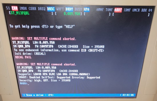

Hi, I'd be grateful for any suggestions before I bin this ST31500341AS & restore from backup.
It spins up, clicks 11 times, then spins down.
There's nothing on serial debug other than a single "ü" (0xFC / 0b11111100) immediately following power-on. No response to Ctrl-z, no echo-back. I've verified my serial setup is good with a working 7200.11 drive (750gb ST3750330AS). Same outcome with motor, heads, or both disconnected.
Drive reports as a 4gb ST_M13FQBL which I think is the default baked into the firmware. I'll try to add a reply for a jpg of the MHDD output, the forum isn't accepting it here for some reason.
Other threads similar to this suggest head failure is most likely. However many of them mention getting useful info from serial, & with mine dead I wonder if maybe it's a logic board issue and maybe even fixable if it's just a generic SMT component. Is there anything I can check in this regard? I have a scope available if need be.

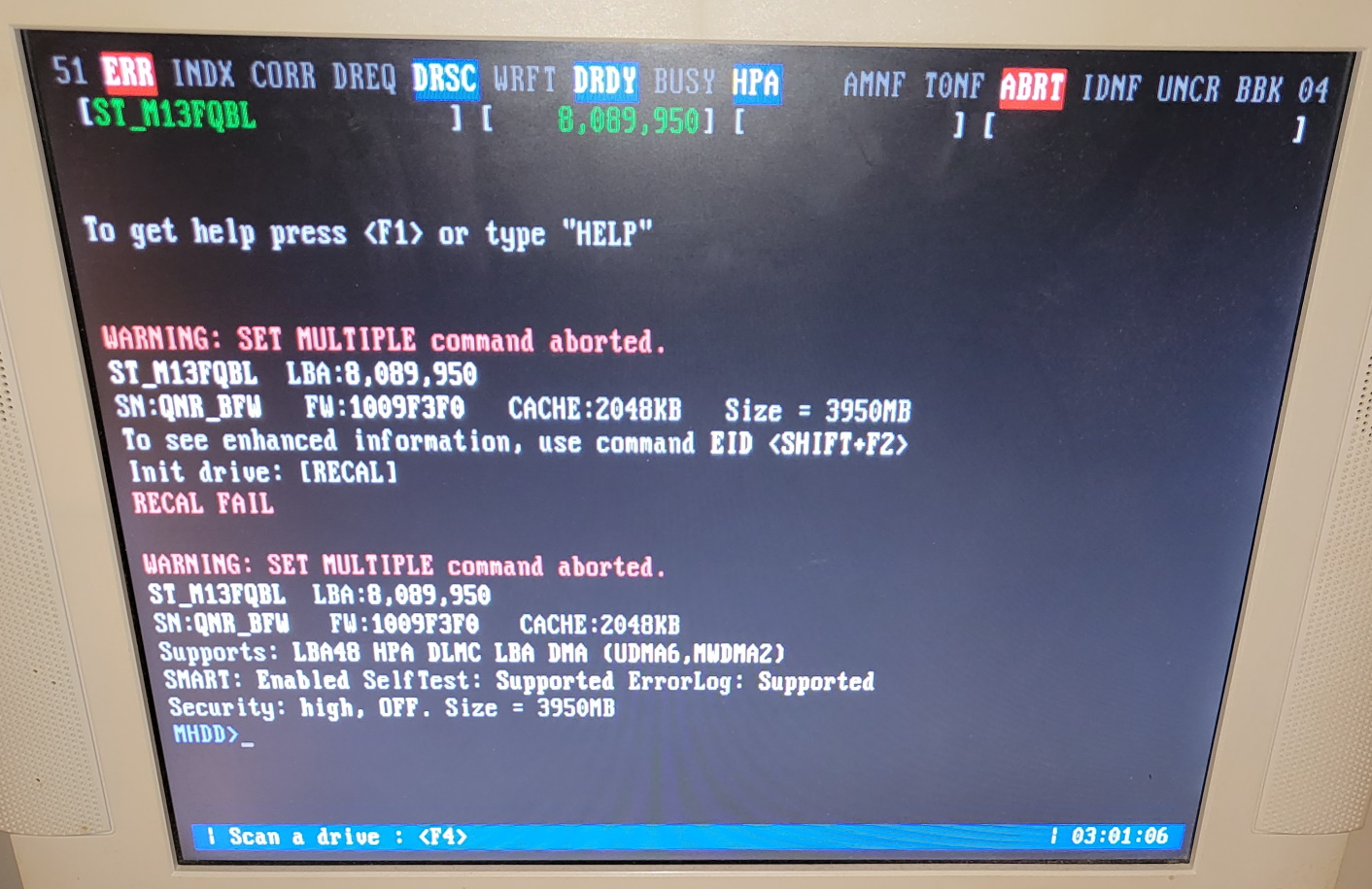

Attaching MHDD output.
File comment: MHDD output
 Post subject: Re: Seagate 7200.11 clicking with no serial debug
PostPosted: January 27th, 2025, 3:21
Posts: 4854
most likely heads (and maybe surfaces) are bad. Drive cannot load controller fw.

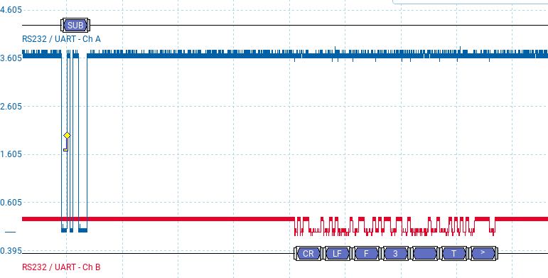

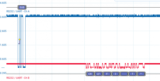

I checked the terminal levels using a scope & that may well be the issue. Here's the output a ctrl-z on the good drive whose terminal access works:
The drive's Rx (Channel A) looks fine, I thought the idle level of "1" seemed odd but apparently that's correct for UART serial.
The Tx channel though is ... odd. It's a fraction of the Rx one, even though my scope and interface were able to make sense of it.
It looks the same on the bad drive except that the Tx doesn't change following the ctrl-z.
The interface (MAX232 based) is on a protoboard so I'll re-do it based on one of the diagrams linked elsewhere on the forum. Or perhaps I'll just buy a new simpler one...is there a go-to USB one that is well regarded?
(The "ü" I was seeing on power-on is probably just noise as it's seen simultaneously on the input as well, 0xFC just so happens to be 0b11111100, so not difficult to fluke that with a two-tick drop to 0v)
